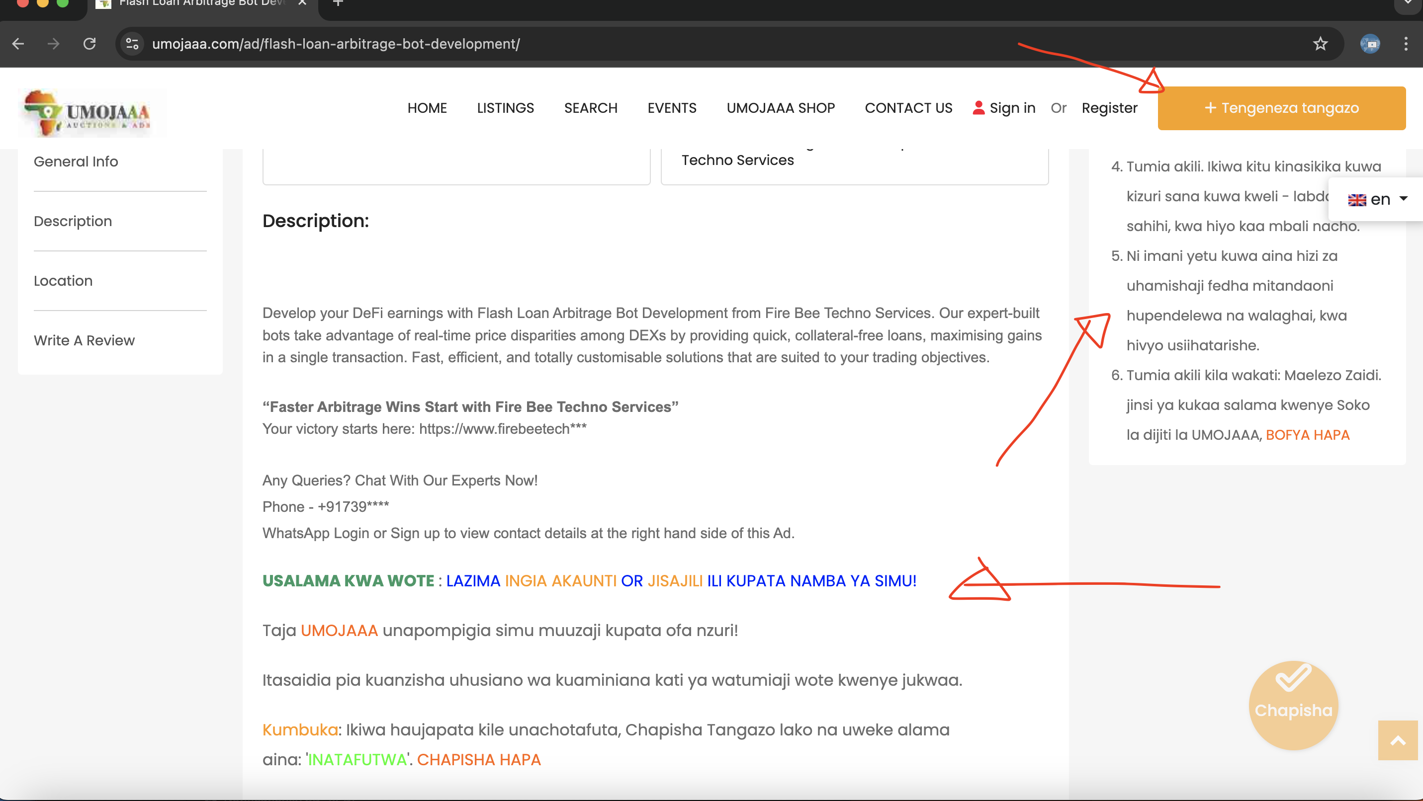

I am trying to ensure that the home page displays menus, widgets, and custom fields in the correct language. However, I am experiencing issues with incorrect translations. The issue can be seen on this page: hidden link
On the home page, some menus are displayed incorrectly, and widgets and custom fields are in the wrong language. Specifically, a single Ad page is in English, but all custom fields and widgets on the right-hand side and below the ad description are in Swahili.
Why are some menus, widgets, and custom fields displaying in the wrong language?

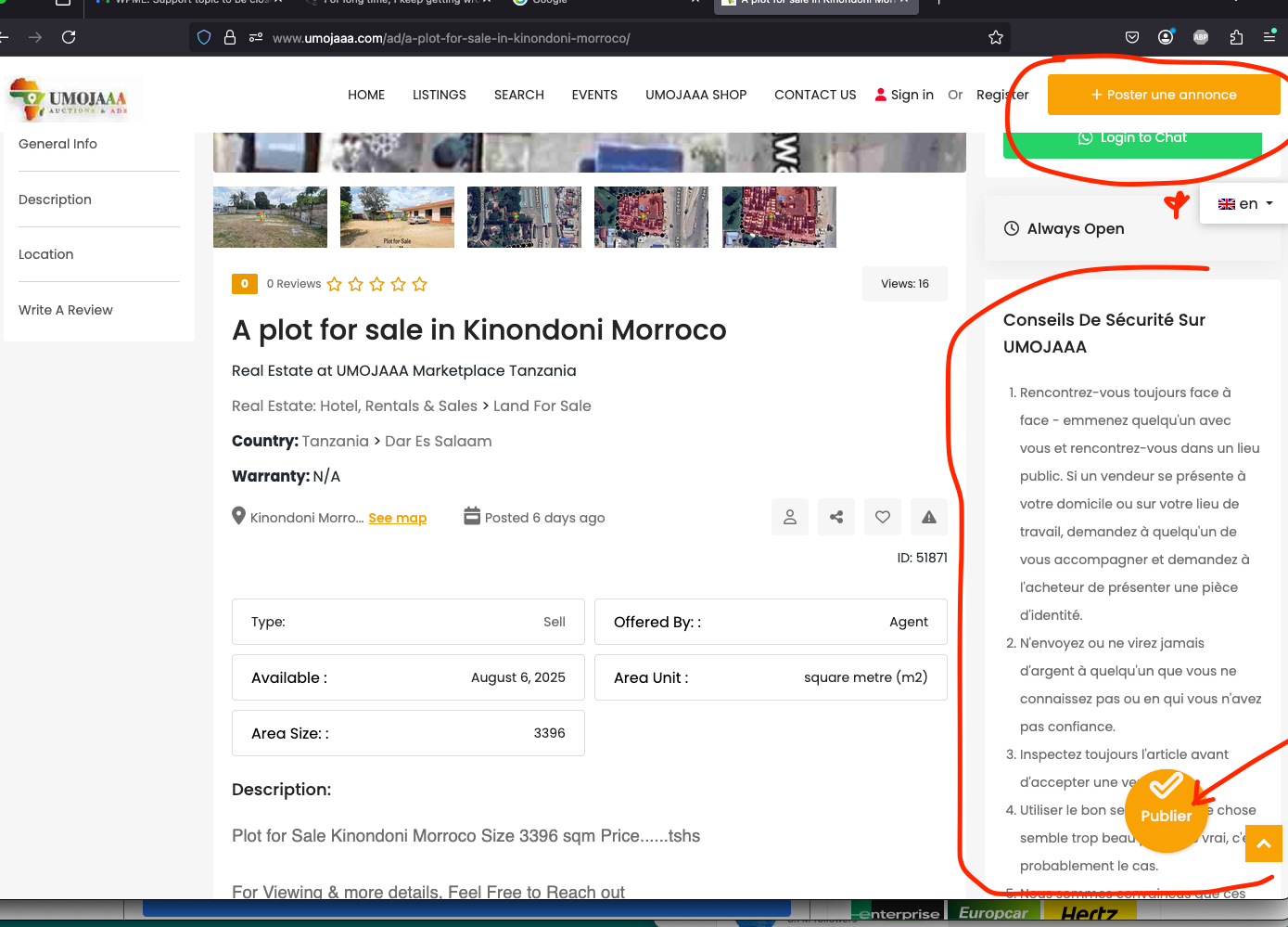

I checked things on your site and needed to look around for a while until I could find where the sidebar of Ad posts was created. I found it in Appearance -> Customize -> Ad Settings. I noticed that initially, this was inserted in French, where it should have been inserted in English. So in WPML -> Strings Translation, I switched the language of this string to French and inserted the English. I recorded a video while doing it. Please watch it here: hidden link. Also, please read more about changing the language of strings here: https://wpml.org/documentation/getting-started-guide/string-translation/how-to-change-the-source-language-of-strings/. Please repeat the same process for all the other strings with this same problem. For the next time, please pay attention ot insert the original text inside widgets in the default language of the site.
