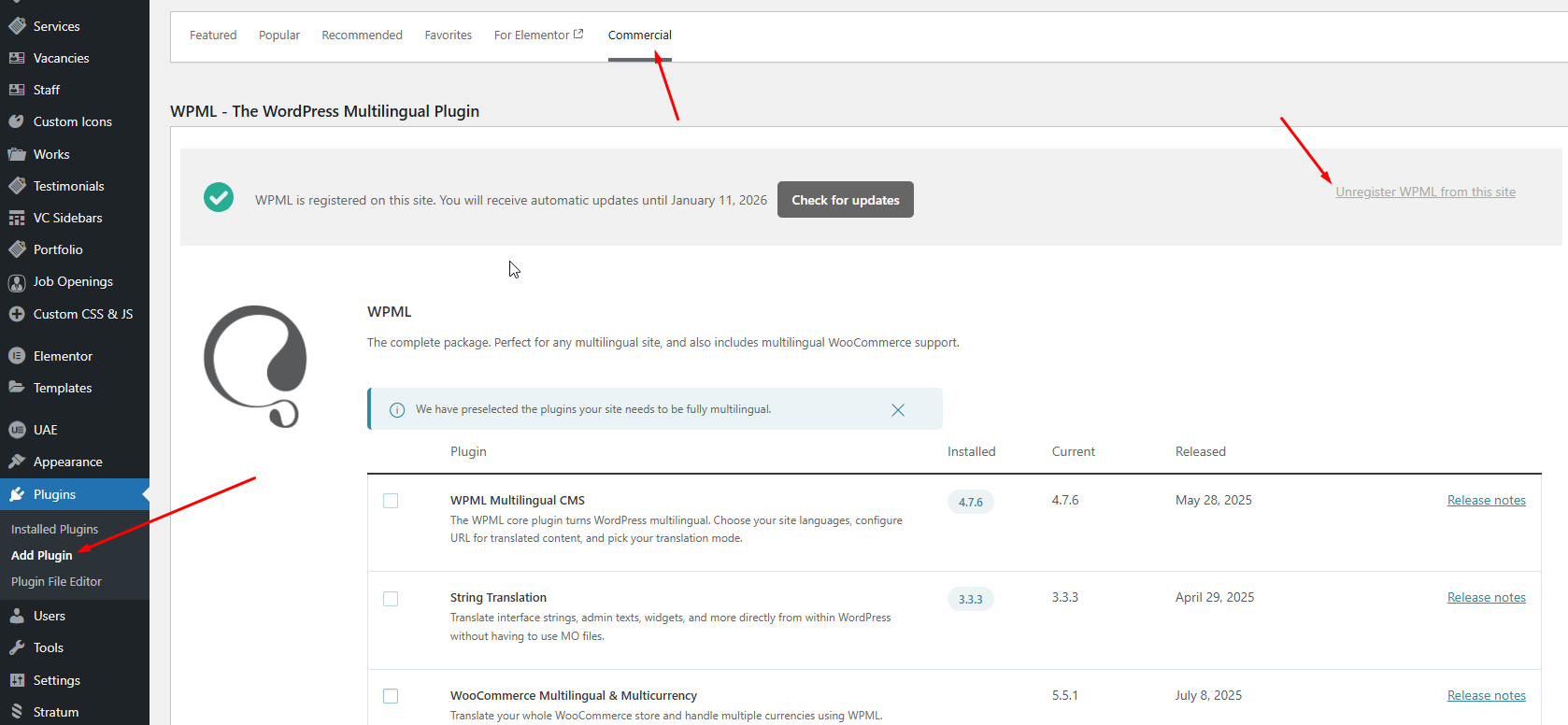

July 28, 2025 at 2:02 pm #17275640
Thanks for your reply. The option to input the sitekey is in WP > Plugins > Add new > Commercial Tab . I've attached a screenshot for your reference.

I've now assigned the new production key to the live production site, the banner has gone and the comms error has gone too, so all looks good.
