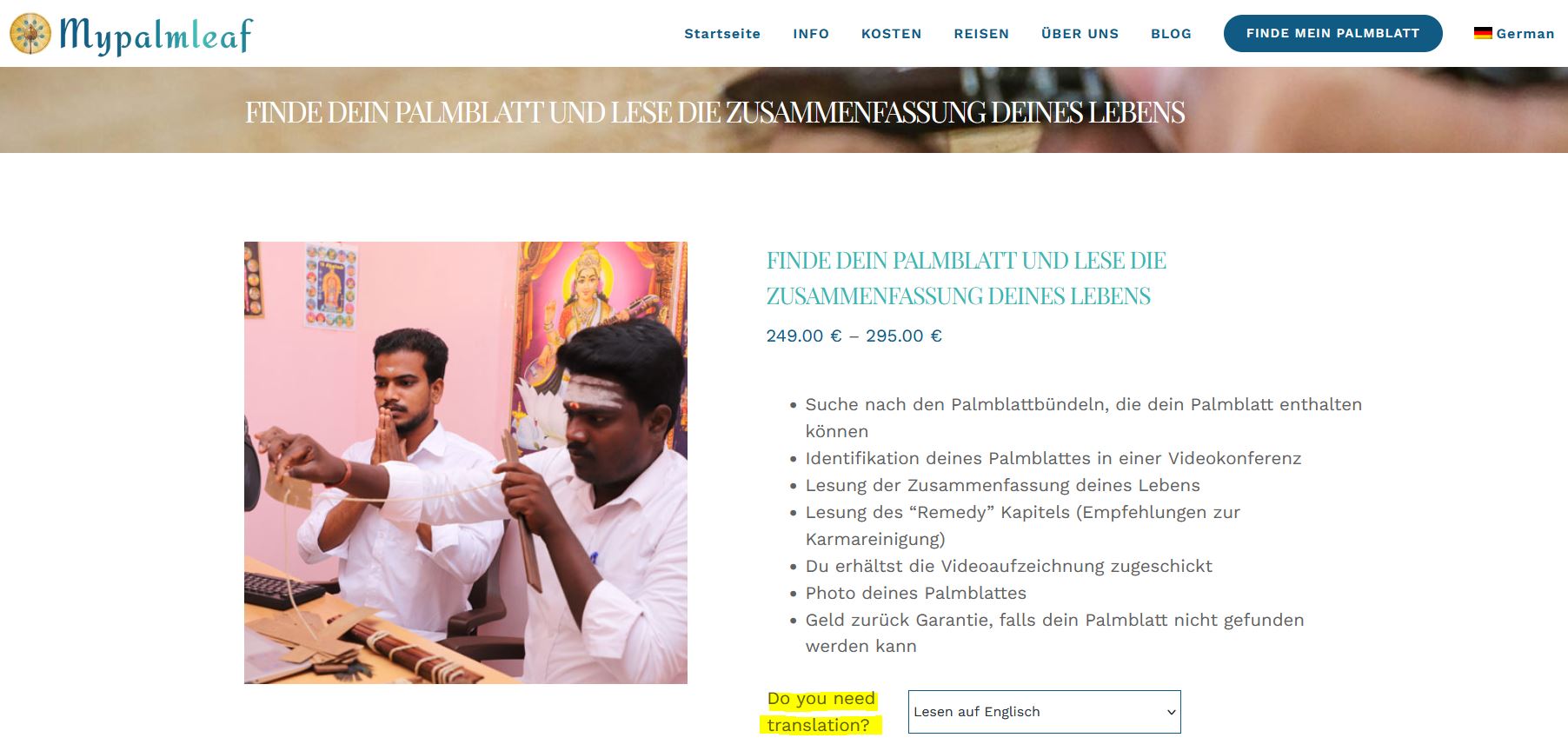

stephanO-4
My global attributes are not translated, the variations are working fine
I have attached the images for your reference to better understand the problem that the rest of the text are in GERMAN but the global attribute name is showing in English which i have highlighted
Your early response will be highly appreciated

Hope you have translated the Global Attribute labels from WooCommerce>>WooCommerce Multilingual>>Attributes or WPML>>String Translation.
Please refer to the following links for more details and let us know your feedback.
https://wpml.org/documentation/related-projects/woocommerce-multilingual/#taxonomies
Thanks!

Thank you for the updates. This may be a compatibility issue. Please visit WPML>>String Translation after a site backup and enable the *Look for strings while pages are rendered* option of *Auto register strings for translation* section(on the bottom of the screen). Then visit the frontend pages and check whether the issue is existing or not. This option will be disabled in a couple of hours automatically. But will help us to track the issue in similar cases.
Also, please increase the *MaxInputVars* of PHP settings to *10000*. Please check the following article for more details and contact your system admin/hosting provider for upgrading this configuration.

After doing the changes as per your advise, it works so i think the issue is resolved, but as you mentioned after few hours its again back to English in all languages.
Kindly advise how do i permanently resolve the issue.
