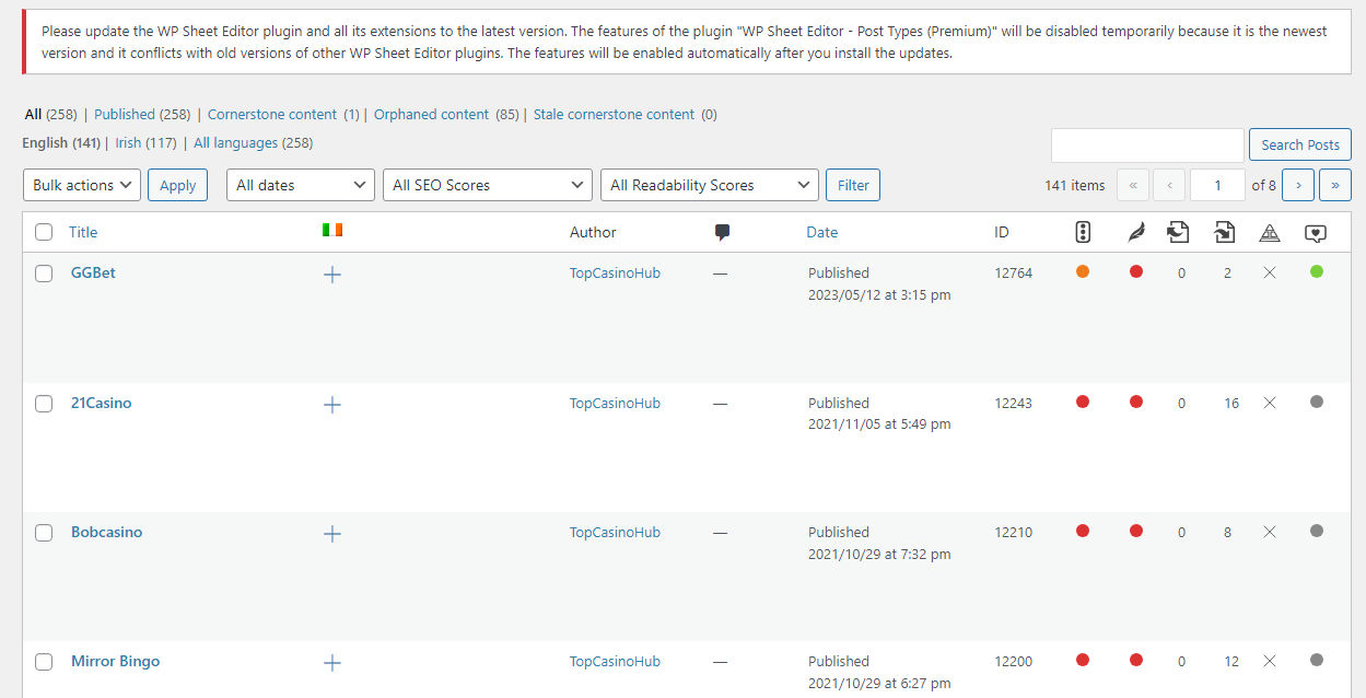

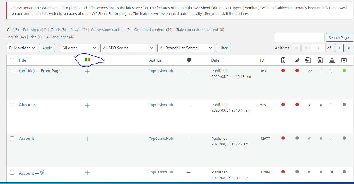

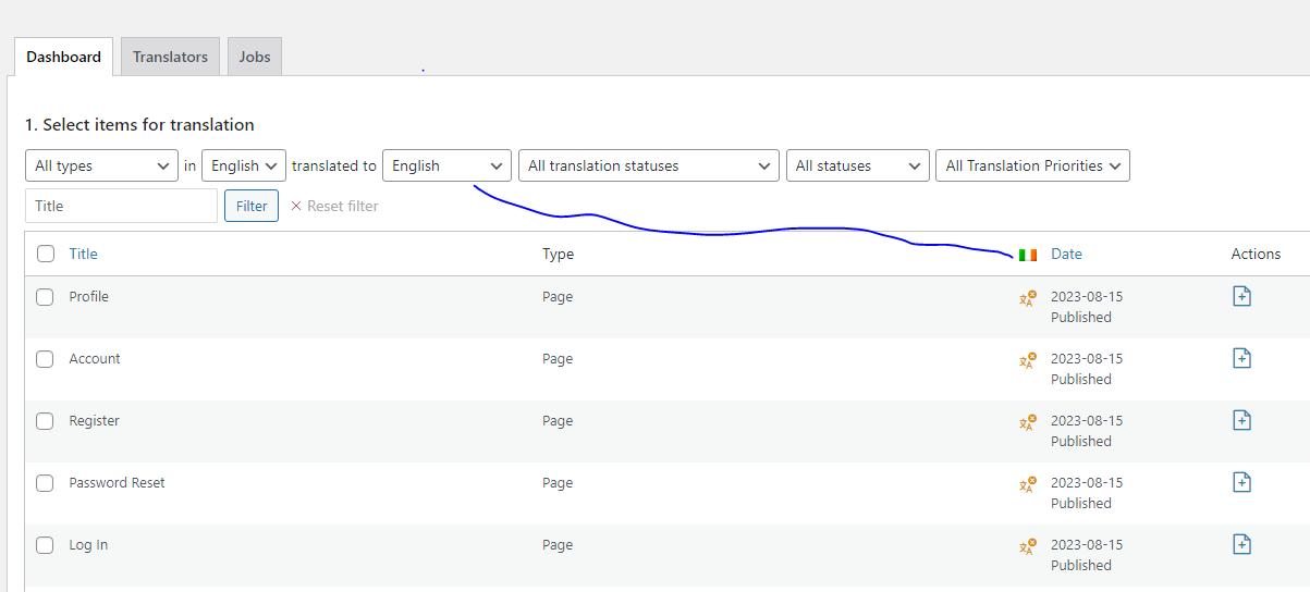

I expected to see:The WPML working properly across my website.
Instead, I got: despite the default language is English, it shows Irish.

The flags that you mentioned are an indication of Irish language controls, from that column, it will allow you to add translation to the Irish language, and show its status.
Right now, there is a + sign, which means if you click it, you will be able to add translations to the Irish language. If there is a pen sign, it means the translations is completed to Irish.

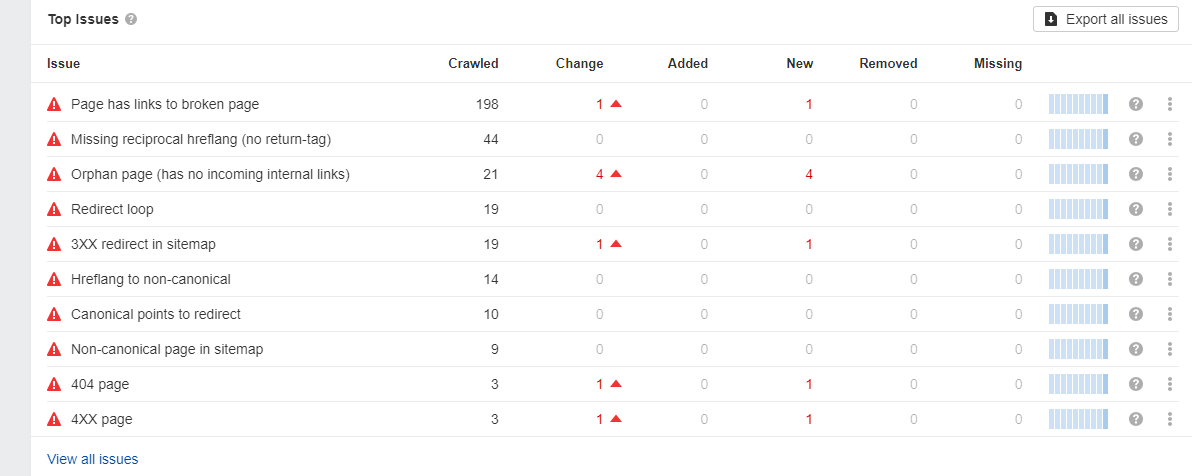

please check those files above, top issues there are cost by WPML I need help for that.

I can see tht your site has 2 languages: EN, GA.
From the screenshot it seems that the problem is that you see in the back-end the irish flag everywhere and that's expected since your content's default language is English and you will translate it into irish.
My colelague explained how you can translate the content TO irish (EN > GA), but i wonder if you were expecting something else? if that's the case, can you please tell me what were you expecting so i can show it to you?
