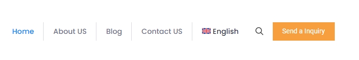

May 18, 2024 at 8:40 am #15641489
haifengL
No drop-down, no work
May 18, 2024 at 8:42 am #15641490
Marcel

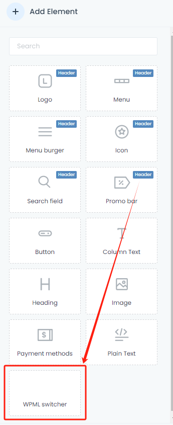

May 18, 2024 at 9:03 am #15641563
haifengL
1. I tried to insert a element of wpml switcher in Builder, but failed, pls check the image
2. Then, i went to WPML-Language-add a new language switcher to a menu, then it can display there with now arrow-down function

My friend tells me that, the reason why it didn`t show the arrow-down is that my site don`t have started to translate. Cause I haven`t finished the site text work, then I choosed the option of translate later when i activated your WPML. But i wanna check what the switcher will look like in my site, although i haven`t finishe this site, I still enabled the starting tranlate button to try to achieve it, however i failed again

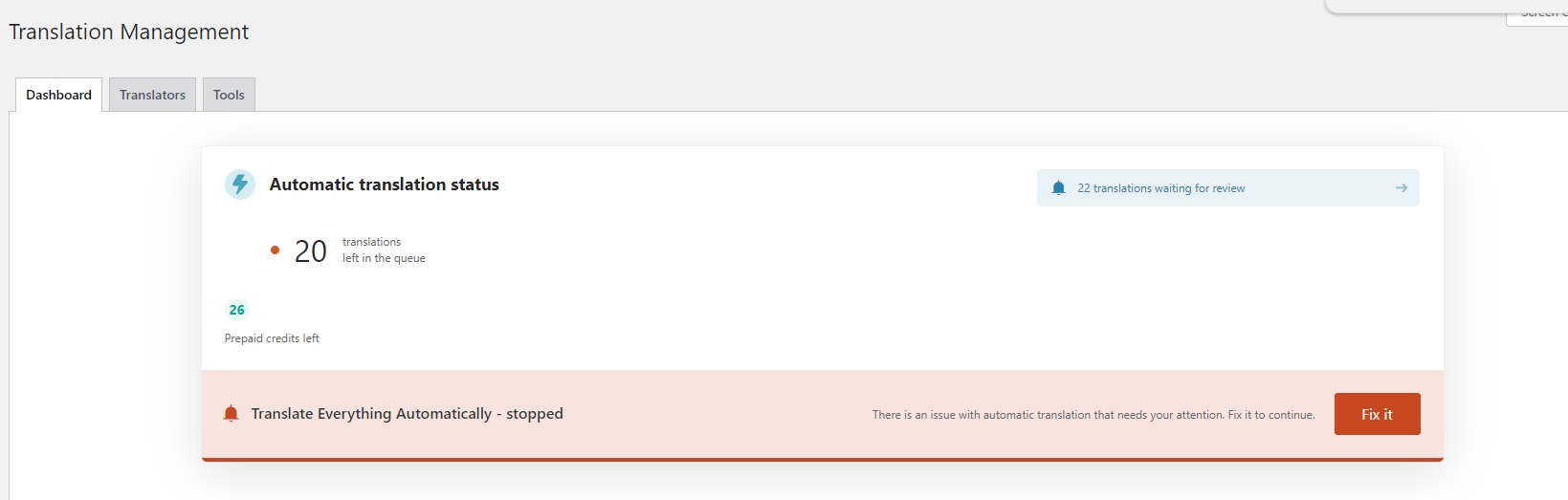

May 18, 2024 at 9:32 am #15641610
haifengL
I lost my 40000 credits, crying
May 18, 2024 at 9:36 am #15641620
Marcel
You already have 22 translations finished that are waiting for review (not published yet, see on the right top of your screenshot), which is why your credits are finished. You can review one page from that list, then open the Front End, switch the language switcher (which will then be activated for your secondary language), and see what it will look like.
You can review that page as described here: https://wpml.org/documentation/automatic-translation/how-to-review-automatic-translations-on-your-site/#reviewing-your-sites-translations-yourself, then it should work :).
Best Regards
Marcel
