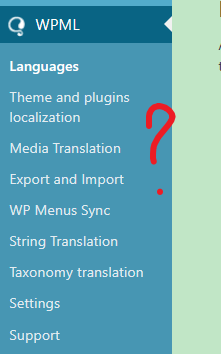

I want to translate my webpage into Chinese using WPML, but there is no automatic translation function. I am following a guide on how to use WPML with Woodmart.
I can't find the corresponding dashboard for automatic translation.
How can I enable automatic translation in WPML?
Where can I find the dashboard for automatic translation in WPML?
Basic settings have been made, but after clicking “Chinese”, the Chinese webpage is not displayed.

I looked at the guide above, but I can't find an option for automatic translation, not even the dashboard, I've checked through all the menus.

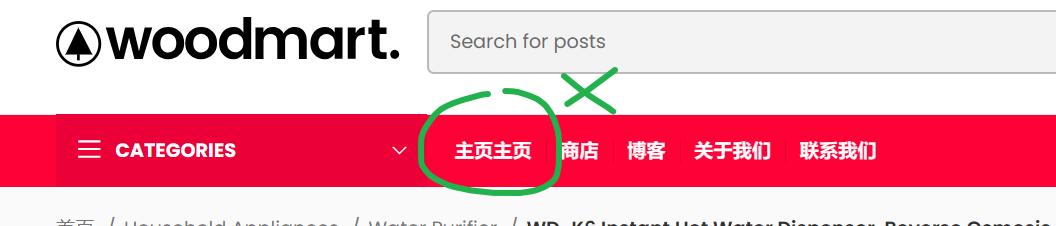

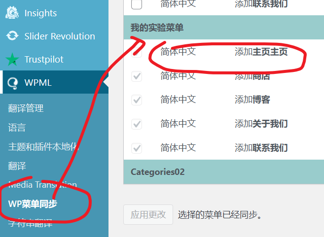

However, there is something wrong with the translation of the main menu.
What should I do if I want to make changes?

fanZ
To add, I am talking about "WP Menus Sync". If I think the translation here is wrong, how can I modify it?
