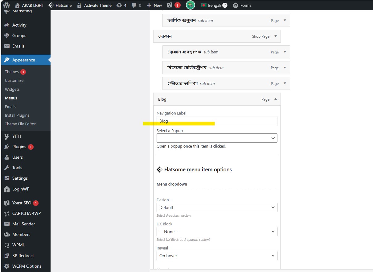

September 12, 2023 at 2:38 pm #14384741
Do I understand you right, that you refer to the menu item "Blog"?
If so, please adjust the Navigation Label inside the menus.
Guide:
https://wpml.org/documentation/getting-started-guide/translating-menus/#option-2-translating-menus-manually
Let me know if further assistance is needed.
Best regards
Andreas

September 12, 2023 at 3:17 pm #14385067
dairy-and-foodP
Hello, The navigation level is already set there by "Blog". But it did not solve the issue. You can make any changes and check.
September 12, 2023 at 3:30 pm #14385103
I am sorry, but I can not follow you.
Could you please be more clear about what you are trying to do so that I can assist you?
The screenshot I send you is from the Bengali menu and it uses "Blog".
I have adjusted this now to "খবর".
Is this what you are trying to achieve?
Best regards
Andreas
