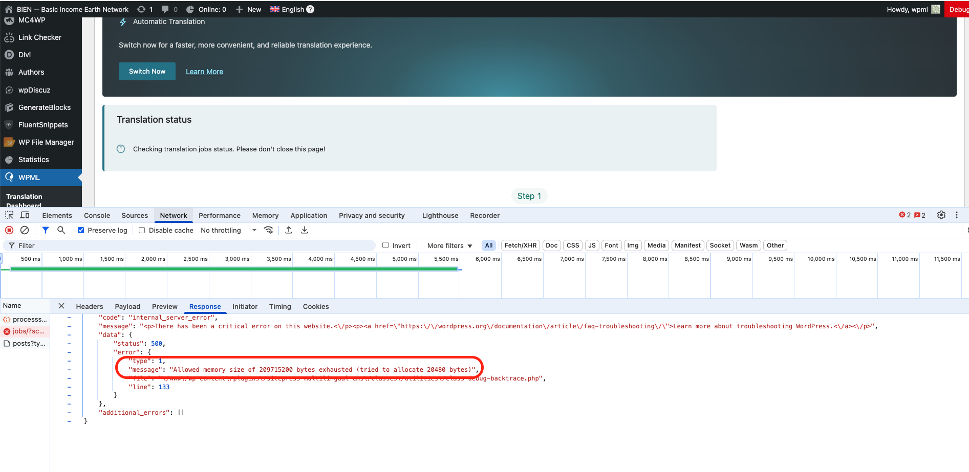

After I logged in to the dashboard, I went to WPML -> Translation Management and I clicked the "check status and get translations" button.
As you have a tremendous number of jobs that need to be retrieved, we got the error shown in the attached screenshot
"Allowed memory size of 209715200 bytes exhausted (tried to allocate 20480 bytes)"
So we need to increase the memory limit to allow the website to have time to get the translations.
I tried to do it myself, but I found that I don't have access to edit the wp-config.php file.
So please increase the memory limit and try to click the button again and let me know how it goes.
Best Regards,
Ahmed Mamdouh.

I checked the production site, and when I clicked the "Check status and get translations" button, I got the same error about the memory as shown in the attached screenshot.
Would you please record a video or provide me with a screenshot to show me what exactly the error you are seeing?
Also, I strongly recommend increasing the memory limit and trying again; this could solve the issue permanently.
Best Regards,
Ahmed Mamdouh.
