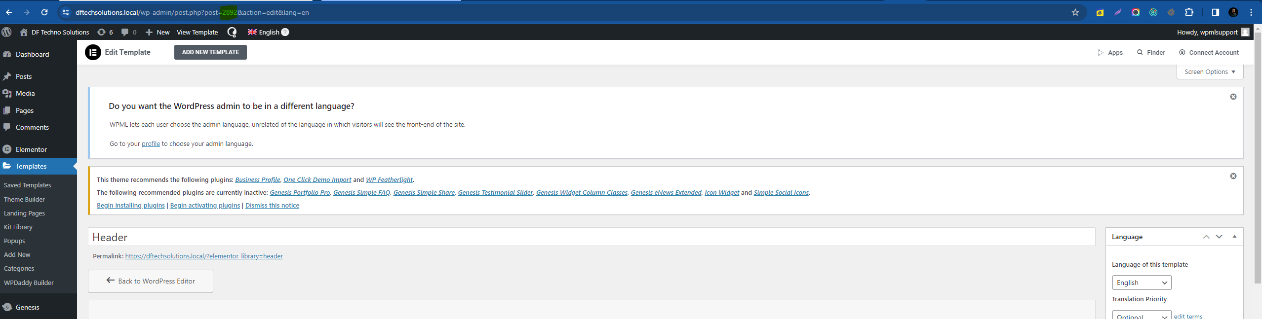

- Please switch to the secondary language of your site from WordPress admin.
- Now, go to Template > Saved Templates and locate the translated header template
- Open the template in the WordPress editor and then check the Browser URL bar. You'll find an ID associated with the "post" property(Check the attached screenshot). Copy that ID.

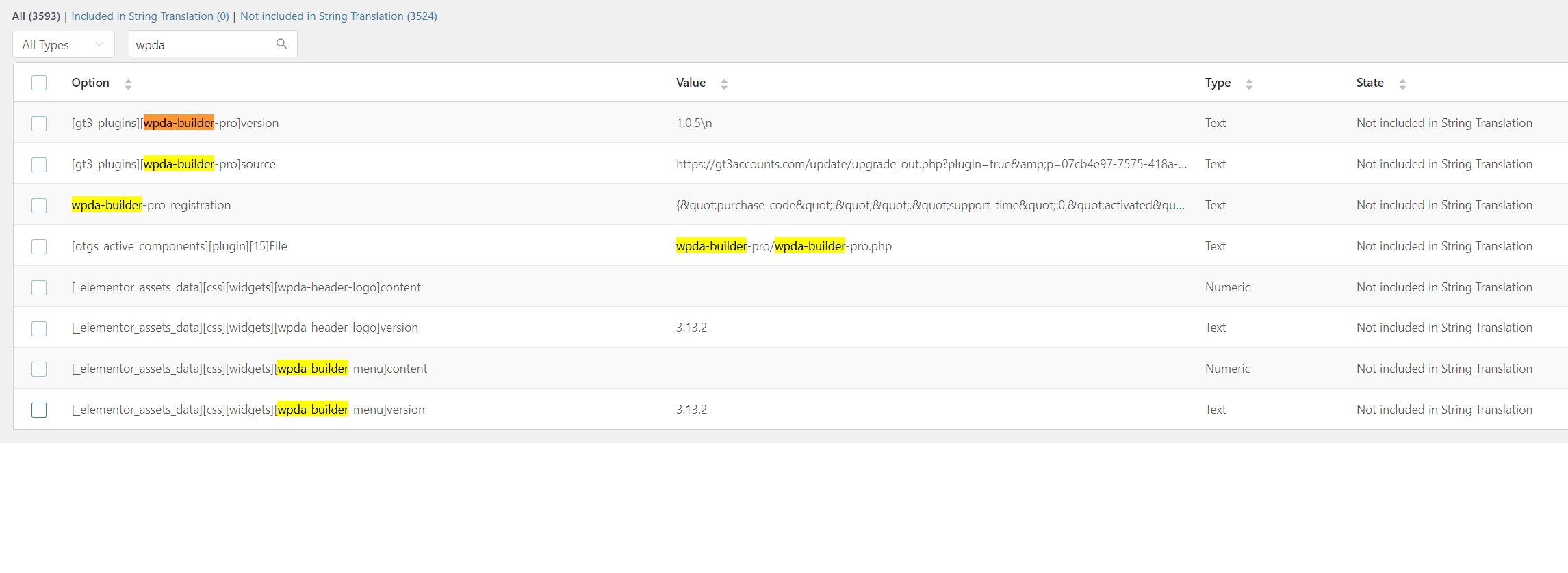

January 17, 2024 at 6:57 pm #15196581
markoR-12
Hey Prosenjit,
Everything till the String Translation part is okay. In the string translation I do not have the "wpda-builder-settings" anywhere. I've added a picture with what I do have.
Therefore I would need a different approach or clarification of what should I do with the strigns that I do have.
Thanks,
Marko
