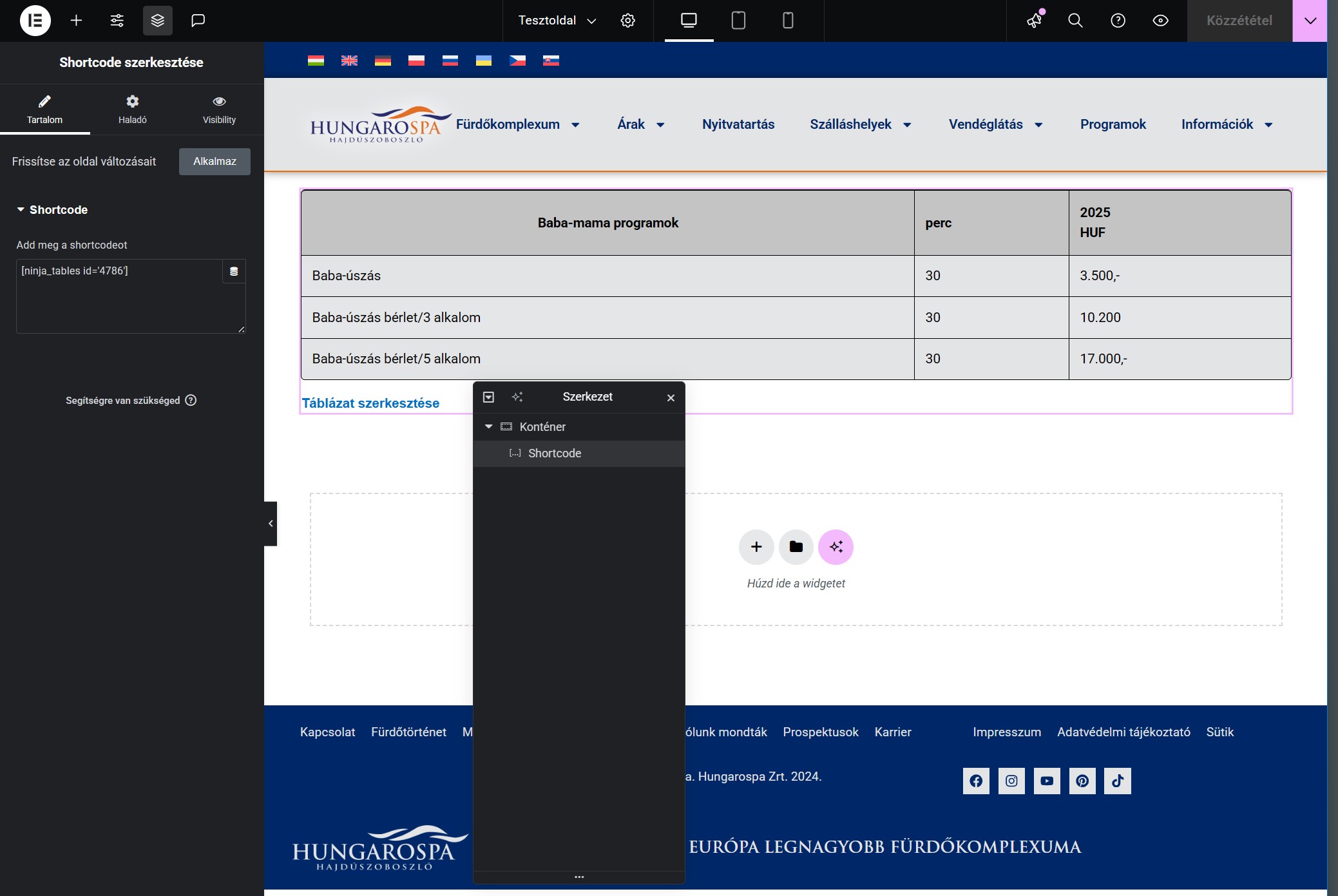

First I have made test page in Hungarian (default WPML languge), using Elementor Pro. This page is including a flex container and shortcode widget.
Shortcode widget contains : [ninja_tables id='4786']
It is OK in Hungarian.

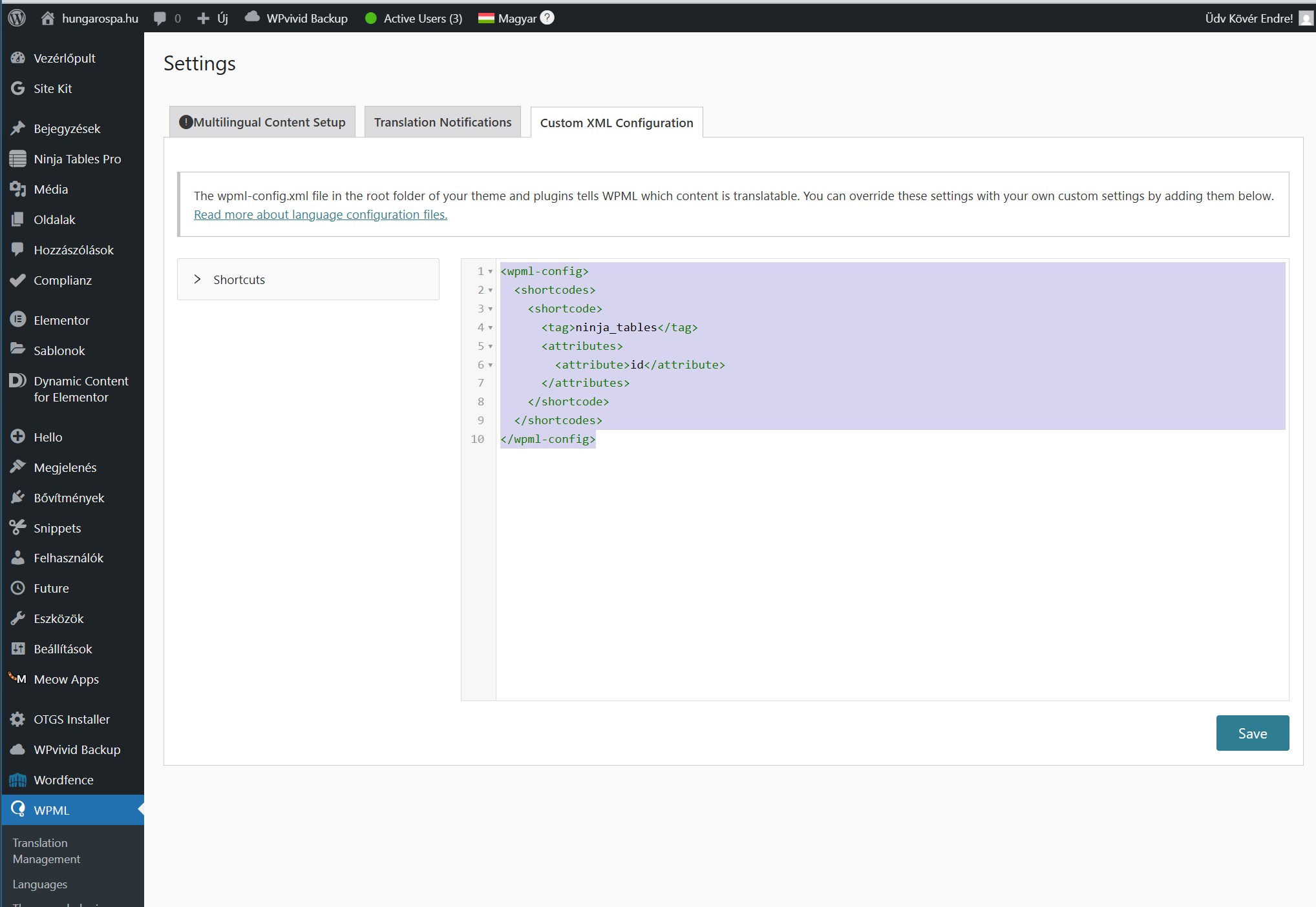

So, I guess, I must register "ninja_tables" shortcode in WPML Custom XML Configuration, so added this code:
<wpml-config>
<shortcodes>
<shortcode>
<tag>ninja_tables</tag>
<attributes>
<attribute>id</attribute>
</attributes>
</shortcode>
</shortcodes>
</wpml-config>

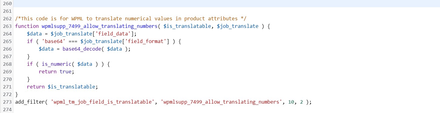

As this shortcode is ID based, so I added this this lines to functions.php:
/*This code enables WPML to translate numbers (like IDs) by overriding a default setting.*/
add_filter( 'wpml_tm_job_field_is_translatable', '__return_true' );

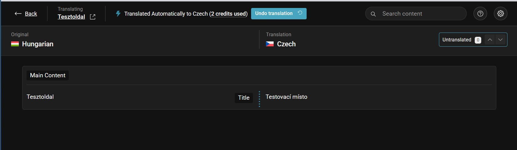

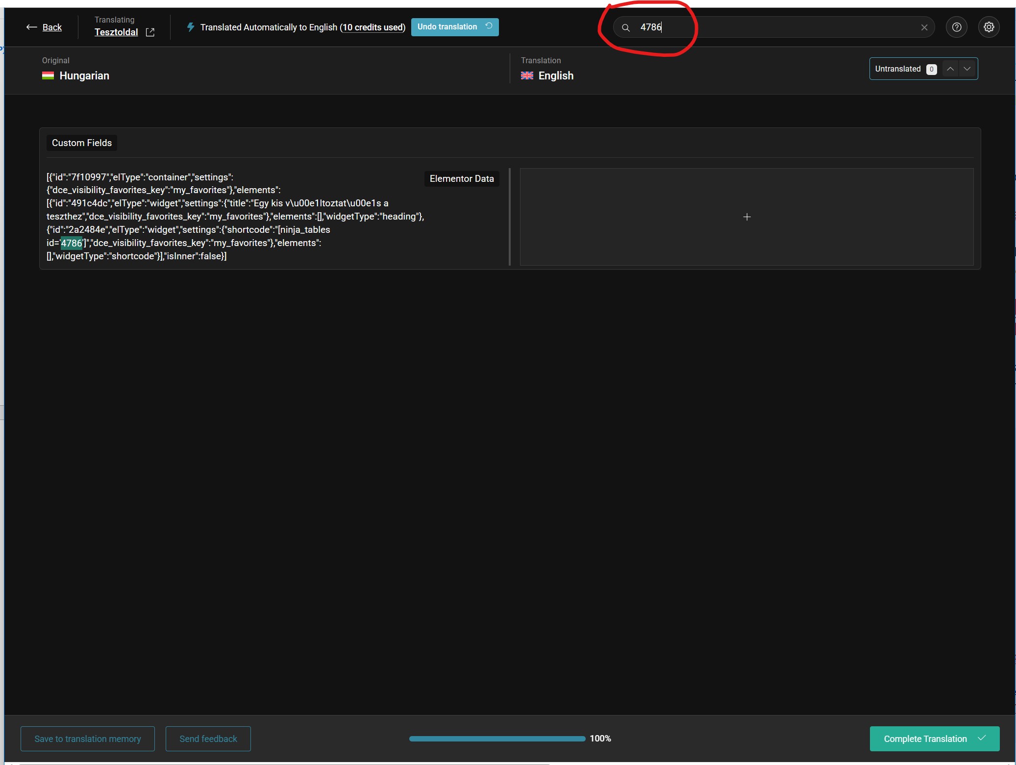

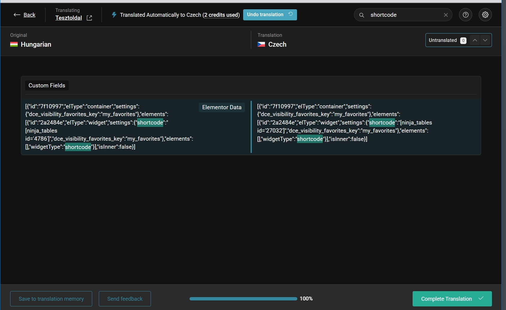

After saving all the files I started to translate to czech language. Unfortunetly no shortcode appeared for translation. (see image)
When I search for "shortcode" in ATE Custom fields appeared for translation. I have transleted the the field, changing ninja_tables id to Czeh table id. Saved, "completed the translation. After all, on front, switching to Czeh still Hungarian table is displayed.

Thanks for contacting us. You need to add this custom PHP code to allow number translations. Could you please backup and insert the custom PHP code mentioned here https://wpml.org/forums/topic/translating-numbers-2/#post-16201433 into your theme's functions.php file? Then, make minor edits to the primary language page and translate it again to see if the number shows up. Let me know how it goes.

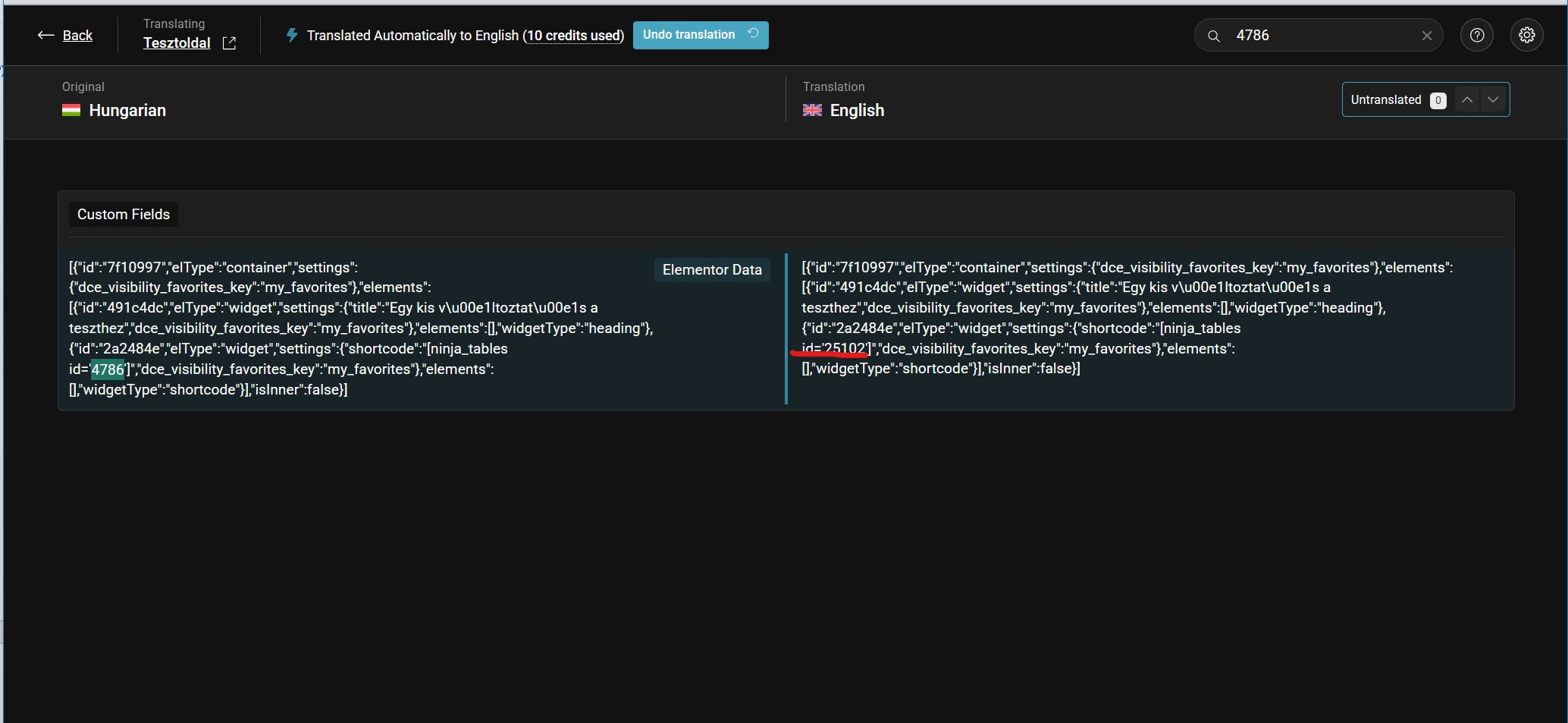

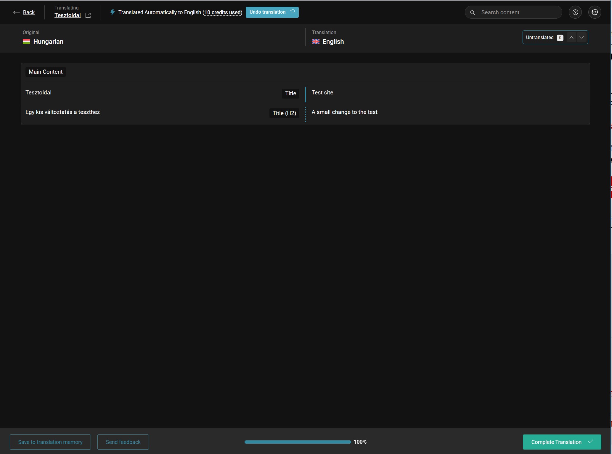

I have inserted the code into functions,php, than made a small change - header widget added - started Englesh translation.
No shortcode fields appered in ATE.
Serching for number 4786 -which is ID of Ninja Table in Hungarian - Custom Fields appeared. In custom fields I have changed the ID to 25102. Than saved with Completed translation.
At least this method has no effect, on English page still 4786 Ninja Table is displayed.
See attached screenshots.
Let me ask: maybe Elementor Shortcode widget registration problem exists? Not registered for translation?

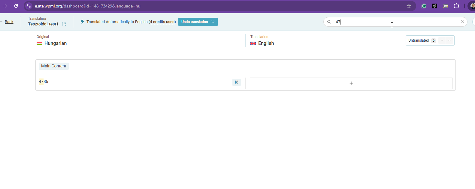

June 24, 2025 at 3:00 pm #17165729
WPML Supporter since 08/2022

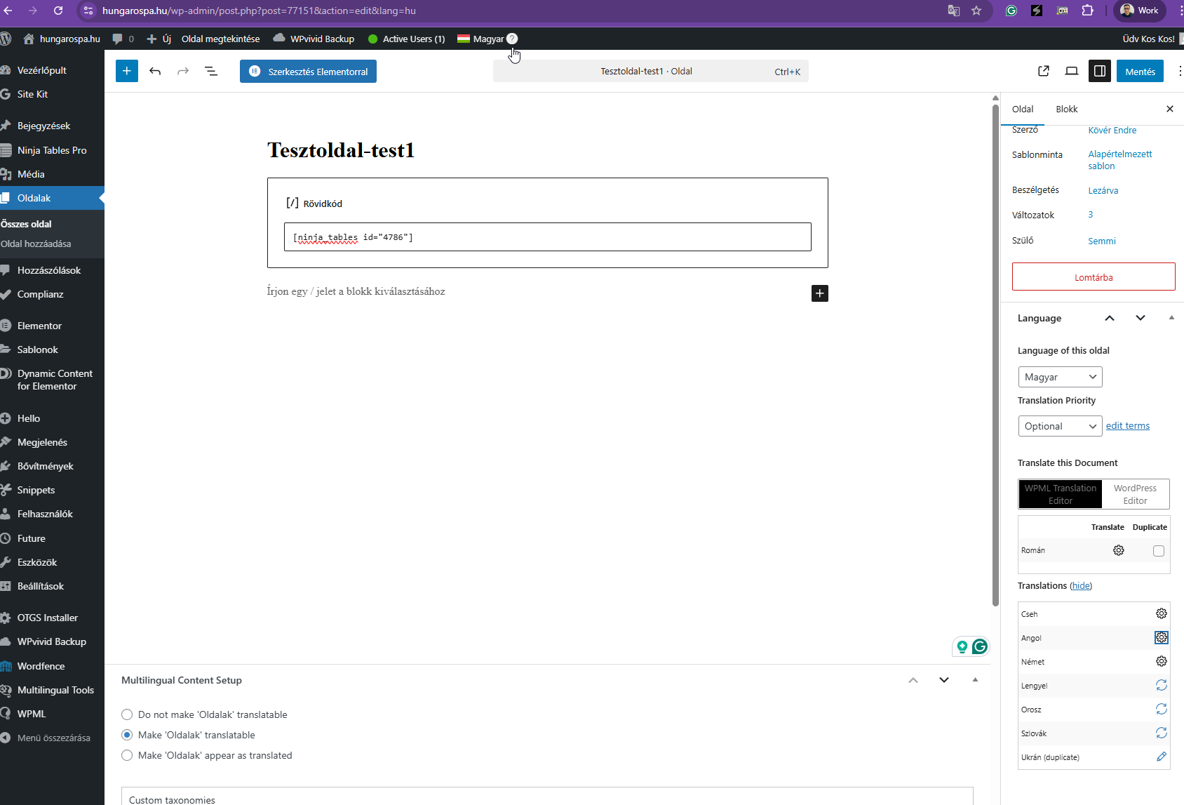

Thanks for your reply. Could you check now? I've switched to the Gutenberg editor and corrected the PHP code. Now, the ID shows up in the advanced translation editor.
June 24, 2025 at 4:06 pm #17166165
endreK-2
Well, yes, I see it works for "Tesztoldal-test1" page.
But in our case Elementor Pro is a must, our customer's authors and editors can not use Gutenberg.
So I have made a new page "Tesztoldal- test2" with Sortcode widget including [ninja_tables id='34668'].
Tried to translate to Czeh and English with ATE: no fileds apper. Then writing 34668 in search -> no field appear. If writing "ninja" in search "ninja_tables" is appear.
Please check.
