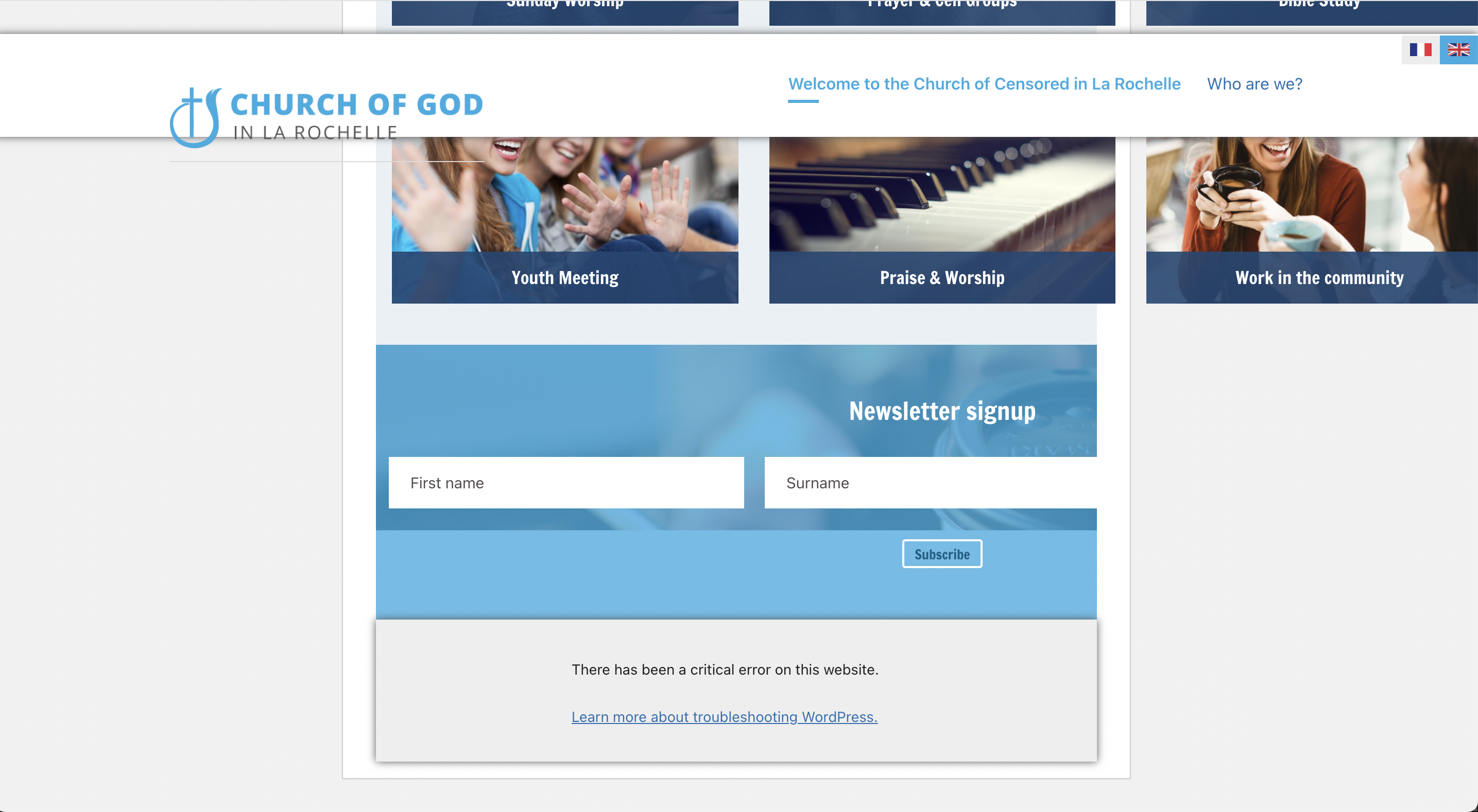

I am trying to display the English version of my site correctly. Recently, it has stopped displaying as expected. URL: hidden link
The English version of the site is not displaying correctly. At the bottom of the page, it says 'There has been a critical error on this website.'
What is causing the English version of the site to display incorrectly?
How can I resolve the critical error on the English page?

I have checked the page and the Fatal error is still present. Could you please enable the WP Debug Log on your site so we can gather more details about the source of the error? Please refer to the guide below to understand how to enable the debug log.
- https://wpml.org/documentation/support/debugging-wpml/
If you notice more details about the error after enabling the debug log, please share that in the next response. I will check and suggest what to do next.
Additionally, could you please check what happens when all plugins are disabled except for WPML and its add-ons? If the issue is resolved, start activating the plugins one by one. After each activation, refresh the page and check if the error reappears. This will help us identify the specific plugin causing the issue.

I have enabled the WP Debug Log and checked the error reports. I fixed the error on line 92 of header.php but that didn't seem to help.
I also tried deactivating the plugins as you suggested and I found one that was causing an issue - WP Super Cache. When it's deactivated, the page is looking a lot closer to how it should look, although there are still issues: for example, the black login bar is not displaying, nor the site footer.
Any further suggestions would be greatly appreciated, thank you!

I checked and can see that the fatal error is no longer appearing on the English version. Since deactivating the WP Super Cache resolves the issue, it's likely that a specific feature within the plugin was causing a conflict, which prevented the layout from displaying correctly and triggered the fatal error.
As you mentioned that the black login bar and footer are not loading, I checked but didn’t find the black login bar you're referring to, even in the default language. However, I did notice that the text slider below the newsletter form and the footer are missing in the English version.
Could you please share how those elements are added to the page? If you could provide a screenshot or a video of the process, it would greatly help in understanding the issue and suggesting a solution.
