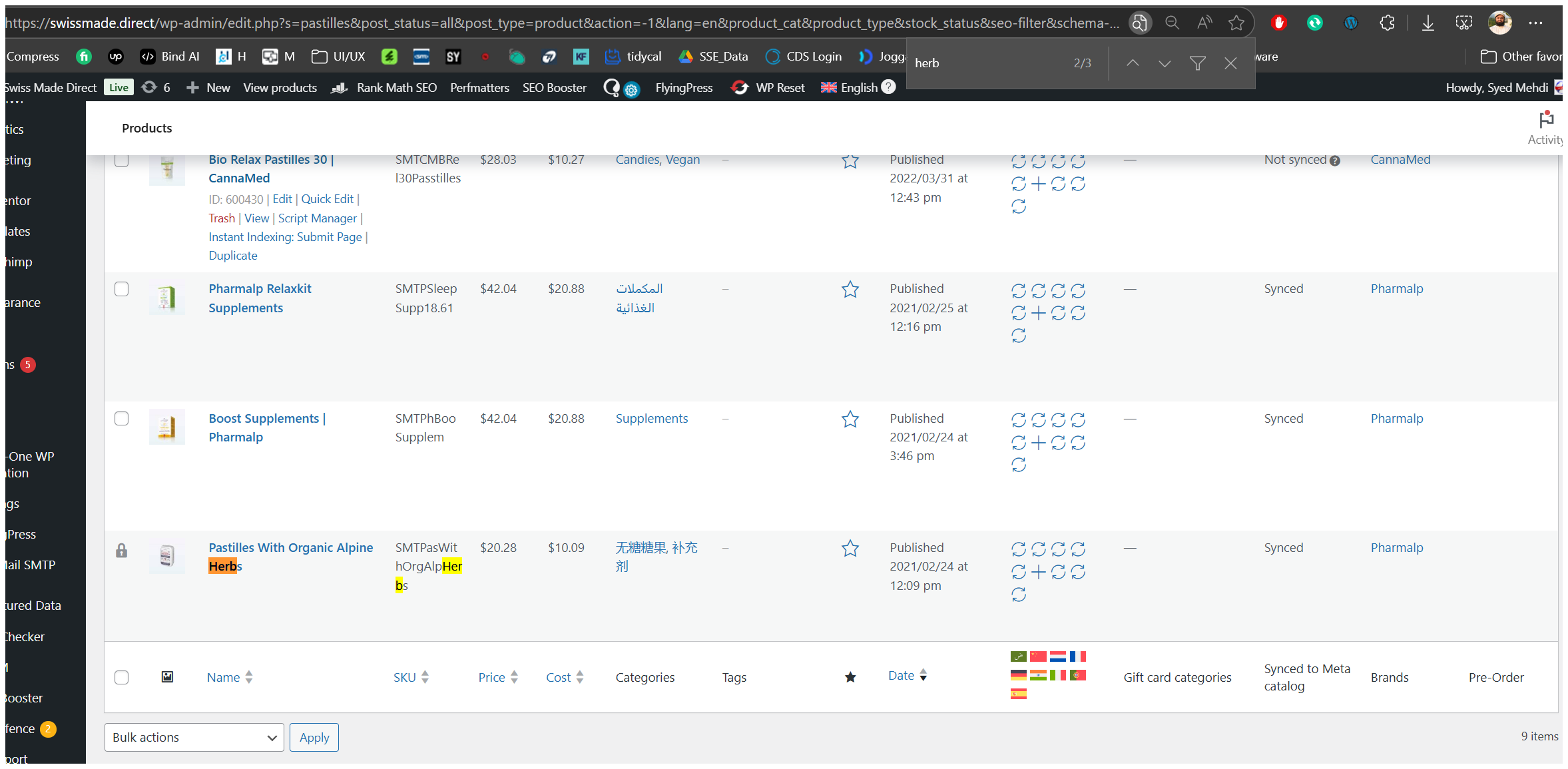

yvesB-21
yith filter is breaking on language pages hidden link
images are not showing in places hidden link
sometimes product images are not showing on different languages

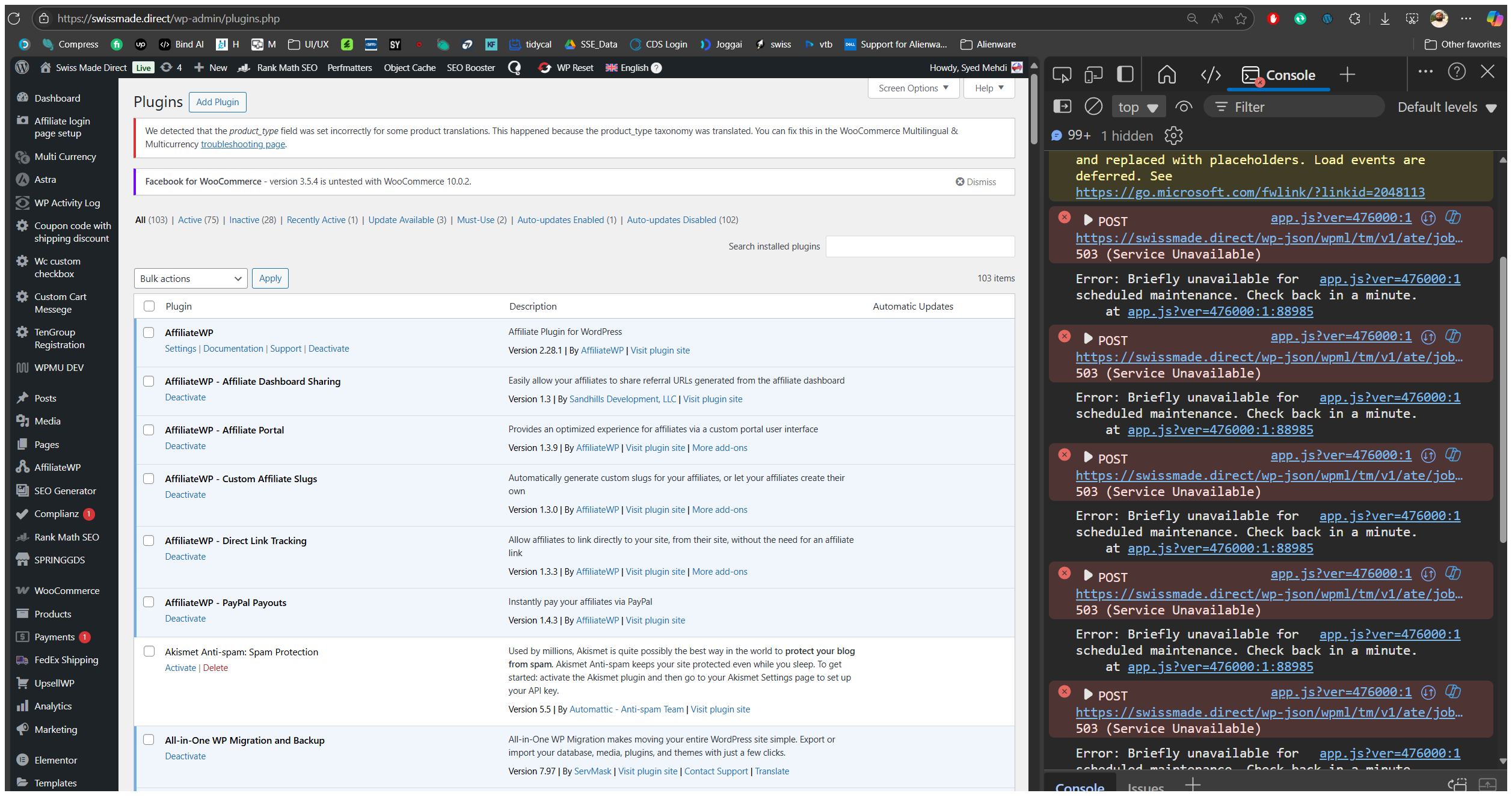

yvesB-21
can you check why i am seeing this ? 503 error
New threads created by Alejandro and linked to this one are listed below:
https://wpml.org/forums/topic/503-error-ate/

I have split all the issues on their own ticket. we can only handle one issue per ticket.
I'll be checking it out soon and leave answer on all the tickets.
