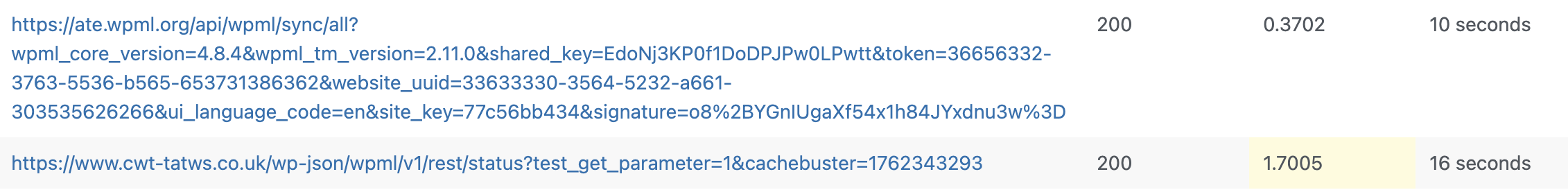

I am trying to address performance issues caused by calls to the ate.wpml API, which are slowing down the admin area. These calls occur on every admin page, such as: hidden link. All translations on the site are done manually, so I don't see the need for these API calls. Additionally, there are less frequent calls to: hidden link.
The API calls take between 0.5 and 2 seconds, significantly degrading performance. Disabling WPML noticeably speeds up the site. The server has been upgraded recently, and there are plenty of resources available, so these aren't an issue.

It appears that you have some jobs that were sent to translation to ATE and analysing the database, I've seen that the sync request is happening because of that.
These specific jobs left an entry in the database and the sync request was trying to check their status with ATE server. However for those jobs, the original pages were deleted and no progress was made on translating the job since its creation, which resulted in the process being stuck and happening and checking for changed status over and over.
I've fixed the problem on your site and also I have notified our developers of this case.
