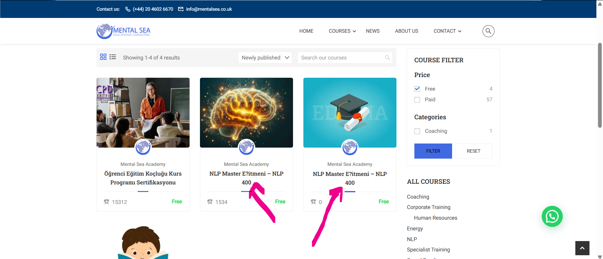

March 29, 2025 at 1:26 pm #16875317
bernaT
I can still see a bunch of Question Marks in the top right corner. Also, at the form below as well. Can we just change all the tables?

March 31, 2025 at 12:27 pm #16879239
Otto
I can't do it all at once, I have an error when trying to run a query to do so:
Error
SQL query: Copy
ALTER TABLE `yaLCn_signups` CONVERT TO CHARACTER SET utf8mb4 COLLATE utf8mb4_unicode_520_ci;
MySQL said: Documentation
#1044 - Access denied for user 'u452833898_z0aRu'@'127.0.0.1' to database 'information_schema'
Can you please check it with your hosting? They may be able to change the collation for you directly. Make sure that it's also done for the columns.

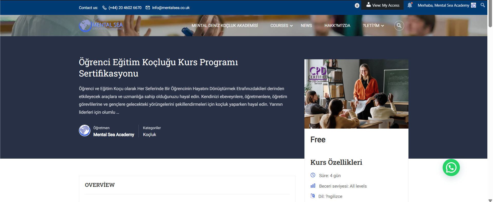

April 3, 2025 at 1:02 pm #16892461
bernaT
There is a non-existing Turkish course that has been listed in English courses. There is no way to delete that course. Did you add it? (I've cleared the cache and cookies. It is still there)
This is a running website, Otto. Can we please make the changes in the staging website and than publish it to the main?
We can't afford such mistakes. How can we delete the course that is not showing in the courses list? The image and link can be found below.
