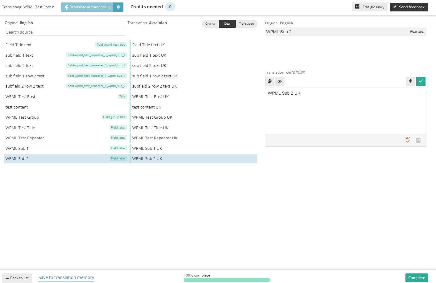

July 10, 2023 at 8:42 am #13975561
Waqas Bin Hasan
WPML Supporter since 05/2014
Thank you for waiting.
I checked about your field group and found it behaving exactly as you mentioned, like trying to set translation mode for a sub-field in a repeater field and having no-label field. This happened for as many fields I tried to set option for.
I then deactivated WPML SEO and WPML Media plugins, in a hope that if these are creating any problem. But this didn't make any difference.
Then, I created a new field group "WPML Test Group" and played with it. I used Text and Repeater fields (used text fields in repeater and sub-repeater fields also).
I tested this as below:
- with Post
- with your Block (Course program section (DSQUAD))
- kept WPML SEO and Media plugins active
And all seems to work fine. I even reedited the group, changed translation options, saved and couldn't reproduce that no-label fields issue.
One this I found strange, that when I add the block to a new page, I don't find my fields in the block but these are on the sidebar.
While if I edit the home page (the one you created), my fields appear in the block and in ATE as well.
I am not sure but I've following suspects:
- The theme you are using is based on 2016, means very old.
- Either the theme is customized or has custom code belongs to the blocks handling.
- The blocks are custom ones.
Can you try followings in this sandbox site?
- Create a new field group with exactly the same fields as your original one, BUT, do not use it with your block. Use it with Post or Page simply.
- Check your field group vs your block with another standard WP theme like 2021 or 2023.
Please note that when trying to reproduce the issue with your field group, it was messed up with so many no-label fields and those fields were removed from repeater ones. So you may need to recreate or fix that field group.
Let me know how it goes.
