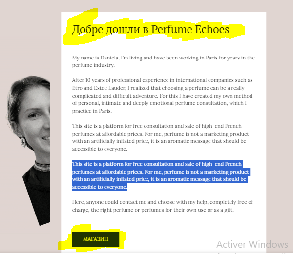

I succeed to translate the main "welcome" text and "this website uses cookies", but I stil can't find these two things to translate :
"Добре дошли в Perfume Echoes" and "МАГАЗИН" - it means SHOP on my main page :
The other ticket for the menu "Contact" was closed, so I answer you here.

That text comes from the plugin smart slider. all the content in that section comes from there.
You can find it here: hidden link
And you can translate it using the information on this reply: https://wpml.org/forums/topic/some-parts-of-my-site-are-not-translated/#post-14928631
there's a video there that shows you how to do it exactly on that slider and all you have to do now is apply the same thing to the content that you can't se translated yet.
Try it out and let me know how it goes.
Let's first tackle this issue and i'll help you with the contact form as soon as you confirm the slider text has been translated, ok? this way we keep things clean.

i'm sorry if i wasn't clear before, the video i sent you shows you how you can use our translation shortcode to wrap the text you want to translate from the slider around it (The shortcode) and make it translatable.
It's the only way it can work and it's how i made the other parts of the slider translatable. the same applies to the headline, i suppose since it works in the same way 🙂
here's a video showing you how it works on the headline and the button: hidden link
At this point you can do the same to the other sliders. if you can't understand the video, if you can't understand the procedure i showed you, please tell me where are you getting stuck because this procedure has to be done because the slider plugn you're using is not compatible with WPML by default so you have to "manually" register the texts (called a "string") so you can have it displayed in a translated way.

Alejandro
WPML Supporter since 02/2018
I registered the strings using the shortcode workflow as i showed you in my last few videos and they appear now in hidden link (WPML > String Translation)
You can go ahead and translate the strings so they appear as translated in the front-end. remember to clear your cache when you do, in case they don't appear as translated.
