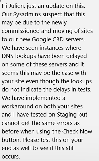

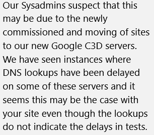

February 15, 2024 at 7:31 pm #15309253
julienB-61
I asked the provider to check the point 3 and here is their reply:
February 15, 2024 at 10:13 pm #15309630
Bobby
WPML Supporter since 04/2015
Thank you for updating me, please ask them to include the IPs that come from the following domains
wpml.org
cdn.wpml.org
api.wpml.org
api.toolset.com
cloudfront.net
possibly manually added to /etc/hosts file
Based on the wpml: cURL error 28: Operation timed out after 45009 milliseconds with 0 bytes received
There was a temporary slow-down between your server and WPML.org please also share that with them

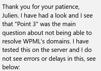

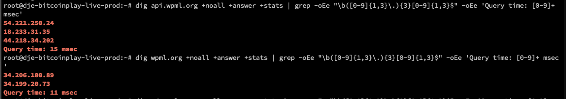

February 16, 2024 at 8:20 am #15310352
julienB-61
Hello, here is their reply regarding point 3:
and Qmonitor stats are high.

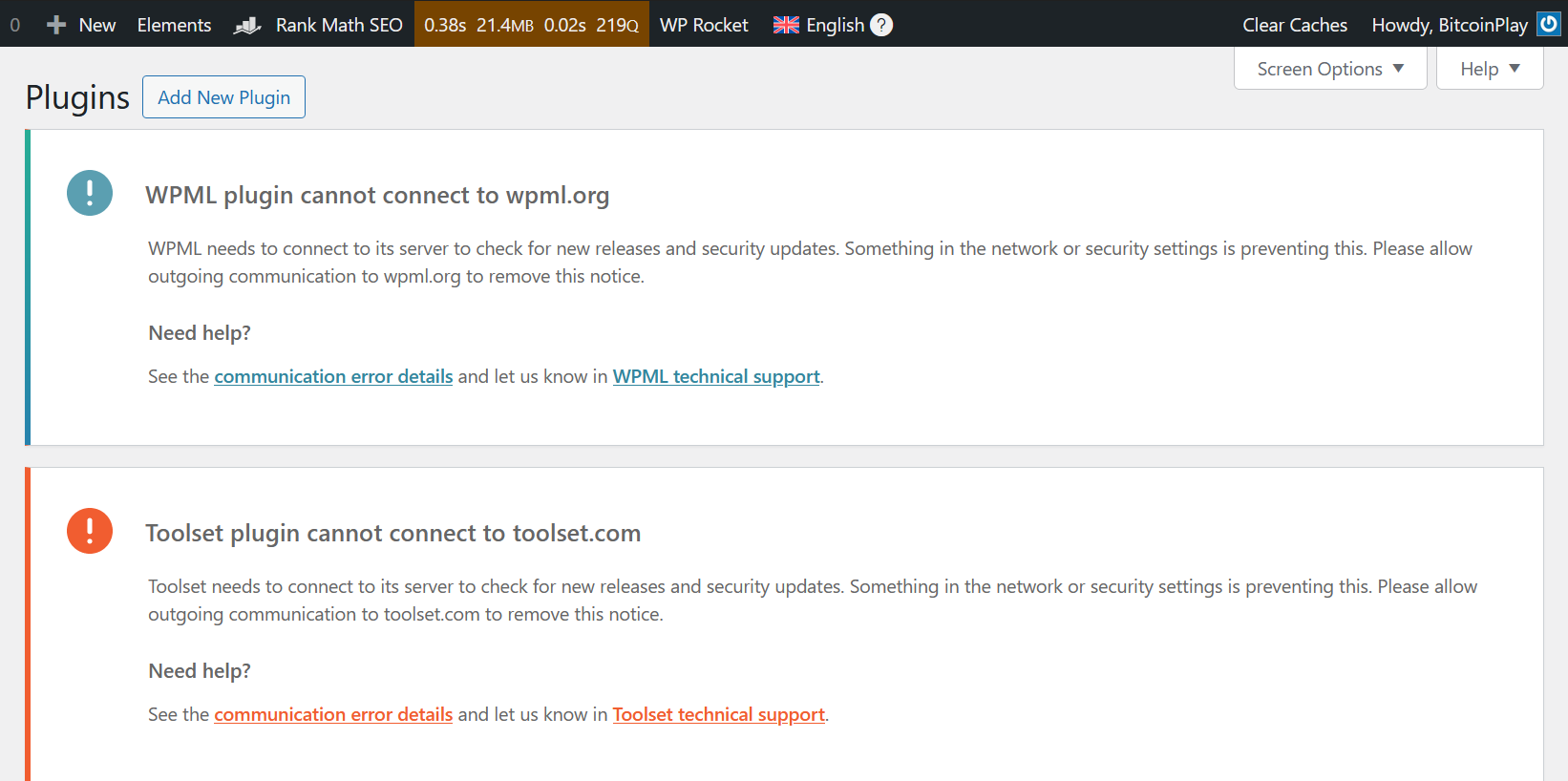

julienB-61
Here si the last update the provider applied and the API connection seems to be resolved.
an issue left is the error message on top of the plugin list.
February 16, 2024 at 6:57 pm #15312932
Bobby
Thank you for sharing the updates with me!
Going to WPML->Troubleshooting->Installer Support and checking the connection it is working OK now.
What they explained in the last screenshot is most likely what is causing this issue and it seems like they fixed it on their side.
I was able to go to Plugins->Add new->Register WPML and then the warnings were removed.

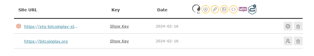

February 16, 2024 at 7:06 pm #15312952
julienB-61
It seems to be working now.
I'm testing a bit more to be sure
February 16, 2024 at 7:56 pm #15313007
julienB-61
I did the config like on the screenshot with new keys on both env. and it seems to be working for now.
Let's see in the coming hours if everything remains the same.
Thank you very much for your support and your colleagues too!!!
The duplicate Cloudflare was the 1st reason for the connection issue and the 2nd was the attached screenshot.
Julien
