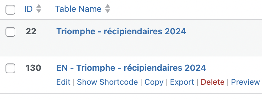

I changed the id 22 (French) for 130 (English). ID 130 can't be found even though the table is created. When I revert back to 22, the French table reappears. Do you have an idea why?

Have you checked the settings of the EN Table (ID 130)? Perhaps it's set as draft, or has any other settings preventing it from showing on the front end. Let me know.

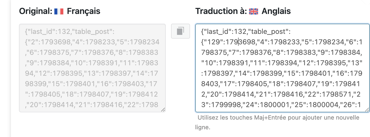

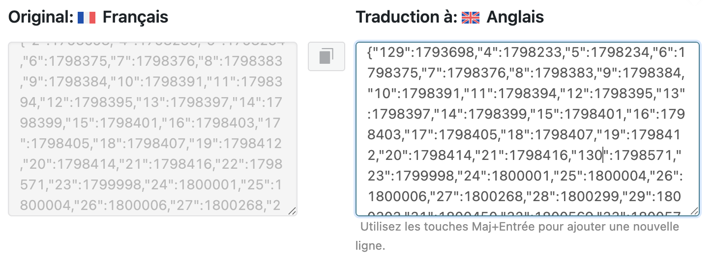

At first I thought it might be because of the "last_id" value at the beginning of the string, but it doesn't change anything when I change its value.

Thank you for waiting. I double-checked the documentation, and noticed that we were actually using the wrong IDs to translate. The correct default and translation IDs must be taken from WPML > Translation Management, and from WPML > Translations, respectively. I've demonstrated that in the video below (sorry, I work at a quite loud environment):
I recommend you to start from scratch, in WPML > String Translations, as a lot has been changed already. Please use the correct IDs and let me know how it goes.
