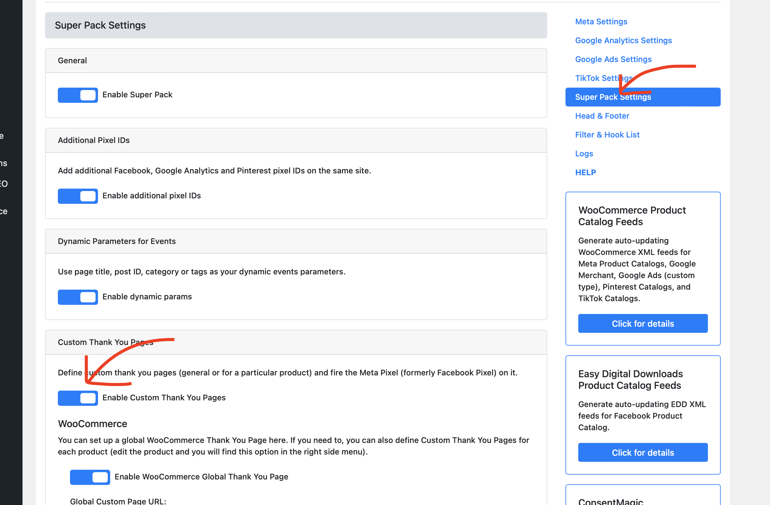

Hello.
I am sending you a screenshot from the PyxelYourSite plugin where you can disable this feature. The thing is that it makes no difference whether this function is enabled or not, I tried to turn it off so that the standard thank you page would work and the problem was still the same.

December 1, 2023 at 5:02 pm #14974829
Ilyes
After further verification, the issue could be related to this known errata : https://wpml.org/errata/elementor-pro-custom-thank-you-page-not-displaying-in-second-language-when-woocommerce-endpoint-is-translated/
I could apply this solution for you if you could confirm back that you saved a backup of your site first.
