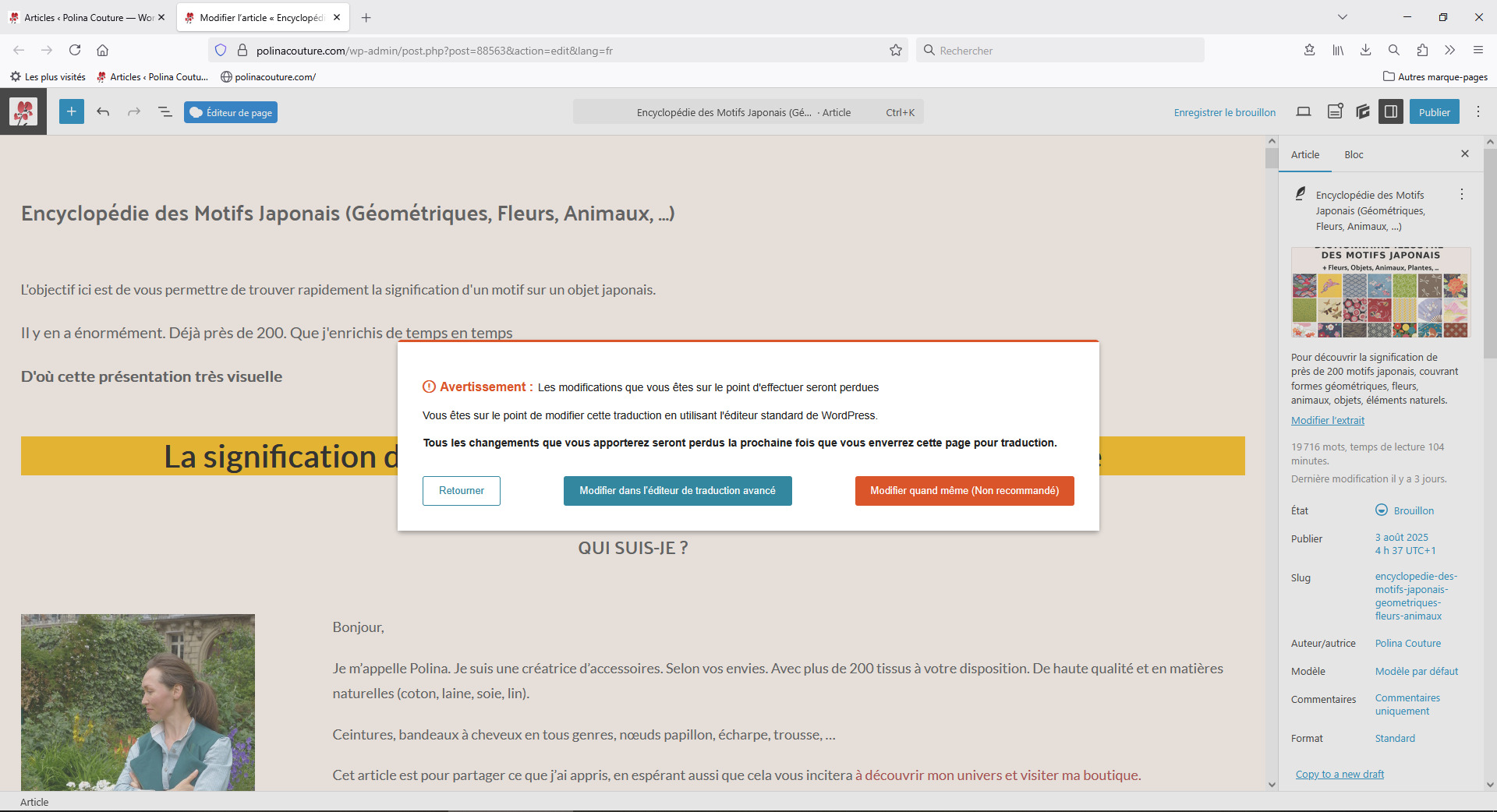

Got a new bug tday
I opened a post ((article) in its orginal language (FR) to revise it.
And got that the attached.
The post is clearly identified as in original language (FR), as URL proves its.
Though, I got the warning: your translations will be lost.
Sorry, it does not work normally.
What could be your excuse, this time?

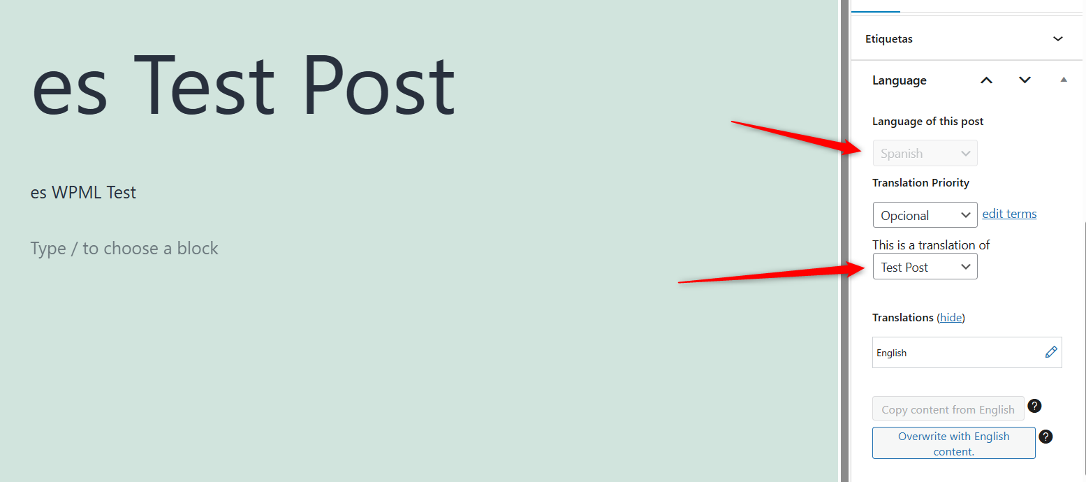

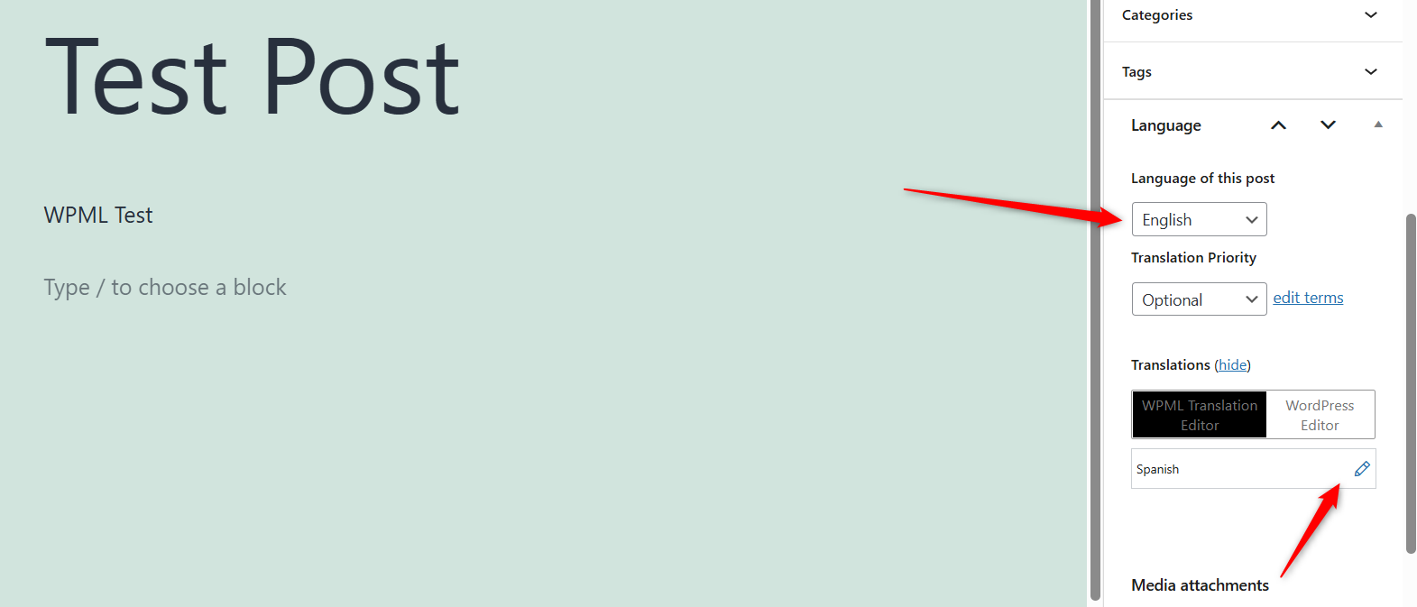

Hi Alina,
Thank you for the updates. It is possible that this post was originally created in English or German and then translated into French.
To confirm, please open the French post in the WordPress editor (as shown in the screenshot), check the Language widget (on the right side of the screen), and make sure whether it is a translation of a post (English or German) or was originally created in French.
Please refer to the attached sample images for more details.
Thanks!
Bigul

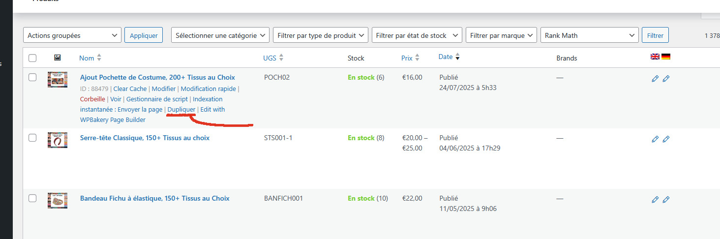

https://wpml.org/forums/topic/warning-you-are-about-to-edit-your-translation-using-the-standard-wordpress-editor/
is about PRODUCTS (not post) and about Woocommerce duplicate (not Yoast duplicate post).
-> wp-admin/edit.php?post_type=product&action=duplicate_product
