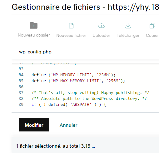

2) WPML needs a minimum of 128MB of memory to work correctly and it seems you are not meeting this requirement. This helps in preventing similar issues in the future
Kindly add this code into your wp-config.php file, right after the database information:
define ('WP_MEMORY_LIMIT', '256M');
define ('WP_MAX_MEMORY_LIMIT', '256M');

February 15, 2024 at 11:37 am #15306694
steveD-19
hi
is laready st thi config i dont know wy wpml win't see

February 15, 2024 at 1:07 pm #15307217
Alejandro
WPML Supporter since 02/2018
Hm, that's weird, but could it be that you added those lines after you opened the ticket? if you can see it in WPML > Support, then that's fine.
Otherwise, there might be something going on because the values we get are taken from your server, not really directly from something else we're doing.

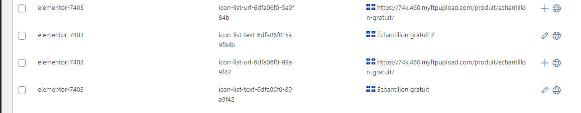

February 15, 2024 at 1:30 pm #15307313
steveD-19
see picture

ok, you should not translate content from elementor pages directly in strings translation (we'll be removing such types of strings in one of our upcoming releases, because we know they might create confusion).

1) Your translator won't indeed have access to the menus, unless they have a higher WP role for their user. this is normal and has nothing to do with WPML since the menus are translated in a different way, as explained in my last reply and actually they should just be SYNCED so there is nothing to translate there.
2) The problem here is that you're NOT translating the REAL menu, you're translating the LABELS that come from the elementor page, which might be coming from the menu.
3) I accessed your site and as i thought: the elementor template was not translated (for the header, only the footer) and also the MENU was not translated either, so what you were experiencing was not a bug, it was just that you were missing steps in your translation journey (the ones that i explained in my previous answers: https://wpml.org/forums/topic/translate-but-not-showing/#post-15307217 )
