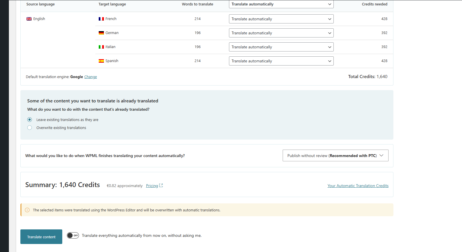

April 16, 2026 at 7:19 am #17972941
I can not confirm this. See screenshot.

April 21, 2026 at 9:17 am #17983395
I could see the issue today again, and it appears not to occur only for products.
I can see the issue even when testing only with WPML when trying to send any post to automatic translation.
I have deleted and then installed WPML again, as I was unable to see all the translation engines. This solved the issue about the translation engines, but the issue on the dashboard persisted.

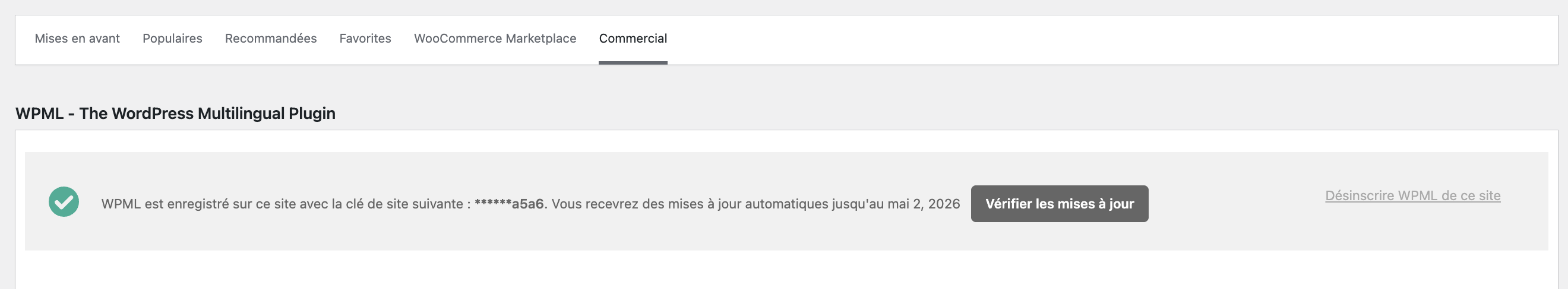

April 24, 2026 at 11:07 am #17992528
adrienL-15
Hi Andreas,
Thank you for your suggestions.
I can confirm that WPML is correctly registered on my site (see attached screenshot).
