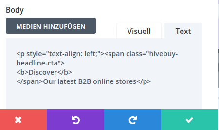

On my freshly automatically translated Site hidden link you can see that around the "Discover" Element WPML added line breaks:
<p style="text-align: left;"><span class="hivebuy-headline-cta"><br>
<b>Discover</b><br>
</span>Our latest B2B online stores</p>
breaking the layout. Without those line breaks it would work great, despite the wird custom
nesting.
Compare the original site hivebuy.com and the attached images for what I mean.
Is there any way to prevent WPML from doing this?

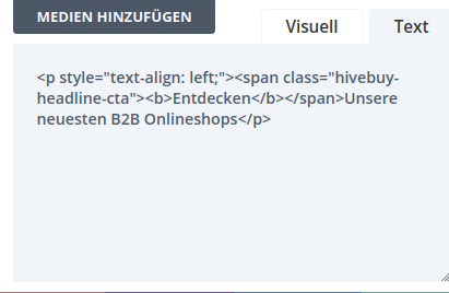

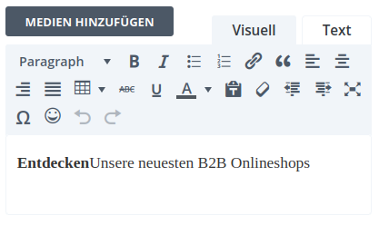

Could you share a screenshot where you are editing this module in the original German so that I can see exactly what the content is, and then I can confirm if it is the same issue as reported.
Thank you.
May 7, 2024 at 2:33 pm #15602703
bettinaF-3
sure here you go - it is a bit of a hack, but it would be nice to get it to work the way it is 🙂
Best,
Holger
May 8, 2024 at 7:56 am #15604658
Nigel
WPML Supporter since 02/2016
OK, so it does appear to be a variant of the same problem.
Based on the suggested solution for the few other clients affected by this I have made a change to the settings for your account in the translation editor which should fix the problem of br tags being inserted unnecessarily.
Could you please re-send the problem page for automatic translation and check the results? (You will no longer need the CSS workaround.)
Let me know how it goes, thank you.
May 8, 2024 at 9:50 am #15605263
bettinaF-3
Hey Nigel,
thanks - this didn't work, but now instead of adding <br/> it adds actual line breaks in the document. Without the hotfix, the box still shows up as broken. See screenshots for what's happening.
Any further ideas? 🙂
