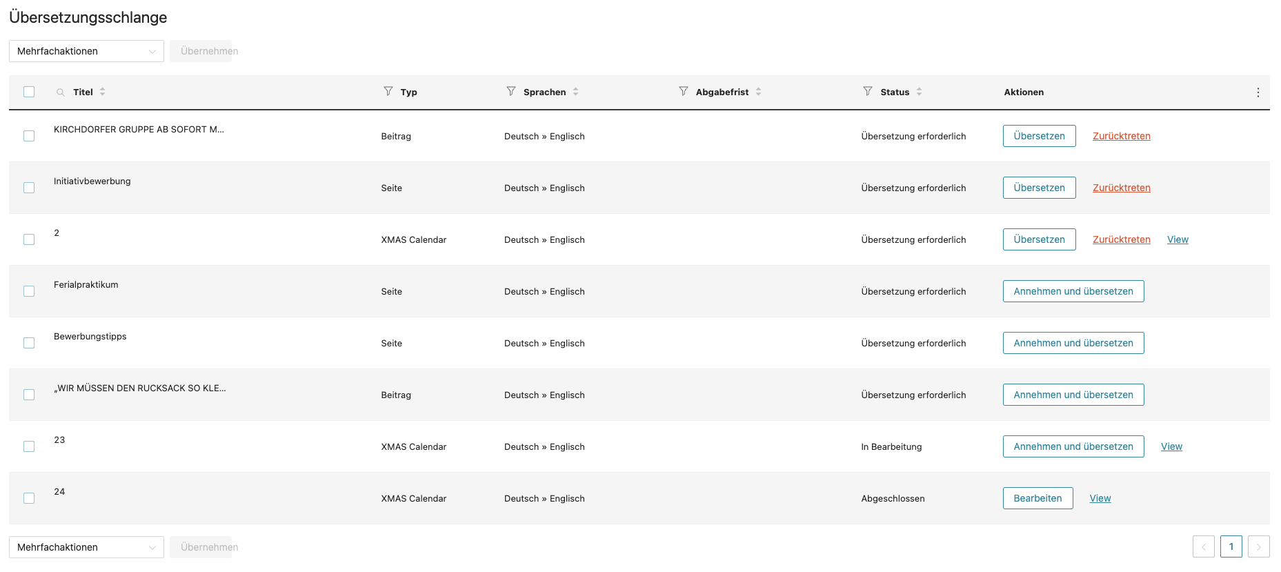

When I try to translate a post or page, the translation doesn't always appear in the translation queue, making it impossible to proceed with the translation.
Furthermore, it frequently happens that a page is 100% translated. However, when I reopen the translation, a part of it is missing. Often, it's also not possible to complete the translation, even though it shows 100% translated.

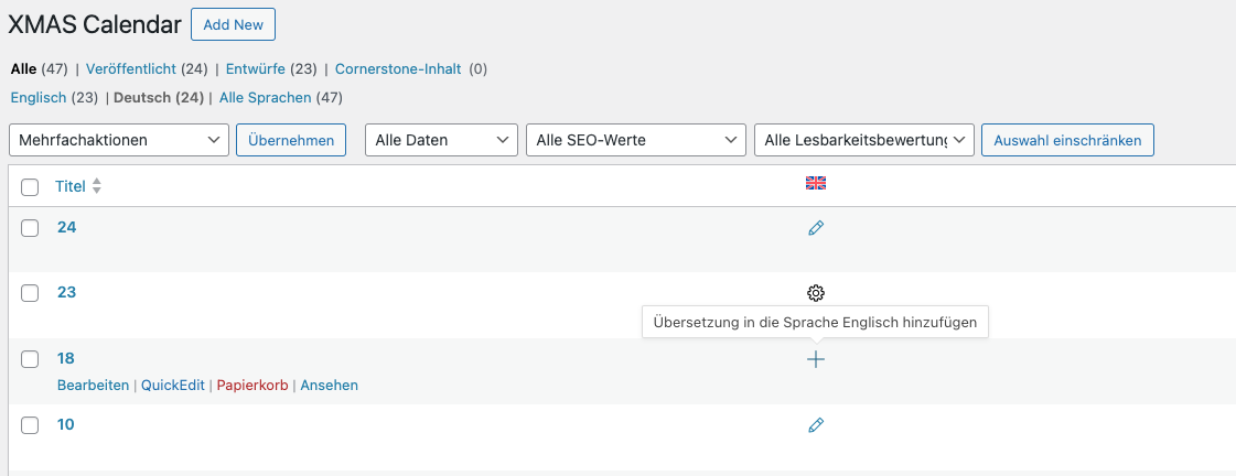

Right now it is not possible to add a new translation for a plugin with a custom post type.
When clicking on the + icon for the entry "18" the translation management page is shown, but the page is not listed.

The page WPML > Translations will show the list of jobs. When you click on the Plus icon in the table list of the post type, it does not create the job and won't display on the Translations page.
Please follow steps I mentioned above to add a new job to translate the post type.
- WPML > Translation Management > Select the post "18" and send it to translation.
- WPML > Translations > Take the job and translate it.

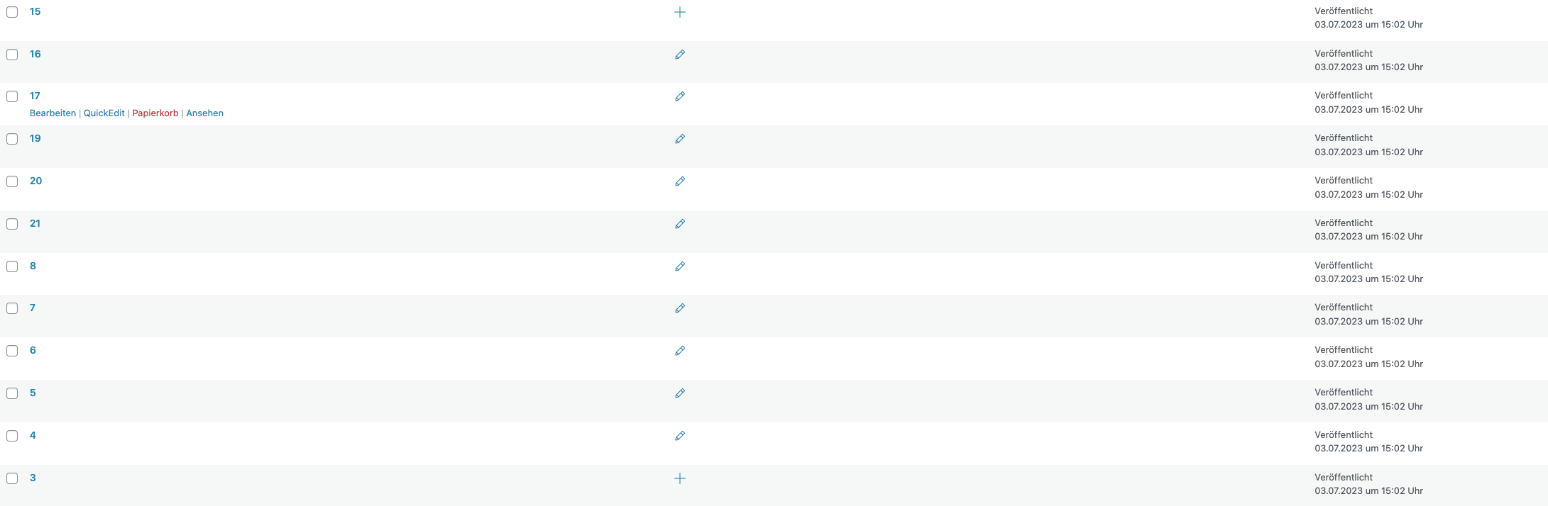

It is a database corruption issue and I've fixed that issue on your site. Now you can translate post 18 properly, please check the screenshot attached.

The post 18 has ID 23, when you access the database, table icl_translations and search for element ID 23, you will see the translation ID group "trid".
Search for the trid, you will see the post and its translation has different element IDs and the same trid. But on your site, the element ID of the translation is NULL, which is not correct.
Then I did steps below to fix this:
- Delete two entries in the table icl_translations (post 18 and its translation).
- Now the post 18 does not have a language, I go to WPML > Support > Troubleshooting > Click on the button "Set language information" to set the default language for post 18.

November 23, 2023 at 8:29 am #14904575
yvonneR-7
We need assistance with Advent calendar doors 3 and 15, we're encountering the same issue again.
Thanks.
November 23, 2023 at 9:14 am #14905255
Long Nguyen
WPML Supporter since 02/2022
I fixed the issue with two posts and the same steps above. You can see the issue in the screenshot attached.
Thanks.
