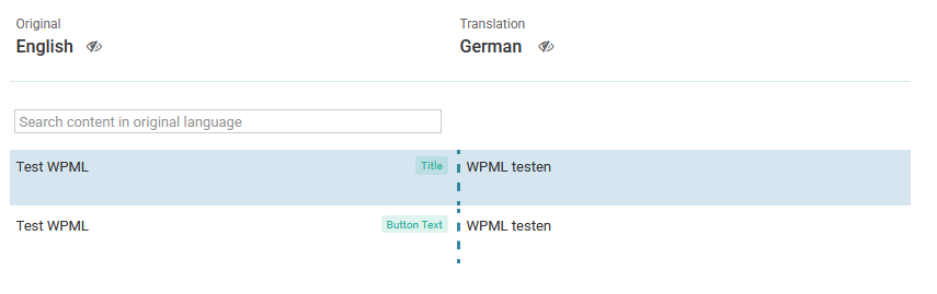

I am trying to translate shortcode contents on my site using WPML. I can see and translate the fields in the translation editor, but the translations are not applied to the site. I have already tried changing the content of the original site (English) slightly and updated the translation, but the modified content is still shown in English on the translated site (German). The shortcodes are included in the custom XML configuration, which allows me to see them in the translation editor. This issue occurs with shortcodes such as 'tatsu_toggle' with the attribute 'title' and 'tatsu_button' with the attribute 'button_title'. The issue can be seen on this page: hidden link.
The translation of shortcode contents is not being applied to the translated site. Despite successful translation and saving, the English content is shown on the German site.
Why are the translations of shortcode contents not being applied to the site?
How can I ensure that the translated content is displayed correctly on the translated site?

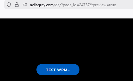

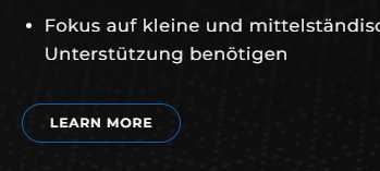

I cloned the page and translated it from scratch and got the same behavior. I also made a page only with the button, with the same behavior.
In the editor I am able to translate the button text, but it is not shown in the translated page.

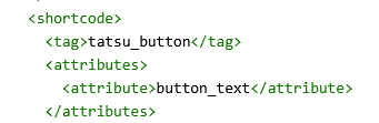

The shortcode was registered as follows:
<wpml-config>
<shortcodes>
<shortcode>
<tag>tatsu_button</tag>
<attributes>
<attribute>button_text</attribute>
</attributes>
</shortcode>
<shortcode>
<tag>tatsu_toggle</tag>
<attributes>
<attribute>title</attribute>
</attributes>
</shortcode>
</shortcodes>
</wpml-config>

Unfortunately this chat apparently eliminated the indents in the xml-code, but they are there and are correct. That is why I see the shortcode in the editor.

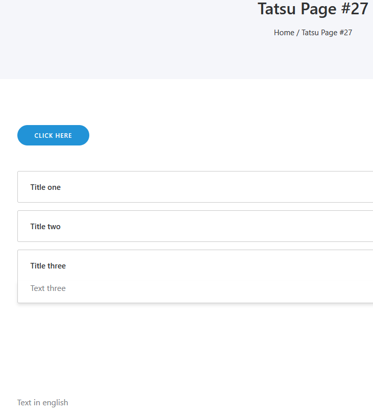

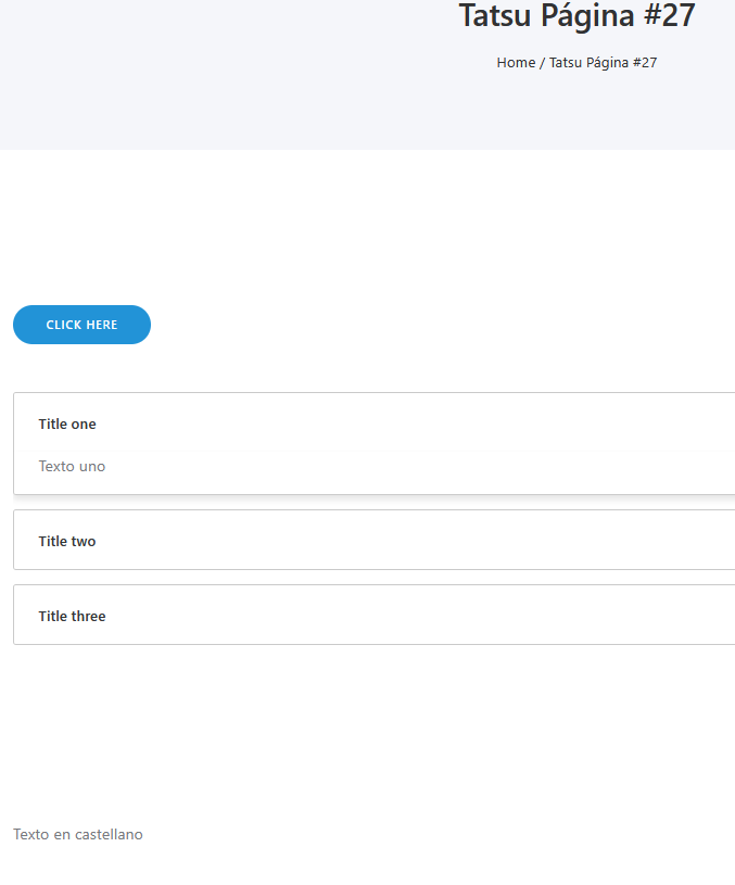

I wanted to translate the page you made, but forgot to put the custom xml first. So I made a new page from scratch, "Tatsu Page #27", and translated it into Spanish.
The custom xml worked fine, since I only see the content that I wanted to be translated and not all the parameters of the shortcodes, that should stay the same, since every tatsu shortcode should now be registered.
At the end I was able to replicate the issue. The button text and the titles of the accordion toggle are being shown in the translation editor, but not in the translated page.
