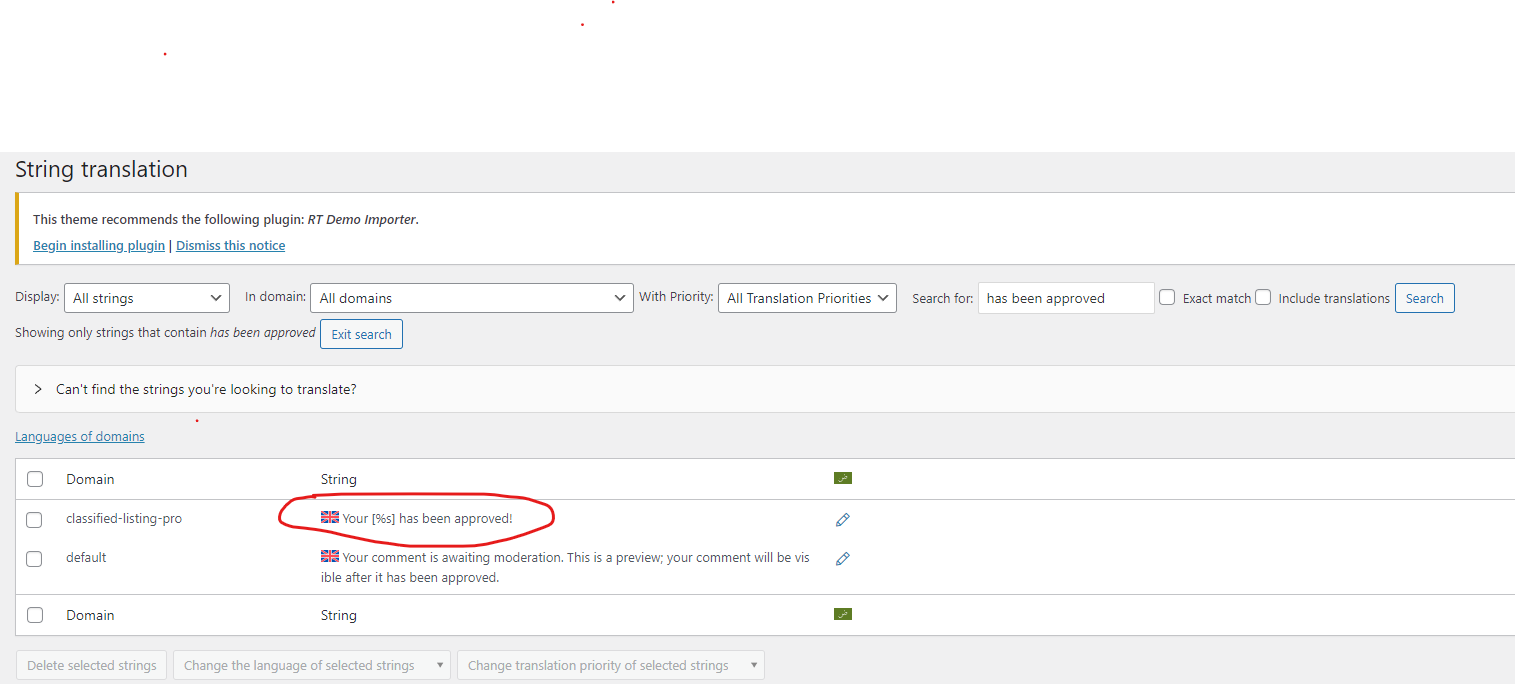

One of the strings was translated with no issues. But, I noticed yesterday it's no longer the case! I'm not sure what happens. In the past few days, I only updated WPML to the latest version. I also changed one of the settings temporarily but put back to the default value the same day. Other than that, there were no modifications at all in relation to WPML.
The string value affected is " Your [%s] has been approved!" it is used as a Notification message for my WordPress theme app, if you check now, it's translated to Arabic on the backend. However, when sent as a notification, I receive the English version only. The title of the notification "Congratulations!" is also facing the same problem. Both strings (title + text) are received in the English version while my app and website are in Arabic by default.
However, another string "You have a new Message." is also used as a notification in the mobile app, but it's working fine. I receive that in Arabic without any issues.

Links for the strings with the issue:
Link for the same type of string but working fine:
