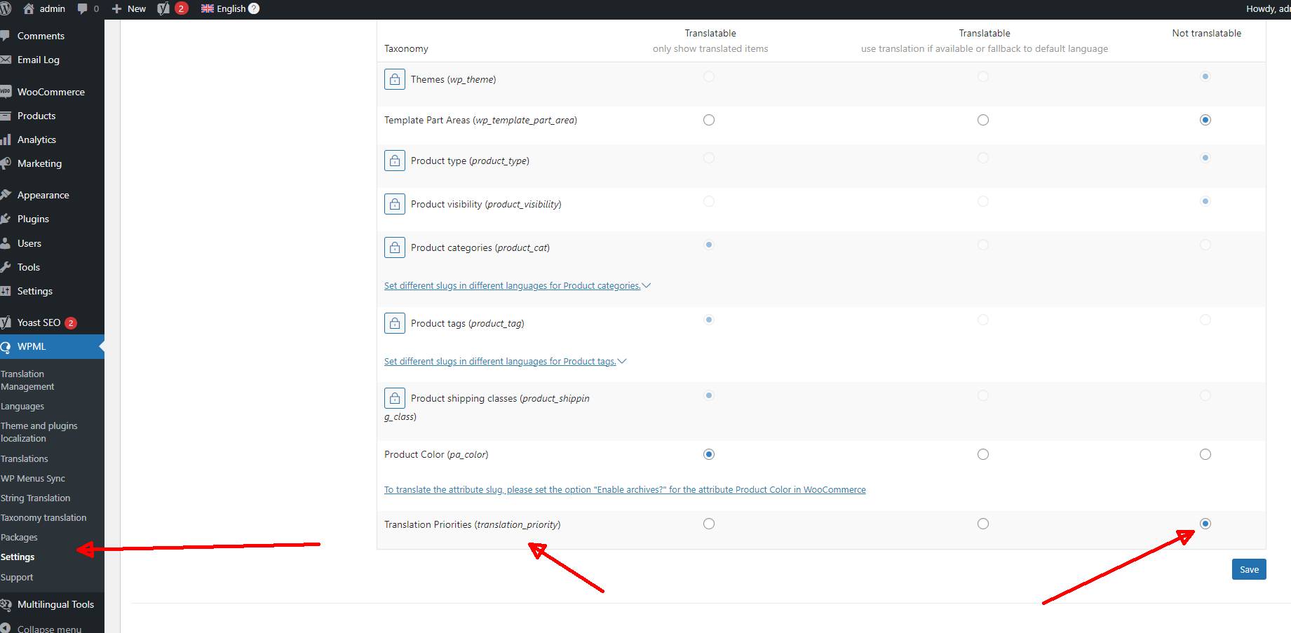

July 20, 2023 at 2:40 pm #14073513
Bruno Kos
I created a feature request in our system, perhaps it gets traction.
There is also another option instead of using your filter - you can disable translation priorities taxonomy translation abilities here.
However I'm not sure if this will work because it would only make it non-translatable, the same action would not remove already existing translations for it, neither would unregister taxonomy as your hook does it.
