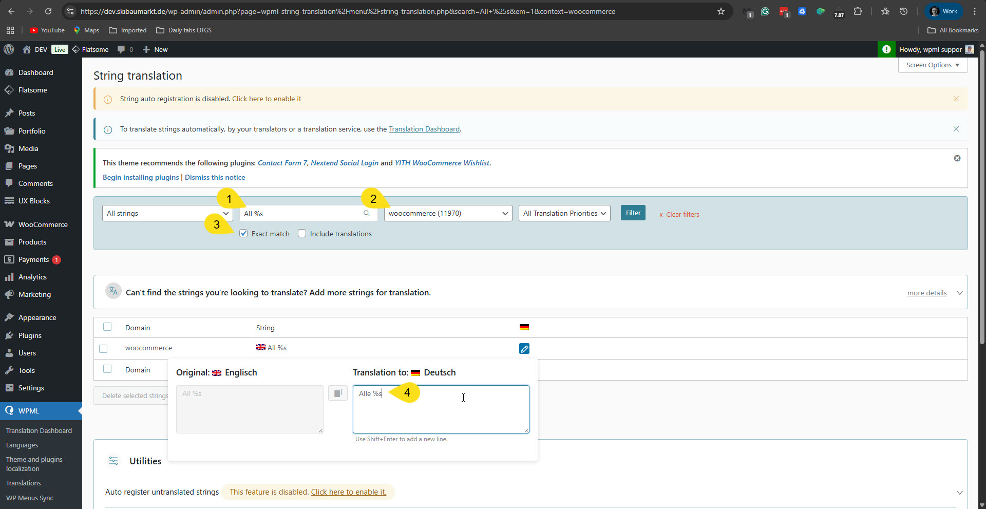

If you're experiencing a fatal error when using PHP 8 with the WPML Multilingual & Multicurrency for WooCommerce plugin, and the error disappears when the plugin is deactivated or when using PHP 7.4, the issue might be related to a specific string translation.
We recommend the following steps to resolve this issue:
1. Navigate to WPML -> Strings Translation.
2. Search for "All %s" under the "woocommerce" domain with "Exact match" checked.
3. Edit the German translation to include an "s" after "Alle %".
4. Press Enter to save the change.
This adjustment should resolve the fatal error. Please check your site to confirm that the problem is solved.

I've found the source of the fatal error and fixed it also on your site. The problem was with the translation of the string "All %s" into German. In German, it was missing the "s". So this is what I did to fix the problem:
1. Go to WPML -> Strings Translation.
3. Edit the German translation and add "s" after "Alle %".
4. Click Enter to save the change.
Please see the attached screenshot.
There is no fatal error on your site now.
Can you please confirm that the problem is solved?

thank you so much! this solved my problem. great!
