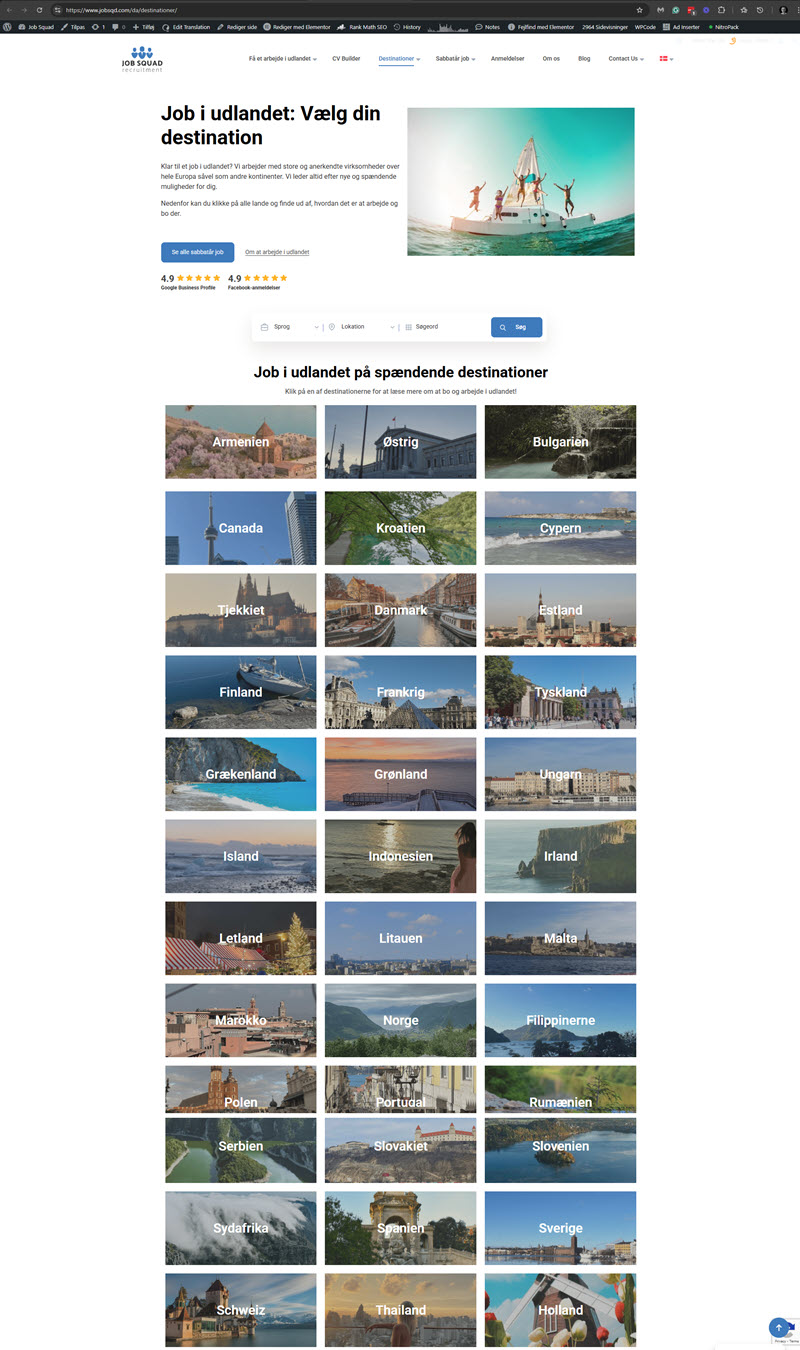

We recently updated our website and encountered an issue with the images on the Norwegian version of our "Destinasjoner" page (link: hidden link).
Despite following the recommended steps, all images are now showing incorrectly. We have made sure to press the necessary options as advised, but the issue persists.
Could you please assist us in resolving this issue and ensuring that the correct images appear on the Norwegian version of the page?

The problem is with all the 'In progress' translations, like the Norwegian translation. Please see the attached screenshot. You need to complete these translations, and it should fix the problem. You can see that translations that are completed, like the hidden link translation works, and the page shows alright.
In addition, I also clicked the start button in WPML -> Settings -> Media translation. Duplicating many images in other languages would take a while, but if any missing images are in the other languages, they should be duplicated at the end of the process. Please see the attached screenshot.
Please finish the 'In progress' translations. At the end of this process, you should see the pencil icon next to the Norwegian language, like you can see now next to the Danish, Dutch, and German languages. Then, the Norwegian page should look like the English page.

I just checked this page hidden link in Danish, and it looks all right. Please see the attached screenshot. The design is like the original page, and all the images of the countries are there.
Can you please confirm that it is all right now?
Thanks,
Itamar.
