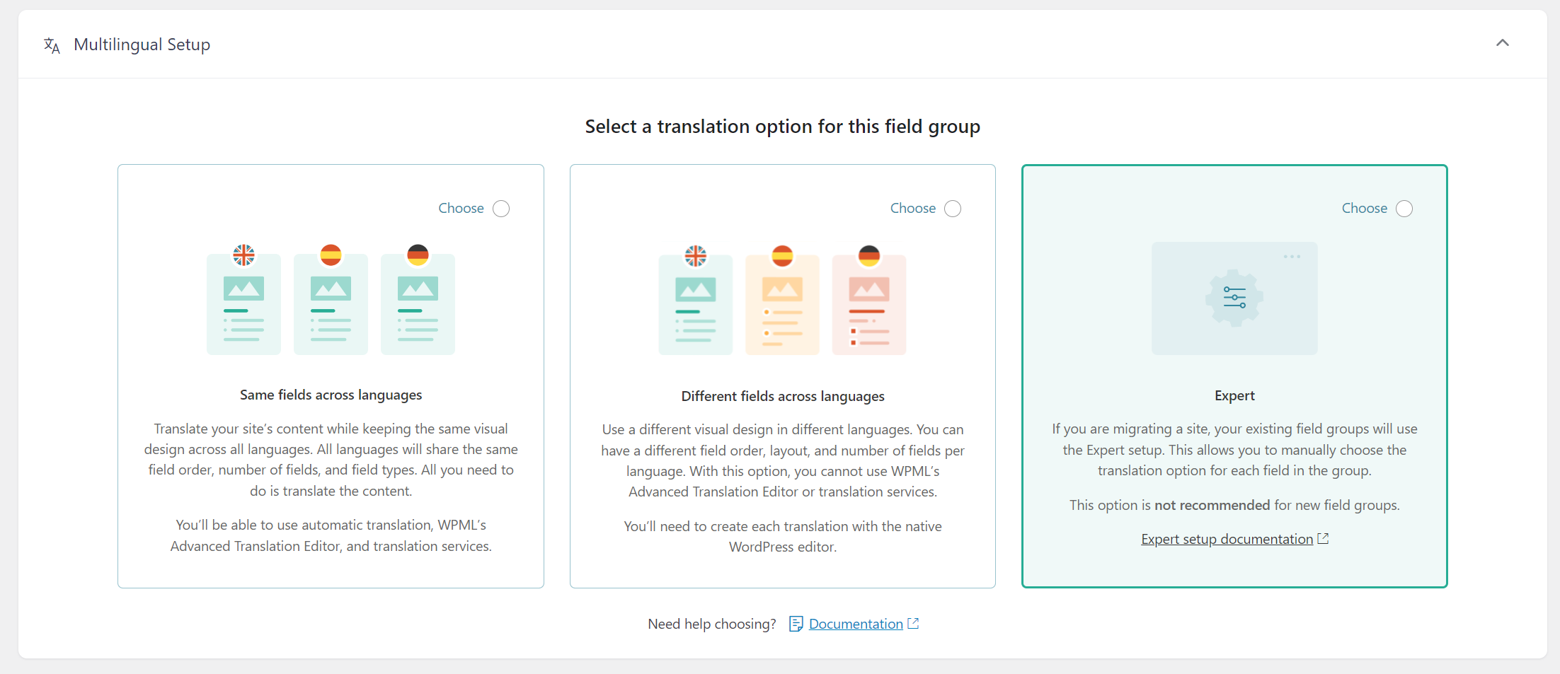

I'm noticing you didn't run the ACF setup, and no option has been chosen.
Please refer to our ACF documentation here https://wpml.org/documentation/related-projects/translate-sites-built-with-acf/ and once you set the option you prefer, try to do a small edit to the home page and resave the translation.

February 15, 2024 at 2:30 pm #15307705
Laura
WPML Supporter since 05/2018
You need to go ACF > Field group and open the field group you're interested in, you'll see the 3 images in the screenshot from my previous post and you need to choose an option.
