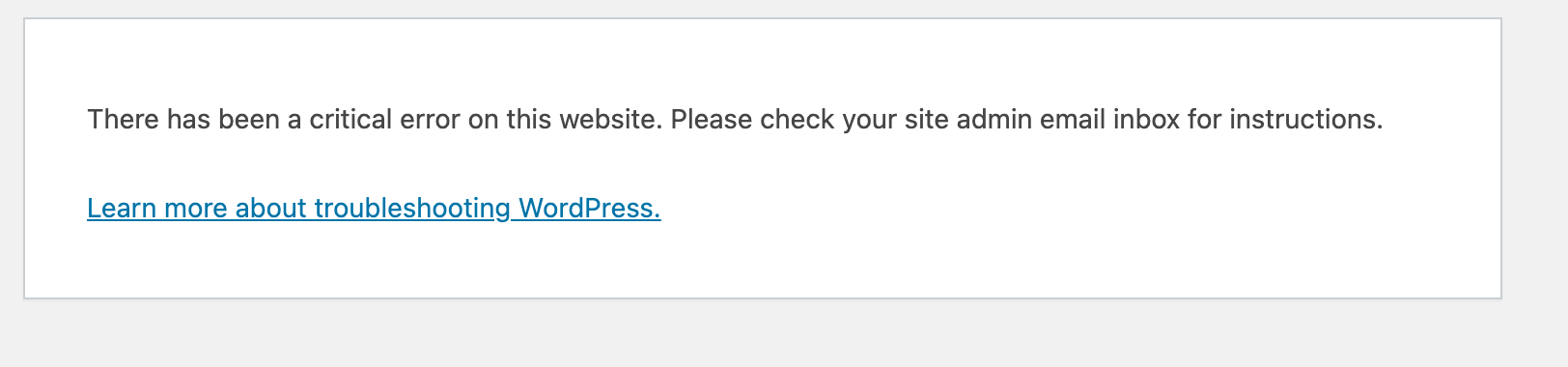

I am trying to: activate WPML
I expected to see: my dashboard
Instead, I got: fatal error and can't access my dashboard

August 31, 2023 at 2:39 pm #14321747
