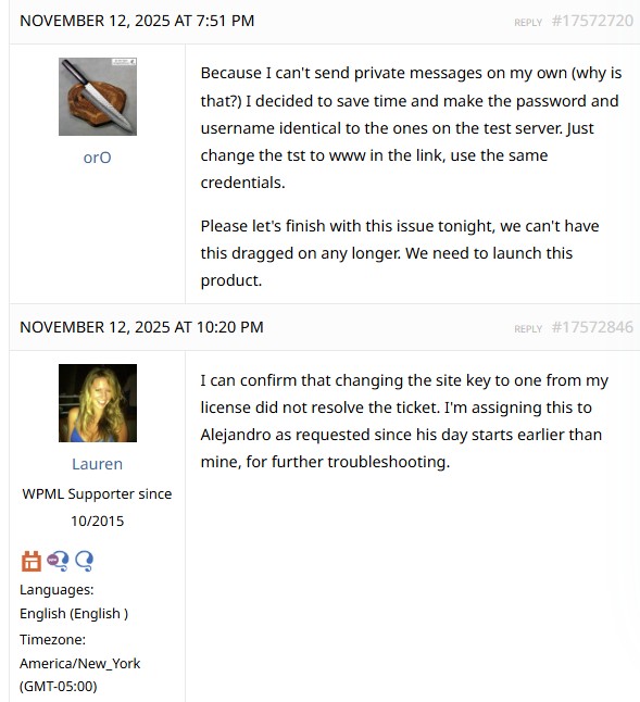

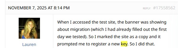

I'm attaching proof that you did use your own key for all testing and showing that you do already have access to the live website for 2 days now., Please talk to Lauren, she'll explain everything.
I'm not returning things to the original state. The broken live website will be available to you soon, the TST will be overwritten.

2) About the key I'm talking about the last version of the staging. that's the one that didn't have any key (in fact I kept seeing the "missing key" error in the different logs of that site) not the one from the first staging site you created.
Lauren told me and I could confirm in this forum ticket that you then proceeded to remigrate the live site to the staging site, so the one I'm talking about is the one I could access which is the second version. I hope this makes sense to you?
