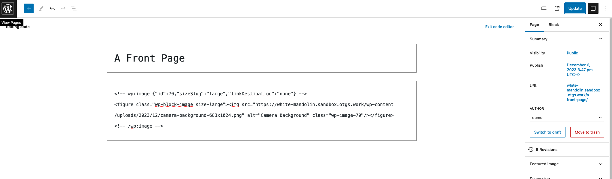

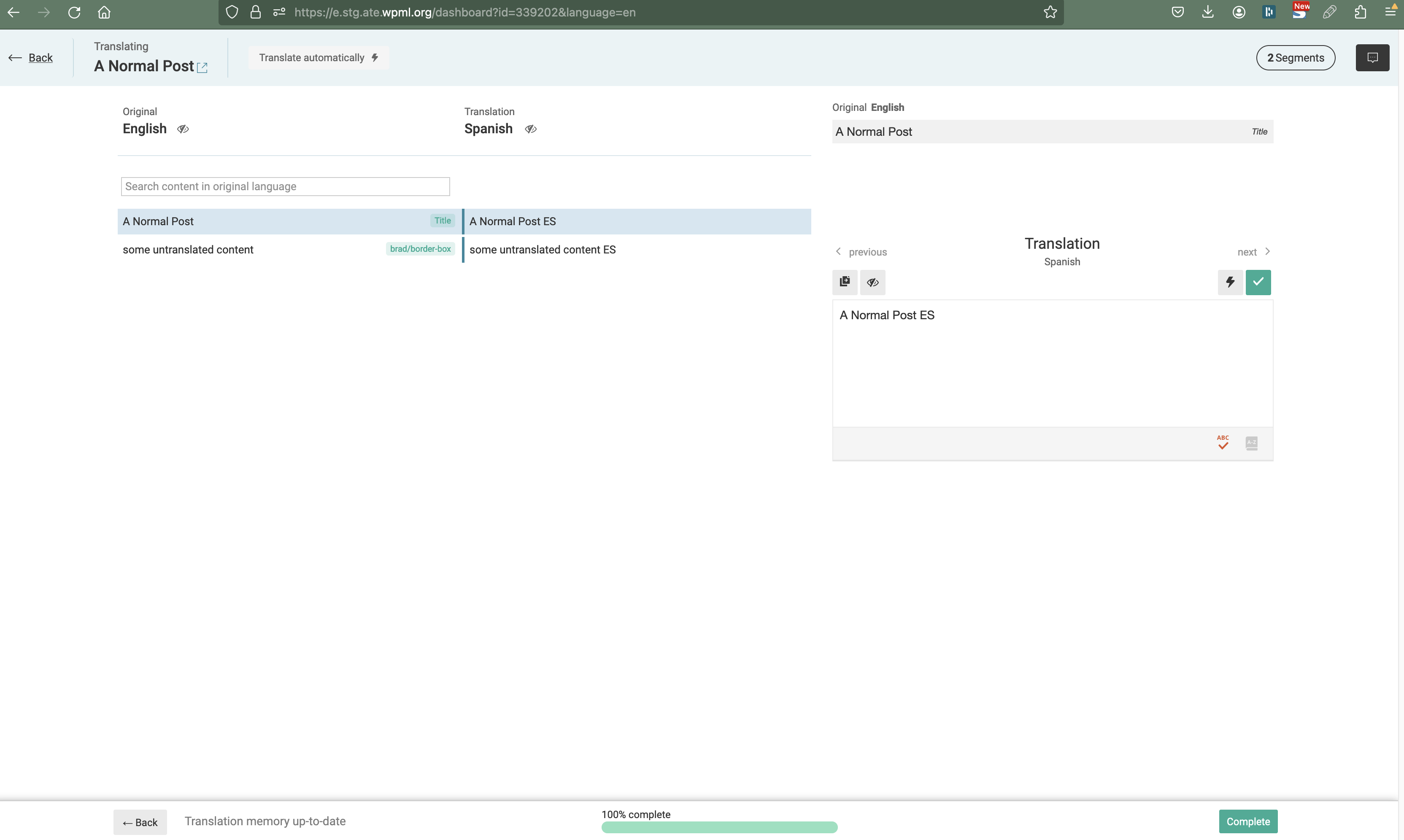

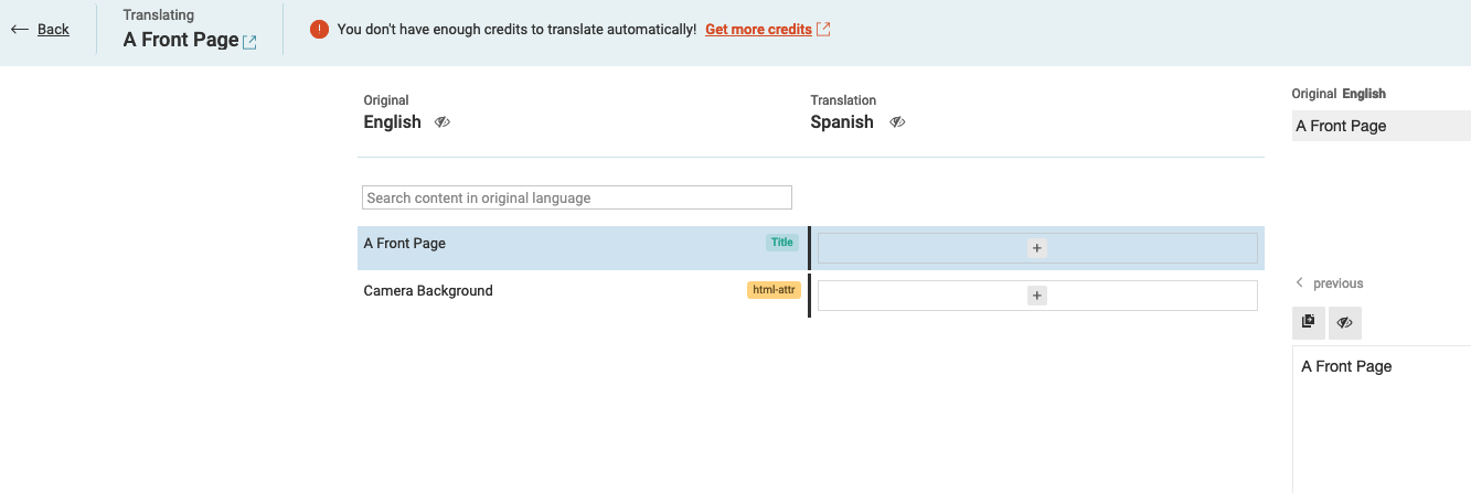

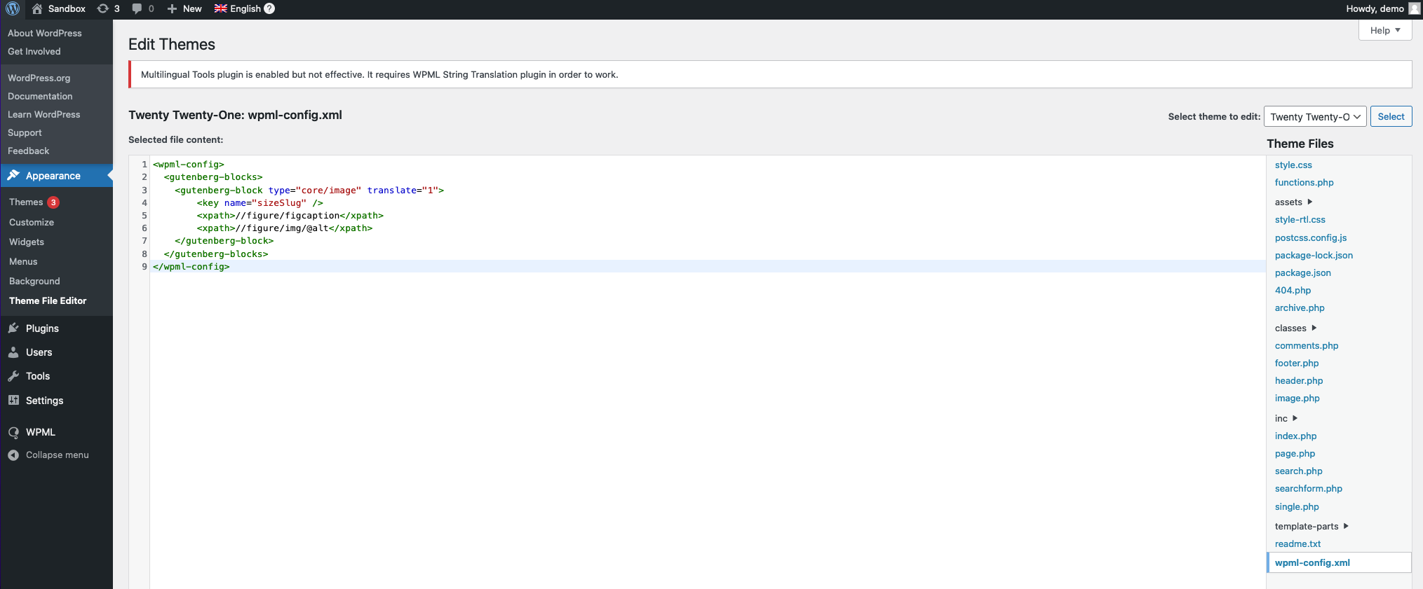

In the sandbox site, I can get the img example from the documentation to work, but if I try to translate the object on the wp:img tag, it's not being found for translation (see images). It might be that the sizeSlug is a bad example of a field for translation, so if you could add a test plugin with an attribute that is found for translation, that would help. Thanks!

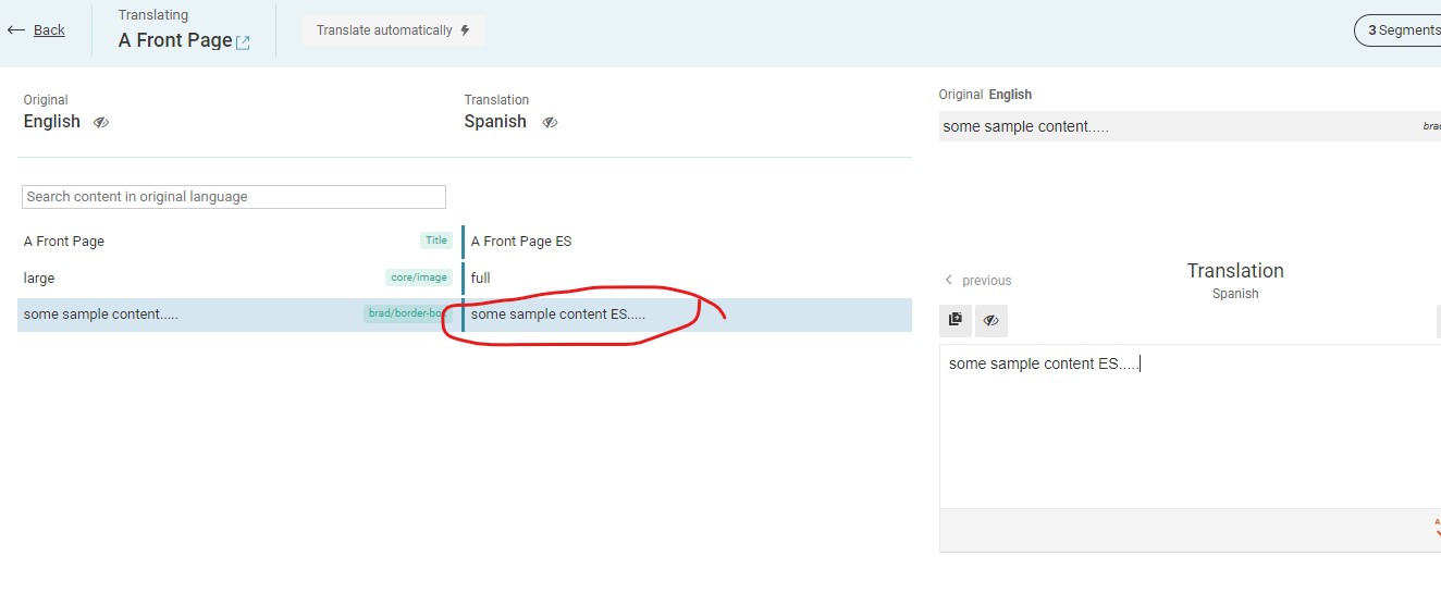

You need to activate the plugin String Translation to register the block attribute for translation. I also added a custom block Simple Box with the same format and you can check it on the sandbox site. Please check the screenshot attached.

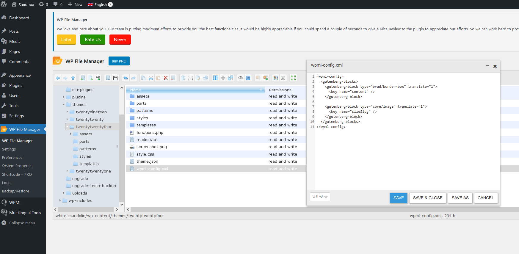

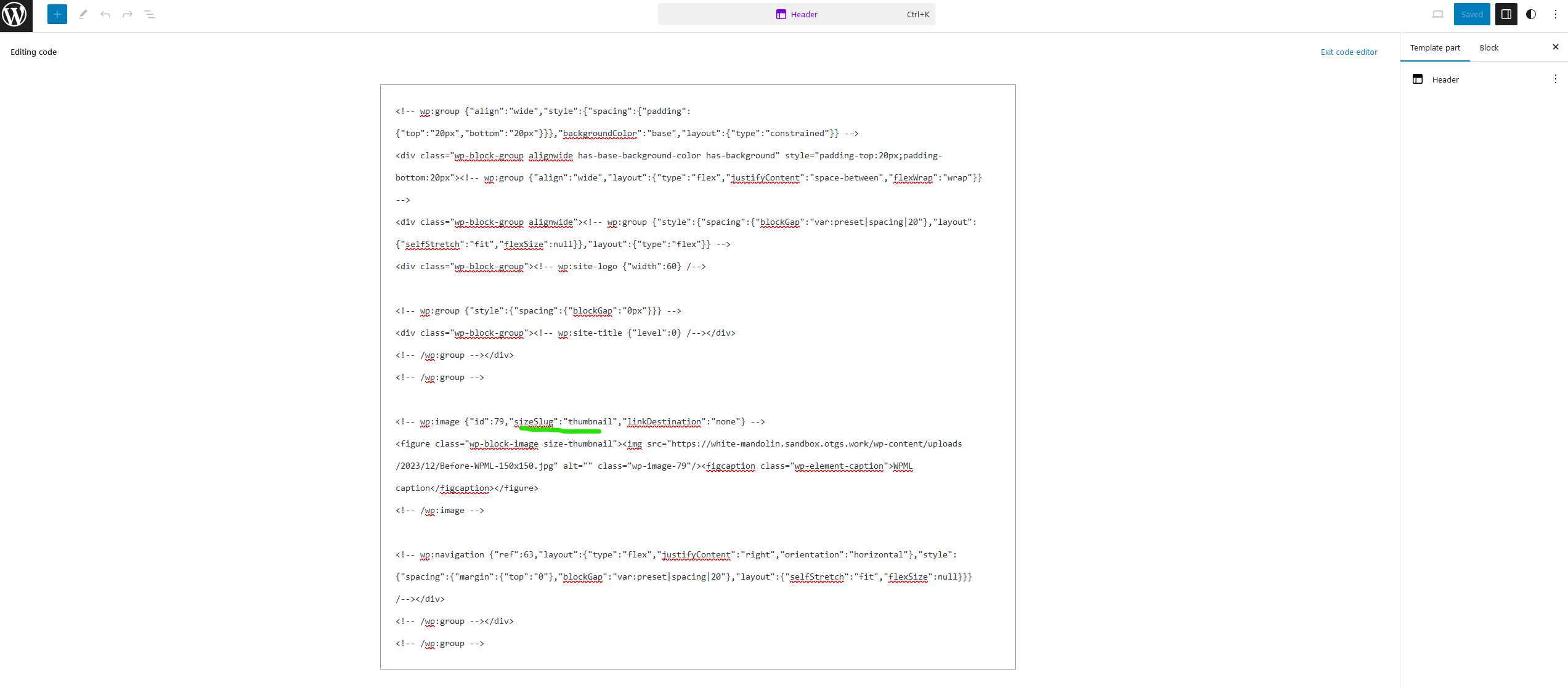

Ah, great! The simple box is also really helpful. Now, because the site we're actually working on uses a FSE theme with template parts, I have duplicated wpml-config.xml into the twentytwentyfour theme and added an image to its header template part.
As you can see, wpml doesn't seem to pick up on the translatable content in that template part. Is this a limitation related to template parts?

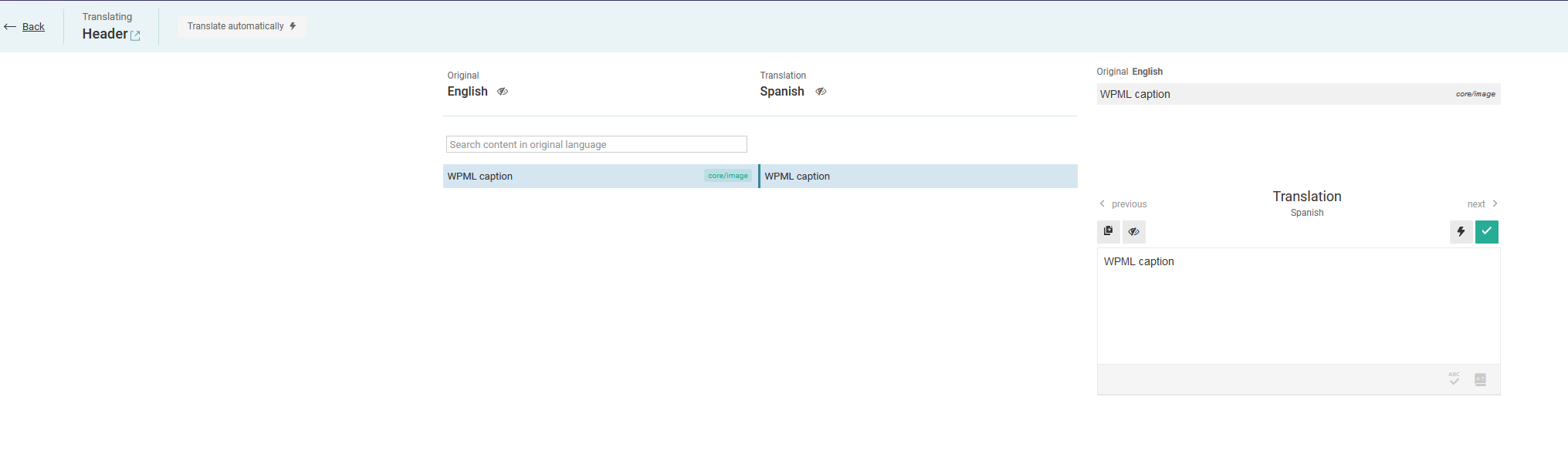

Maybe you copy the file wpml-config.xml after translating the header. I make a small change to the header template > Save > Update the translation and the sizeSlug value available in the translation editor as well. Please check the screenshot attached.

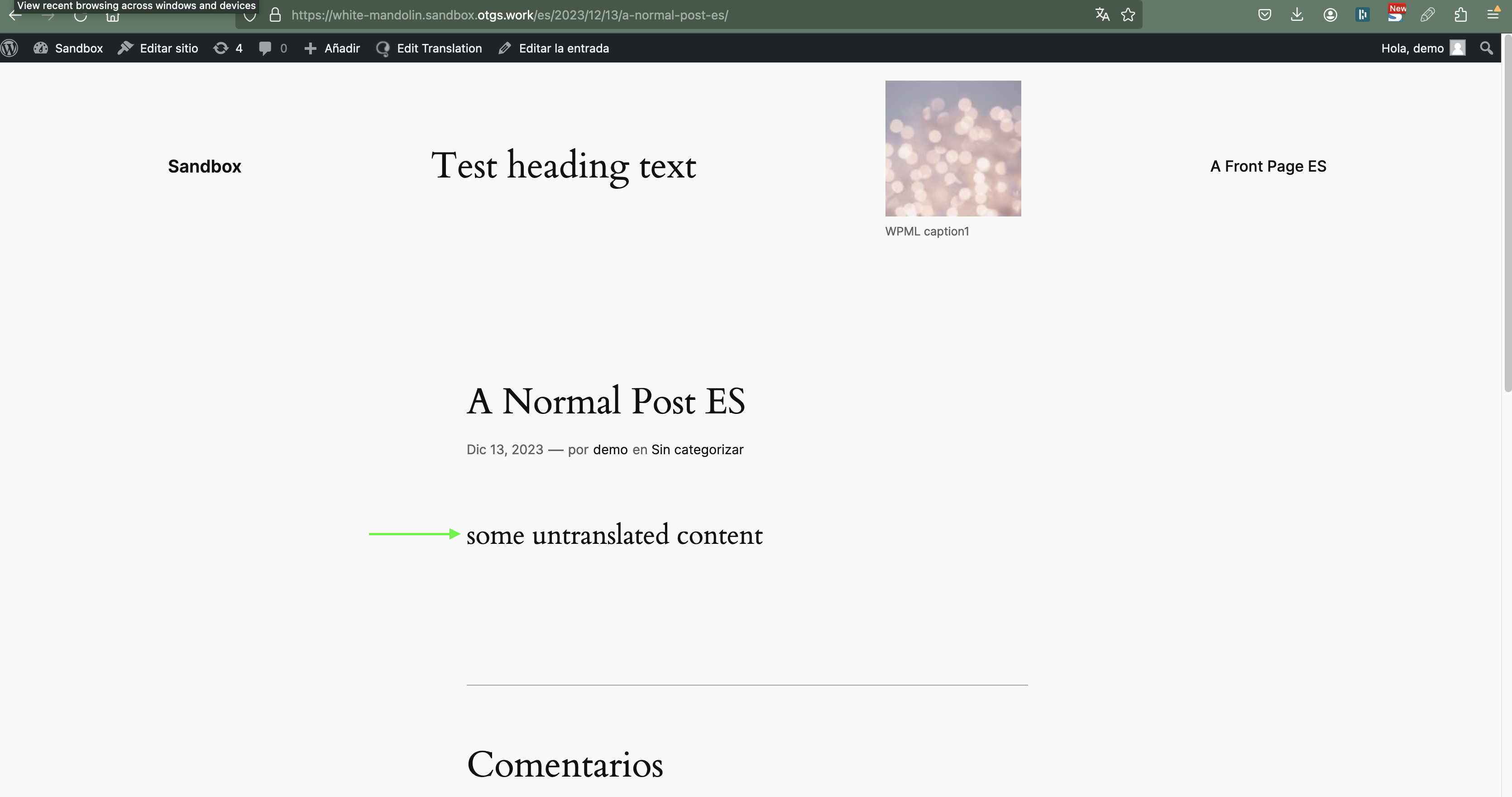

I'm sure that's what happened, thank you for the explanation. Block attributes are recognized for translation now, but the brad's custom block content is not actually being translated on the page.
In the images you can see the custom content in the translation, and then you can see how it's not translated on the page.

The text is translated because the content is recognized by WPML, that's why you see it in ATE, as well as, in String Translation.
For the frontend, just like a theme and other parts being shown as translated, this particular text coming from the plugin, needs to be taken care accordingly for the display (or rendering). I'll recommend checking following guides:

Hi Waqas, thank you for your help. I modified your test block so that it would use wp.i18n and call __(), but I'm still not seeing translations of that block's content on the front end. Is there something wpml-specific I need to do to ensure that the call to __() sees translations generated by wpml?

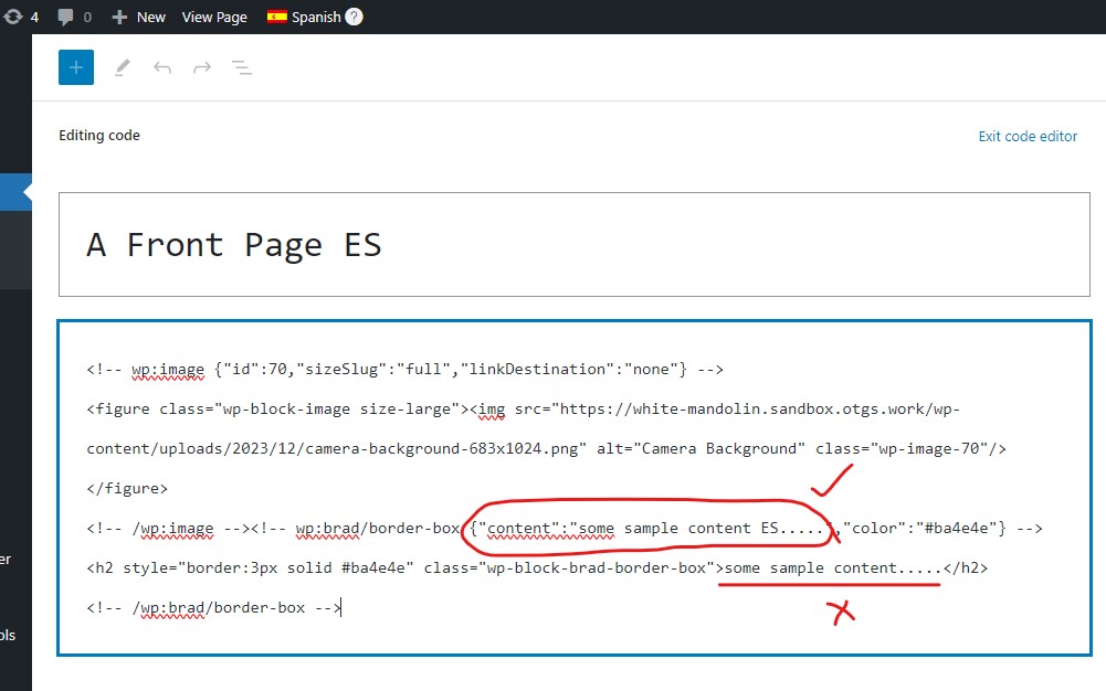

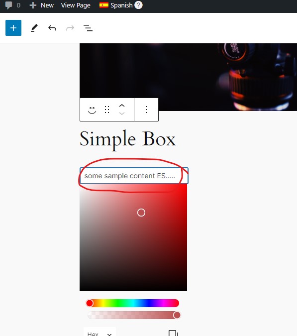

Well that __() is doing its job great, as well as, WPML (see attached).
As you can see that blocks props.content has the translated content. You can observe this when you switch to Spanish from top admin bar and switch to code editor.
Please note that when you switch to Spanish translation from top admin bar, while editing the page, you may notice that block becomes corrupted (in visual editor mode). So this is an indication that something wrong with block's coding.
Unfortunately support for custom coding is out of scope of this forum.

The test block I was working with wasn't rendering the content because I was.translating the attribute itself but not the place where the attribute was rendered (inside an h2). In my own code, I'm rendering dynamically using React, so there is no real difference between the two.
