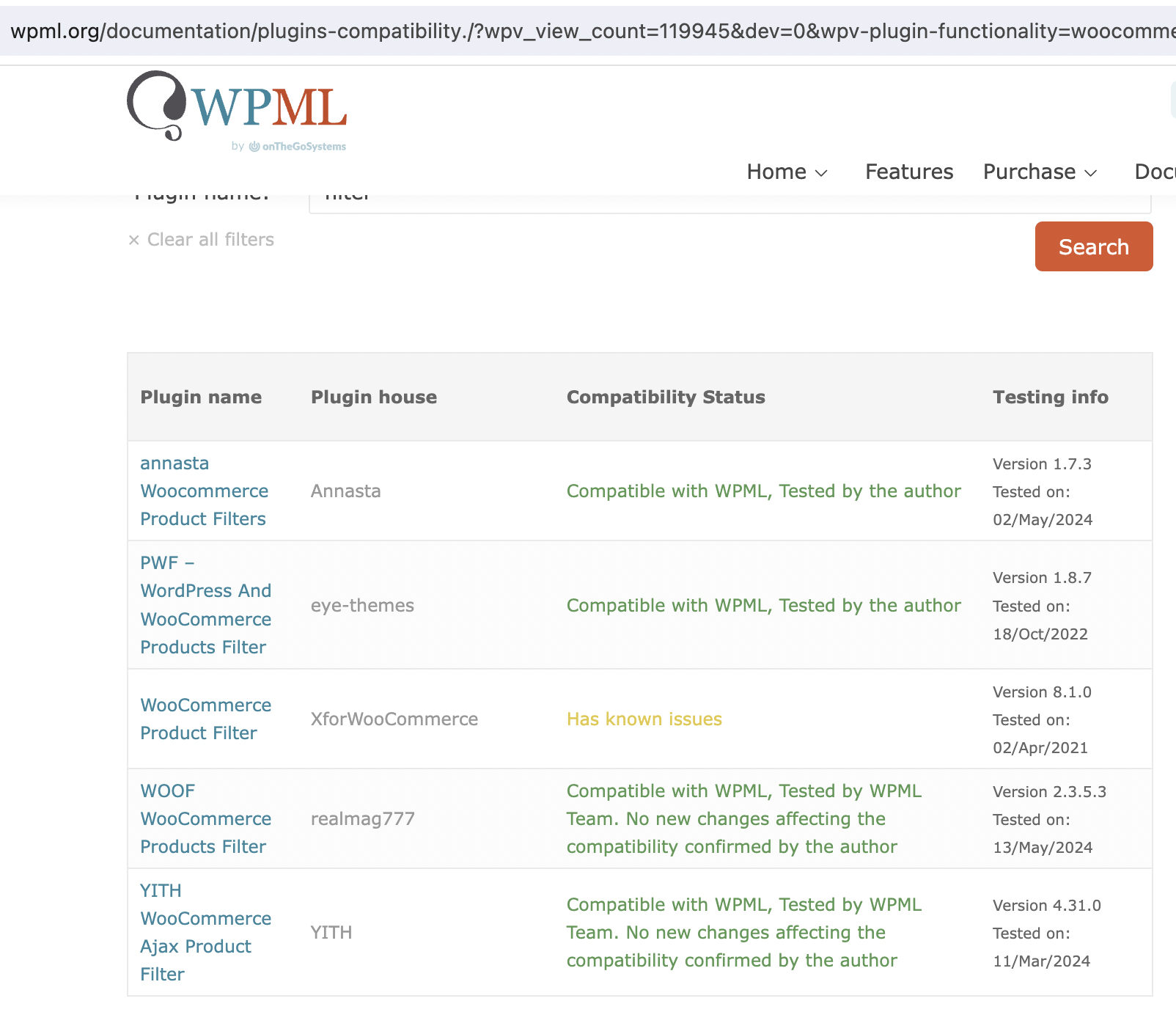

After further investigation, I have found that Husky might need additional configuration to work properly with WPML. Even though they say it on their website, we at WPML haven't verified the plugin compatibility and cannot confirm it's compatible with WPML.
Please check their documentation on the subject: hidden link
Since the additional settings have to be done in Husky, I advise you reach out to them, to check how you can make your multilingual categories compatible with their plugin.
I do not really know why "Husky might need additional configuration to work properly with WPML" if they put down that "WOOF is absolutely compatible with WPML".

By the way, "annasta Woocommerce Product Filters" - is not working at all on our website:)
I apologize for the confusion. Since they changed their name to HUSKY and in our compatibility list it still says WOOF, I got mistaken. Thank you for understanding.
