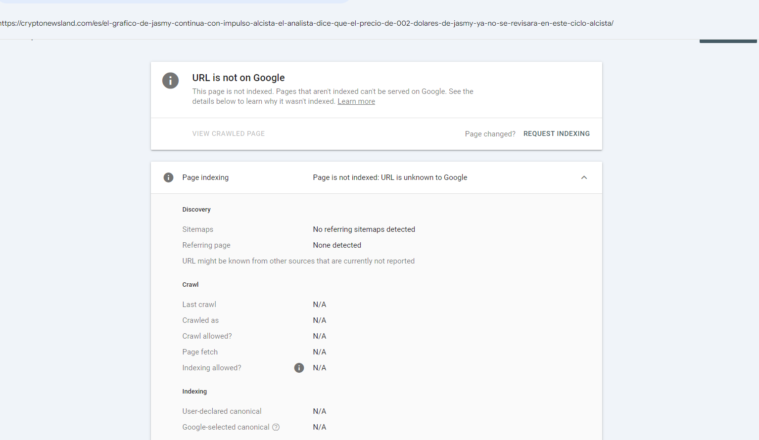

September 29, 2024 at 12:40 pm #16233161
mohamedA-116
Hello Team I facing a problem where translate articles are not indexing on google
September 29, 2024 at 7:37 pm #16233797
Itamar
WPML Supporter since 02/2016
Does this URL exist on your site?
Can you please send me the link?
Please share your site's Debug information. You can read about it here.
Itamar.

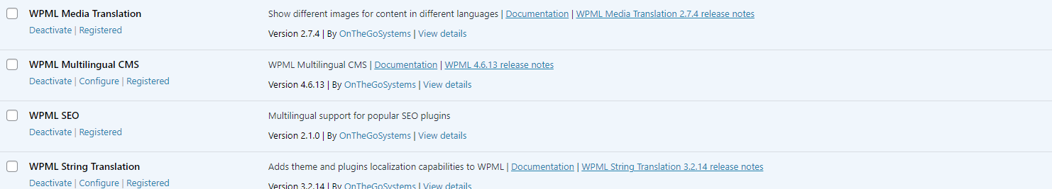

October 2, 2024 at 5:32 am #16243305
mohamedA-116
Hi Waqas,
I’ve updated WordPress and installed the WPML SEO plugin.
However, articles in languages other than English are not being indexed by Google, even though everything else seems to be working fine. Could you please check an article in a language other than English to investigate further?
Thank you.

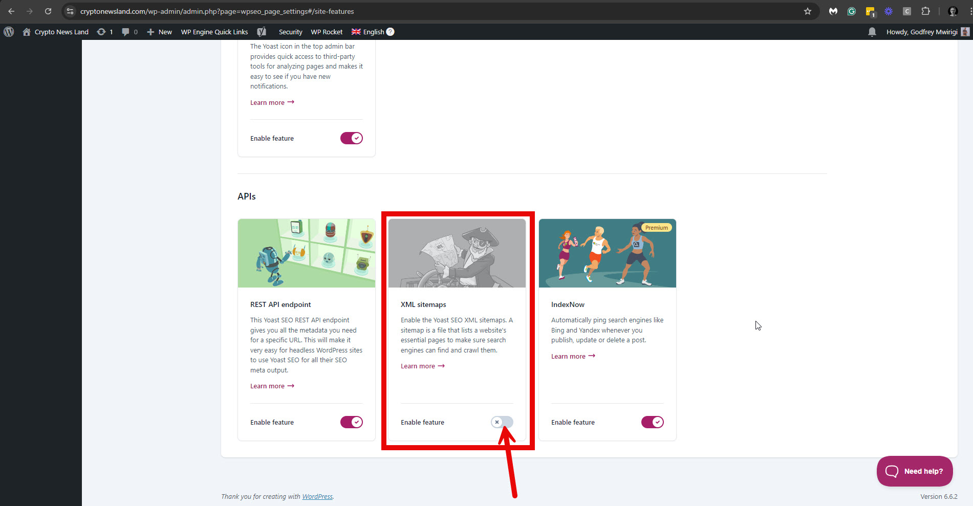

October 6, 2024 at 5:48 pm #16258303
Itamar
Your site does not have the Yoast XML sitemaps feature activated. Please see the attached screenshot. The sitemap feature is essential for getting Google and other search engines to index your site.
A good XML sitemap acts as a roadmap of your website that leads Google to all your important pages. XML sitemaps can be good for SEO, allowing Google to find your essential pages quickly, even if your internal linking isn't perfect.
The above is from the following link to the Yoast article about the sitemap feature. Please read it and activate the sitemaps feature on your site. It will surely improve Google's indexing of your site.
Please also read our guide on working with WPML and the Yoast plugin.
https://wpml.org/documentation/plugins-compatibility/using-wordpress-seo-with-wpml/
Please be aware that you must request Google to crawl your site. Please read about
Please be aware that crawling can take a few days or weeks.
Itamar.

October 7, 2024 at 4:29 pm #16262949
mohamedA-116
Hi Itamar,
Thank you for your follow-up.
We have tried the "Request Indexing" option and successfully indexed a few pages manually. However, we believe this process should be automatic, rather than needing manual intervention each time.
Could you advise on how to ensure our site is indexed automatically, without relying on manual requests?
October 8, 2024 at 12:32 pm #16265401
Itamar
The only thing I can think of is that you must request Google to index/crawl your entire site.
I'm sorry, but there is no building option for this in WPML. Such an option is also impossible, as Google controls it.
Please let me know if you have any further questions.
Itamar.
