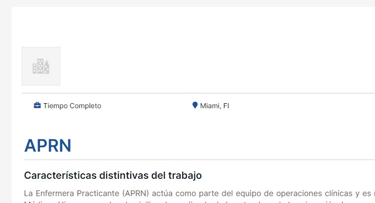

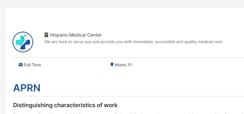

Thanks for the information, however there is missing information within the posts that are not shown, such as some images and icons and text, in the attached images you can see what I mean.
You can also see it from:hidden link
And an Apply Now button that is not in Spanish: hidden link
Thanks.
