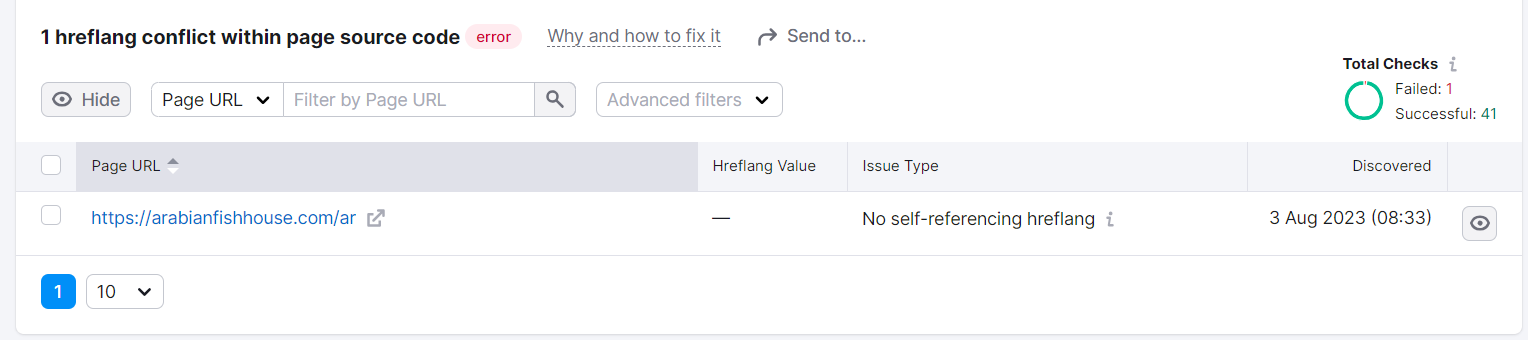

I am receiving an error in the SEMRush site audit report, the error is No self-referencing hreflang. Please find the attached screenshot and help me with this to resolve the issue.

Welcome to the WPML support forum. I checked the source code of hidden link (the url in your screenshot) and everything seems to be in order.
1. Hreflang:
As you can see you have the hreflang for AR and EN + the "x-default" that points to your main language EN.
<link rel="alternate" hreflang="ar" href="<em><u>hidden link</u></em>" />
<link rel="alternate" hreflang="en" href="<em><u>hidden link</u></em>" />
<link rel="alternate" hreflang="x-default" href="<em><u>hidden link</u></em>" />
2. Canonical
Further down you have the following code coming from Rank Math PRO:
<link rel="canonical" href="<em><u>hidden link</u></em>" />
Everything is in order so here are my recommendations:
1. Please install our add-on WPML SEO that will make Rank Math and WPML fully compatible
You can download all our plugins directly from your WPML account.
- Go to https://wpml.org/account/downloads/
- Click on "Download WPML manually" to see all plugins and download them
- In your WP dashboard, go to "Plugins > Add new" and use the button at the top of your screen to upload the .zip file
2. Purge all your caches (including server caches and CDN)
3. Rescan your site with SEMRush.
If the issue persist, please ask for more details and share them in this ticket.

August 10, 2023 at 12:46 pm #14182453
lijiJ
Hi, I contacted the SEMRush support, please find their reply
If we compare the link that our crawler found, it's hidden link without the trailing slash at the end. Our bot will compare the exact URL and mark it as an error, since the / is not in the normal path!
August 10, 2023 at 5:20 pm #14184371
Nicolas V.
Languages: English (English ) French (Français )
Thanks for the details. You shouldn't have both URLs (with and without trailing slash).
I see that you're using Rank Math for your SEO. They actually have a tutorial to make sure all your URLs have this trailing slash: hidden link
