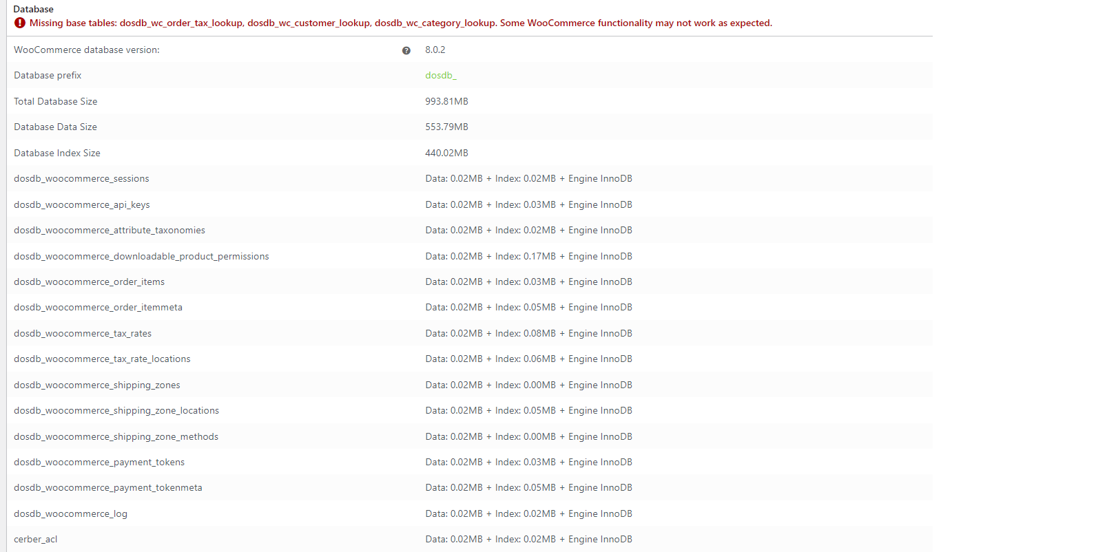

August 29, 2023 at 12:06 pm #14306839
abdullahA-31
Dear WPML team
I face problem in woocommerce plugin after download the version (8.0.2)
can you see the system report that you can see below:

### Database ###
WC Database Version: 8.0.2
WC Database Prefix: dosdb_
Total Database Size: 993.73MB
Database Data Size: 553.74MB
Database Index Size: 439.99MB
dosdb_woocommerce_sessions: Data: 0.02MB + Index: 0.02MB + Engine InnoDB
dosdb_woocommerce_api_keys: Data: 0.02MB + Index: 0.03MB + Engine InnoDB

August 30, 2023 at 6:35 am #14310177
abdullahA-31
Dear WPML
Can you see the attachment file image that appear some tables not exist
how can I fix this issue?
Best regards
New threads created by Long Nguyen and linked to this one are listed below:
https://wpml.org/forums/topic/some-woocommerce-tables-do-not-exist/
