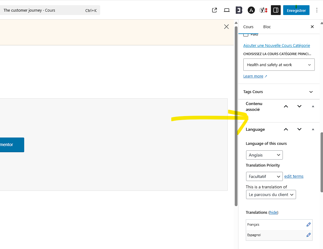

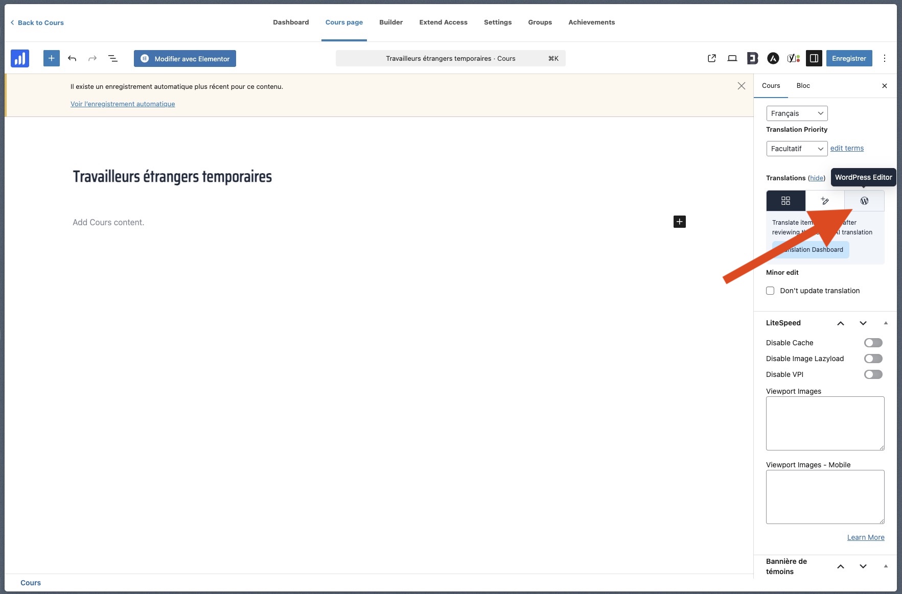

October 8, 2025 at 7:54 am #17466038
Lucas Vidal de Andrade
WPML Supporter since 11/2023
Andreas is away for today, so I'm stepping in temporarily. I checked the hidden link course directly, and it seems that the "WordPress Editor" options wasn't properly set, as recommended in the link Andreas shared. Here it is, again:
First, you need to choose the option (check the image), than you can properly add the content and save it. Please let us know how it goes. Make sure that all content connected to this course is also translated.

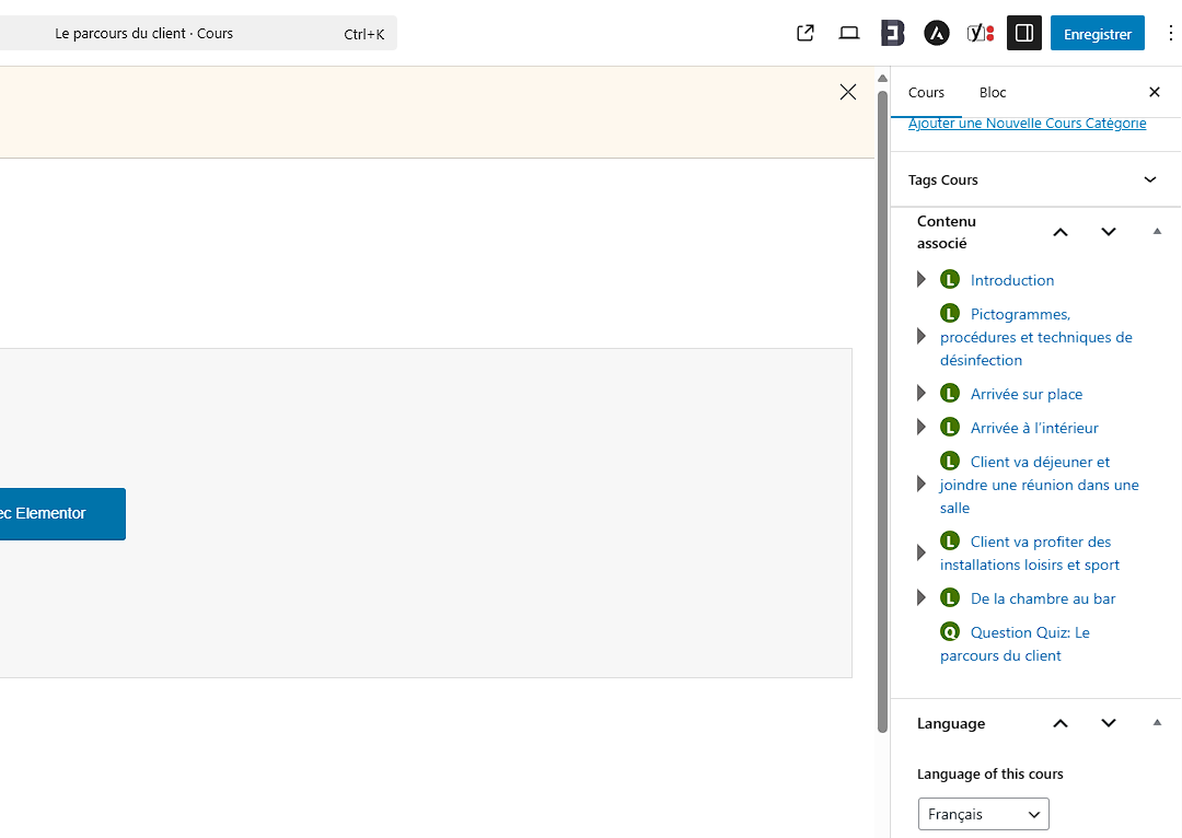

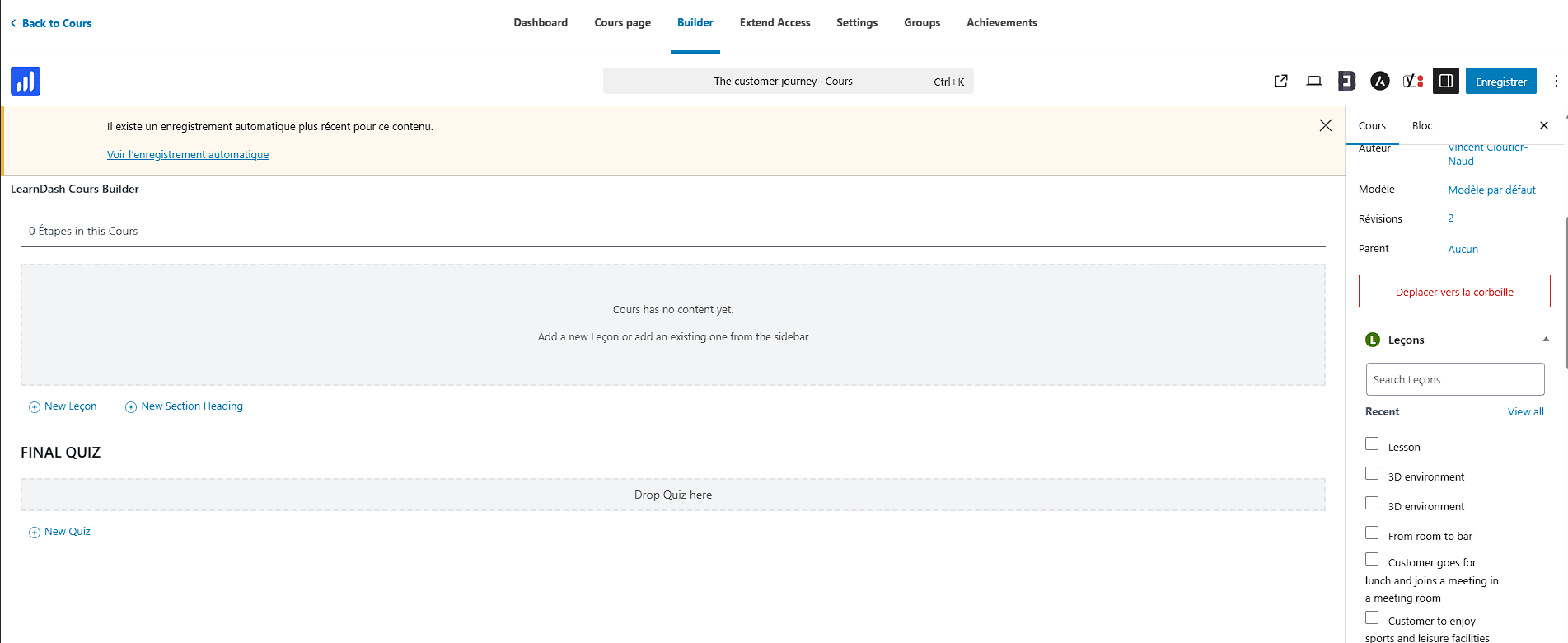

October 9, 2025 at 7:56 pm #17472870
There is still no course content (lessons, quizzes) added to the translated course. See screenshots.
You will need to use the "Builder" tab and add these contents to the English course.

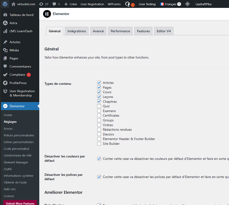

After opening the translated course in Elementor and then closing Elementor again, the issue was partly solved, but the translated course had the wrong layout and was missing the progress bar.
I would suggest disabling Elementor for the courses and their contents in Elementor's settings.
After that, update the original courses, and then update the translations.
