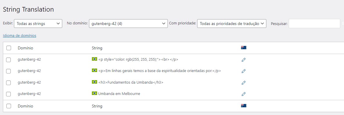

This image below shows the string gutenberg-42 (header home) is translated. However, it is not displaying in the header, which means that is the only section and footer that this behavior is happening, it seems this is a lost reference in some database table that might be fixed by your team.

After downloading the backup file and restoring your site on my local site to investigate the issue, I see there is a way to translate the content in the PageLayer template. Please follow steps below and see how it goes.
1. Go to WPML > Settings:
- Custom Fields Translation section > click on "Show system fields" > search for the field "pagelayer" and set the preference of all fields to "Copy", please check this screenshot
- Post Types Translation section: set the post type "Pagelayer Templates" to "Translatable - only show translated items".
- Custom XML Configuration tab: add the code below to register the widget Icon box heading for translation
<wpml-config>
  <gutenberg-blocks>
    <gutenberg-block type="pagelayer/pl_iconbox" translate="1">
      <key name="service_heading" />
    </gutenberg-block>
  </gutenberg-blocks>
</wpml-config>
2. Go to Pagelayer > Theme Templates > Translate the templates on your site.
The content of the Pagelayer template is saved to the database as a Gutenberg block so you can follow the documentation below to register a block content for translation
https://wpml.org/documentation/support/language-configuration-files/#gutenberg-blocks
Look forward to your reply.
