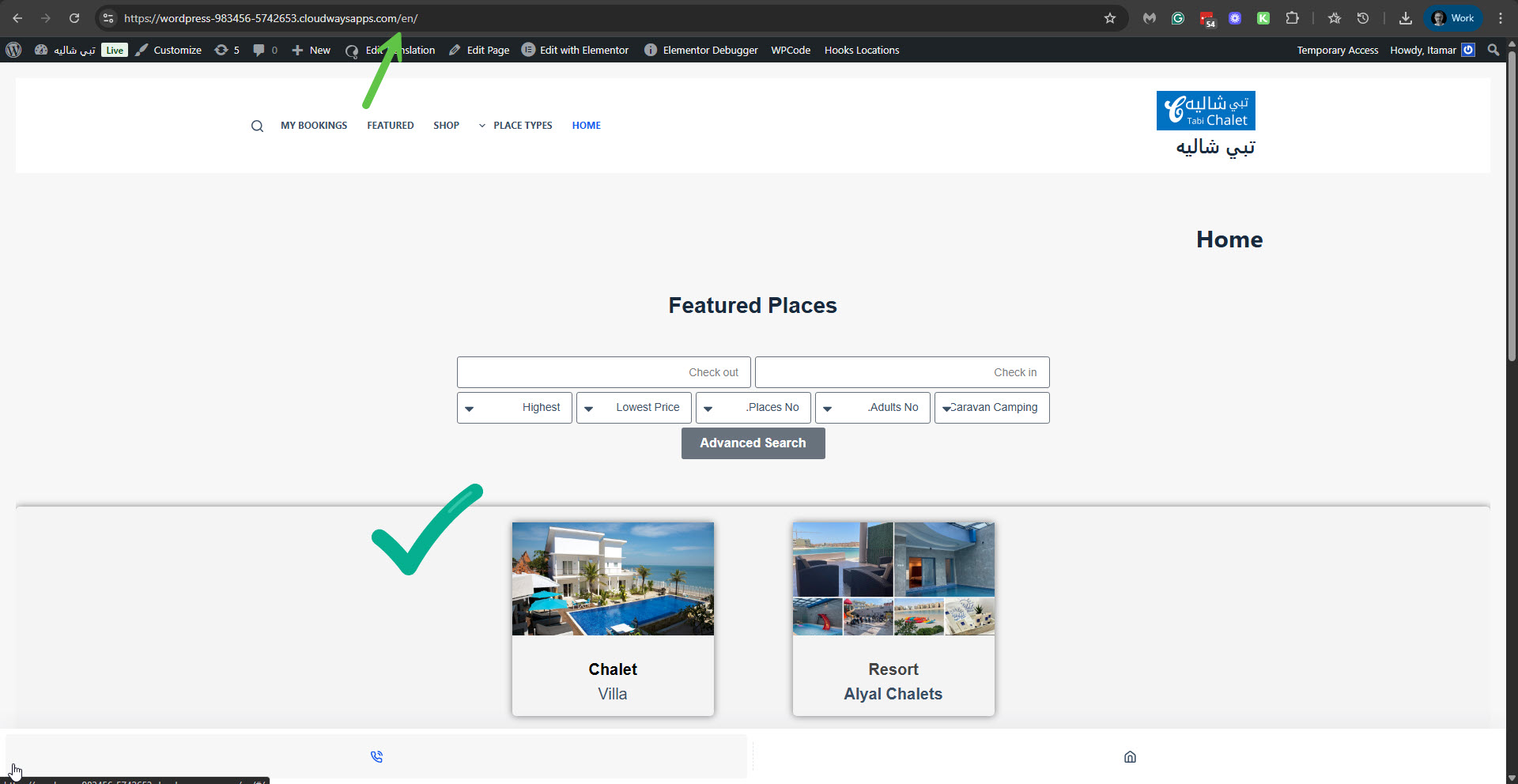

A. Regarding the fatal error that occurs when switching the language into English. I changed the theme from your custom Blocksy Child theme to the parent Blocksy theme. I also updated the Blocksy theme to its latest version. Now the English language is loading without a fatal error. Please see the attached screenshot en-is-ok.jpg. The reason for the fatal error lies in the custom code you added to the Blocksy child theme. Please review the code. If you find any piece of code that might cause this problem, and you have any questions about it and how you may write the code differently, we will be happy to advise about it.

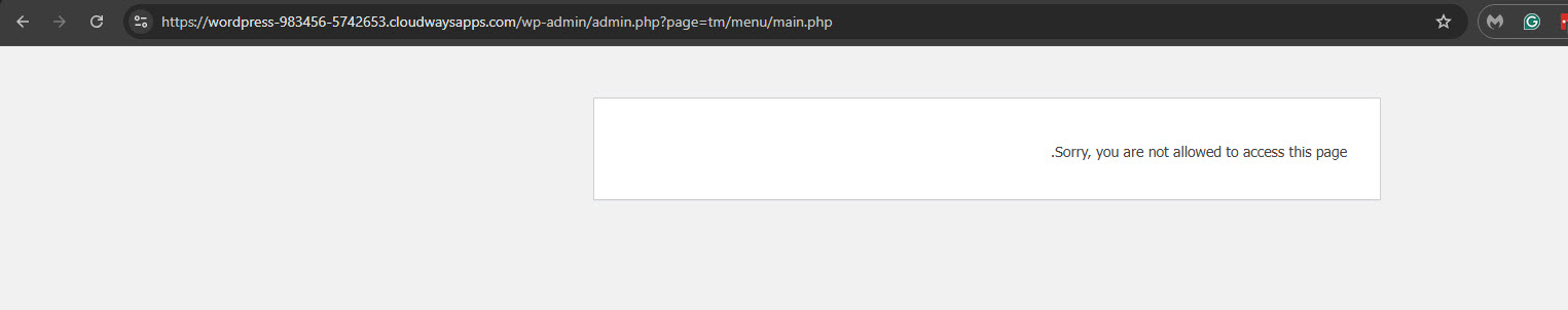

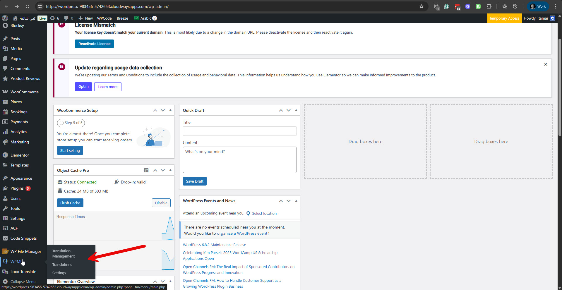

B. In the backend, I see only three menu items under WPML. Please see the attached screenshot wpml-only-3.jpg. And when I try to access WPML -> Translation Management, I get this message: "Sorry, you are not allowed to access this page." Please see the attached screenshot, sorry-not-allowed.jpg. To toggle this problem, please proceed with the following.
We suspect a collision with another plugin might cause this problem. Please get your site into a minimum environment by deactivating the third-party plugins except WPML and Strings Translation. Then, please check if the problem persists. If it does not continue, start by activating the plugins individually and checking when the issue comes back, then report to me which plugin was the culprit.
Needless to say, if you know what is preventing users from accessing WPML's settings, please correct this.

1- ok en site
2- WPML menu is showing all submenu . May be the access given to you is limiting this even it is administrative access.
