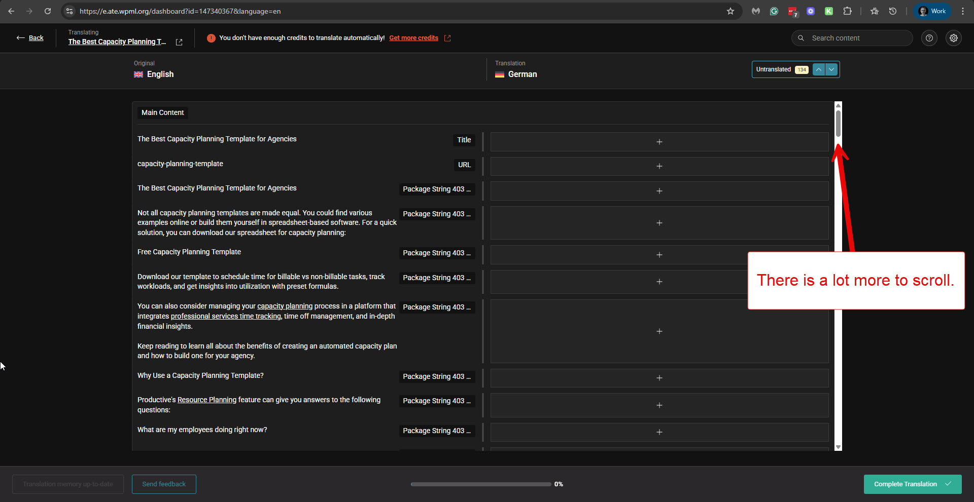

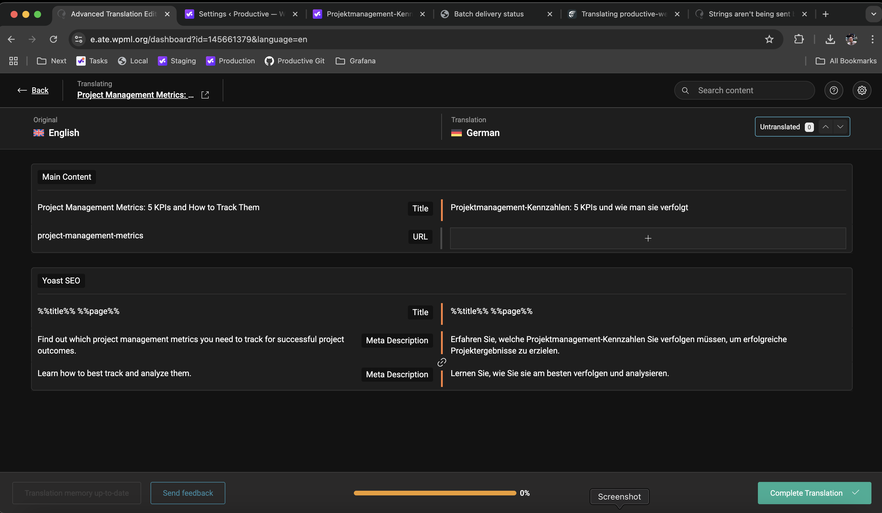

June 5, 2025 at 11:50 am #17110131
ivanB-21
Hi, we are still experiencing the same issue after trying the options you recommended on the Troubleshooting section of the plugin.
But the issue is changed and now it seems that no content is being sent to Crowdin, and it does not seem like a Crowdin issue, since only the post title and URL are being sent to translation, without the post content.
I am sending you the screenshot of the Advanced Translation Editor, where it is visible which content is marked for translation.

June 11, 2025 at 9:34 am #17124753
ivanB-21
Thank you for your feedback. We will sync the production website with the staging website as soon as we can.
However, the main issue we are encountering is the same in the production and on staging. And exact same strings that get picked up in Crodwin get also picked up in WPML Advanced Translation Editor.
I am using Advanced Translation Editor on staging since I do not have the Crowdin integration on staging.
But regardless of using Crowdin or using Advanced Translation Editor, the issue is the same, for some posts all the strings get picked up, and for some almost none.
As I mentioned before:
For example, for this two posts all strings get picked up:
And for this two, only post title and URL gets picked up:
But you can also check different posts on our blog hidden link and try to translate them and reproduce the issue - to see that some posts get all strings picked up and some just the title and URL.
What we cannot figure out is why this would happen if the blocks in the editor are exactly the same, just the text and images differ.
Regarding the other mentioned ticket: https://wpml.org/forums/topic/split-only-the-post-title-and-url-are-being-sent-to-translation-without-the-post-content/ it does also not make sense why it would get picked up by Advanced Translation Editor in some cases, and in others don't - if blocks are the same.
Please try to find out why do they sometimes get picked up by Advanced Translation Editor and sometimes don't (because it is the same issue with Crowdin), as I am confident finding the solution to this will solve the issue.

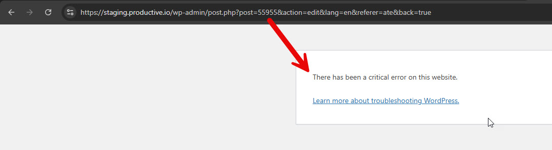

While checking hidden link and attempting to translate it with the Advanced Translation Editor, I encountered a fatal error upon returning to the editing screen. Please see the attached screenshot. We need to check things in a more optimal and operational environment. Please synchronize everything with the production site and ensure that all updates are applied. Please let us know when this is done.
If needed, please allow me to take a copy of your site. For this, I must install a plugin like Duplicator or All In One Migration. Please let me know if you agree.

June 16, 2025 at 11:17 am #17138327
ivanB-21
Ok, I see the error in BugSnag that happened while you were testing.
We did not have this issue while using translation editor, so not sure what happened, but as I can see the site is working fine, and translation editor also, besides picking up strings on mentioned posts.

June 16, 2025 at 7:19 pm #17140213
Itamar
WPML Supporter since 02/2016
Languages: Hebrew (עברית )
The error indicates that your theme is the cause of the problem.
I'm enabling a private message for the following reply, so when you are ready, you can share access to the staging site with me.

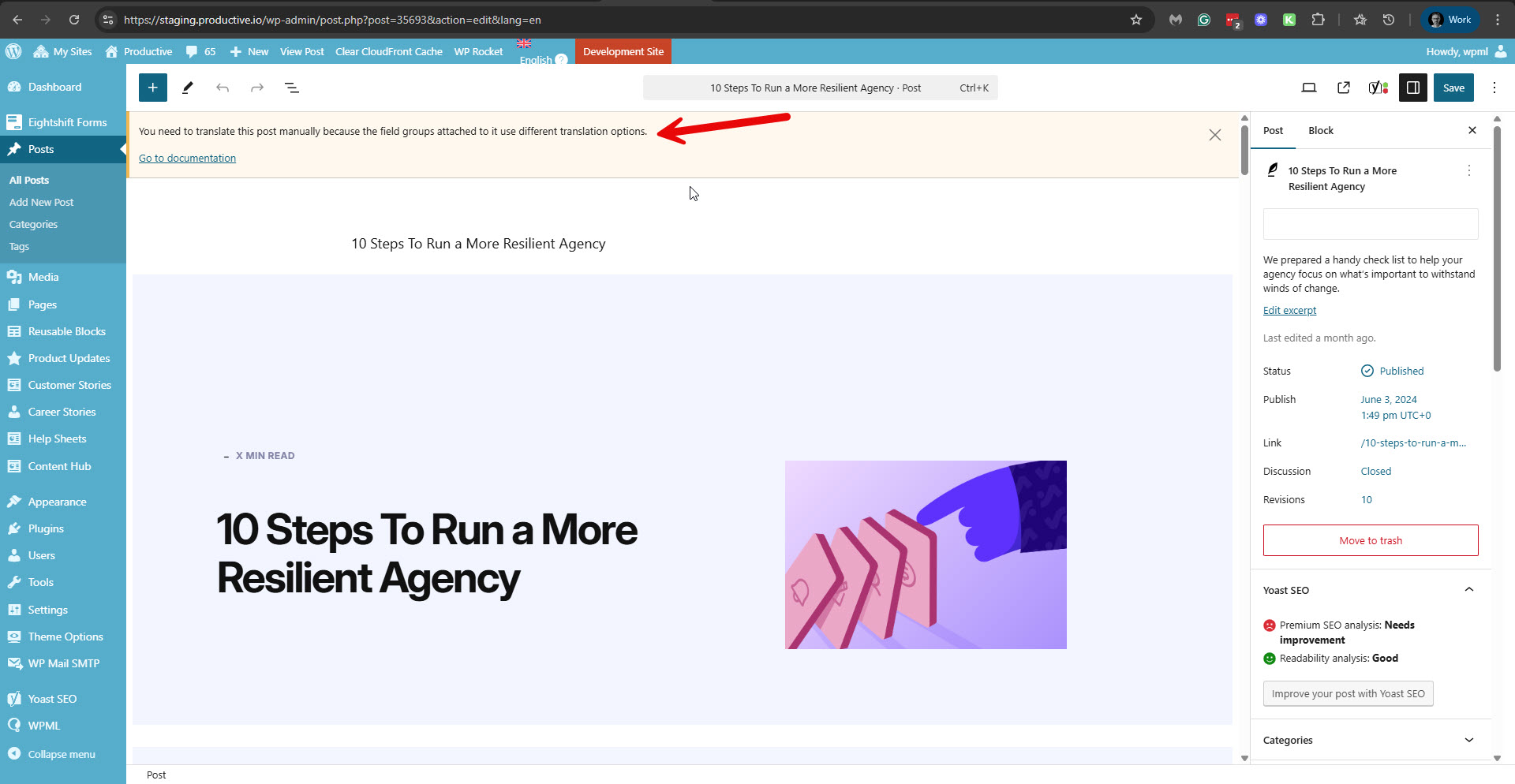

June 23, 2025 at 5:30 pm #17162087
Itamar
Hi, Davorin.
With this example you gave, I'm not seeing the problem.
I edit this page here:
And clicking the gear icon to get the Advanced Translation Editor here:
And I can see all, or at least most, of the content that needs translation. I'm not only seeing the title and URL. Please see the attached screenshot a-lot-of-content-to-translate.jpg.
I do see less content with this post:
However, upon editing both of those posts, I see the following message.
You need to translate this post manually because the field groups attached to it use different translation options.
Please see the attached screenshot manual-translate.jpg. Please refer to our guide on manual translation here:
Further findings I discovered.
I also wonder if the other missing content may come from different post types, such as Reusable Blocks, Customer Stories, and Career Stories. Please check that.
The message I mentioned above comes from our Advanced Multilingual. I tried to check ACF's field groups, but strangely, there is no admin menu to edit the field groups. I assume that the theme and the plugin you use by eightshift-boilerplate customize the use of ACF.
I want to restate that the eightshift-boilerplate theme and plugin are not compatible with WPML. They are also unknown to us. I have not found any other report about it in our forum or internal documentation. Currently, it appears that you are our only client using this theme and plugin. To set expectations, I must say that we might not be able to support it.
In conclusion, I'd say that you need to translate the post created with the eightshift-boilerplate system manually, as explained in the guide I shared with you. Hopefully this should work for yoy. However, please note that it will not enable you to translate the site manually. In WPML -> Translation Management -> Translation Jobs, you would need to delete any in-progress translations.
