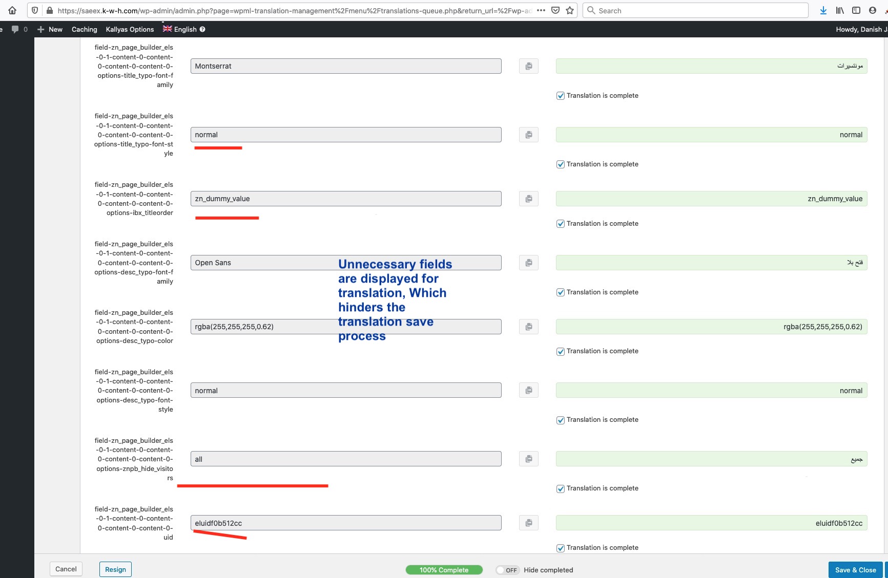

We did increased max vars variable the translation shows 100% complete but when i try to save or save & close its loading and doing nothing for about 10 to 15 minutes.
I think plugin has some issues with save translations.

I have escalated the case to the compatibility developers, As the content created using zion builder is sending some fields that are not supposed to be translated using WPML editor there are a lot of fields coming from the builder which causes a lot of load on the server and hinders the save process and eventually fails to save the translations. In my local this works just because i had setup the environment to allow huge process which will not cause any timeout issue.
Basically this is a compatibility issue with ZIon builder, we are not sure how the builder is sending the translation to WPML editor as this sends all unnecessary fields to translation. Though the theme is compatible with WPML we have no idea when the builder added to the theme and I could not see any internal records for compatibility tests.
I would also suggest checking this with the theme support if they have any solution for this as i can see the Zion builder is not tested with WPML yet, May be they are maintaining the compatibility code for the page builder themselves which we are not aware of.
As of now i could conclude pages with complex layouts using Zion builder may have issue with translations done with WPML editor, The recommendation is to use Manual translations as mentioned in this documentation https://wpml.org/documentation/translating-your-contents/using-different-translation-editors-for-different-pages/
