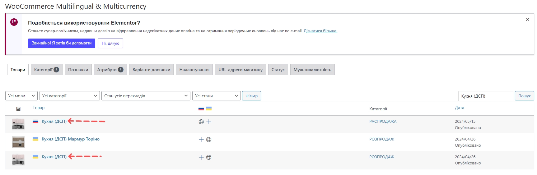

I did the following test: I exported the default language products, took the first two, translated them, and imported them using the same import tools. Then run WPML Export and Import. After the import, the products are not connected.
How do we import correctly so that the products are linked together?

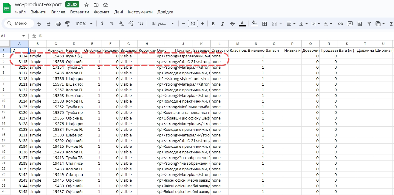

I did the following test: I exported the default language products, took the first two, translated them and imported them with the same import tools.
Then run WPML Export and Import. Final attached - products are not connected
How to import correctly so that the products are linked together?

I recorded a video of the process:
I shortened the video process by preparing the export and import files

You didn't prepare the spreadsheet correctly. Watching the video, here is what I spotted:
  • In your spreadsheet, the must-have WPML Export and Import columns titles include the word "Мета". However, this is wrong. You should only have the following as titles.
    • _wpml_import_language_code
    • _wpml_import_source_language_code
    • _wpml_import_translation_group
  • In your spreadsheet the _wpml_import_translation_group is missing. The original products and their translations will not be connected without this column.

    Hi and thanks for another video.
    The problem is with the value of the _wpml_import_translation_group column. In your case, the value is not the same. It is 8114 and 8115. It should the same value and it should be unique for this translation group. Please see the attached screenshot. If you have SKU for this product you can use it.

    May 16, 2024 at 7:12 pm #15636854
    Віктор Шапаренко
    There should be the same values here (_wpml_import_translation_group) if they were the same products for different translations, but these are the first two products from the export file for a second language version
    "_wpml_import_translation_group – Use this column for a unique value that links the default language content with its translations"
