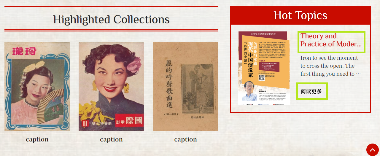

This is a staging site for one of our customers. When translating our site from Chinese to English, the text tends to be longer, affecting the layout. We need to translate it and adjust the layout accordingly to fit the English version. Additionally, not all the content has been fully migrated over.
The text tends to be longer when translating from Chinese to English, affecting the layout. Not all the content has been fully migrated over.

Layout issue due to translation: When translating from Chinese to English, the translated text can often be longer. While WPML assists in translating the content, any layout issues caused by the longer text will require manual adjustments. You may need to review and adjust the layout or modify the English translation and keep it short to ensure that the site remains visually appealing and functional.

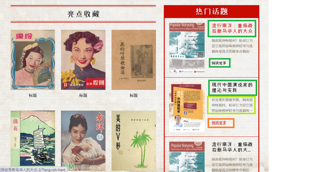

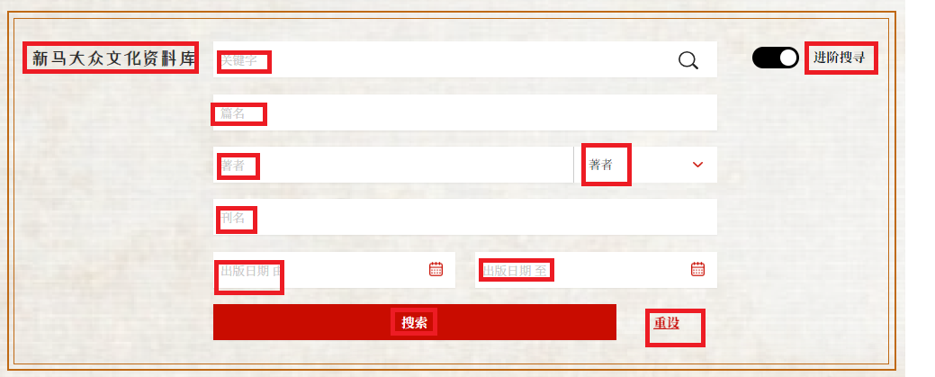

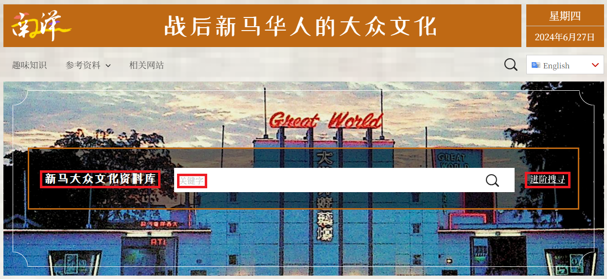

1. We don't want to change the search engine to Google, instead what we want is without converting every post and pages to the language using auto translation or manual process, need only the frontend translation which works like google translator. When the user changes the language to any language it will simply translate that page's every part including page contents, menus and footer everything whatever present in that page to selected language, just like how the google translator browser extension works.
2. As you can see in the attached snapshots, we have already converted the Home page, but we are not able to convert the static contents as highlighted in the screenshot. For reference you can go through the below links and attached snapshot as we have converted the home page already but it's not converting the dynamic parts like search section which we have developed through short code. show in snapshot. Also string translation feature does not allow us to add our custom string. Also please guide us to use this feature and how we can use it throughout the website which we have used as short code.

1) Frontend Translation Only: With WPML, the content must be translated first to be displayed in the frontend. Unfortunately, it is not possible to show automatically translated content without first translating it in the backend. WPML does not have this feature yet.
2) Translating the Static strings: I have reviewed the screenshot and found that most of the highlighted texts are static strings. These static strings can be easily translated by going to WPML > String Translation, provided the text has the necessary translation support. If the highlighted texts are added through custom code, ensure they are wrapped in the `gettext()` function with the correct text domain. Please refer to this guide to learn more about adding translation support for texts.
If these texts are added by a theme or plugin and have translation support, please try the following steps:
1. Go to WPML > Theme and Plugins Localization.
2. Select the theme or plugins to which the texts belong.
3. Click the "Scan" button and wait until the scan is completed.
4. Once done, go to WPML > String Translation and search for the text.
5. If the text appears in the results, add the translation by clicking the "+" icon.
However, if you don't see the text in the results, you may check in the admin screen by following this guide: https://wpml.org/documentation/getting-started-guide/string-translation/finding-strings-that-dont-appear-on-the-string-translation-page/#translate-admin-and-settings-strings
I hope the information above will help you to translate the Strings.
3. Free Credits: The 2,000 credits will not appear as a deposit. Instead, the first 2,000 credits you use each month with the pay-as-you-go plan will be automatically free of charge. To see this in action, remove the existing credits from your site by following this guide, and then try translating something automatically.
