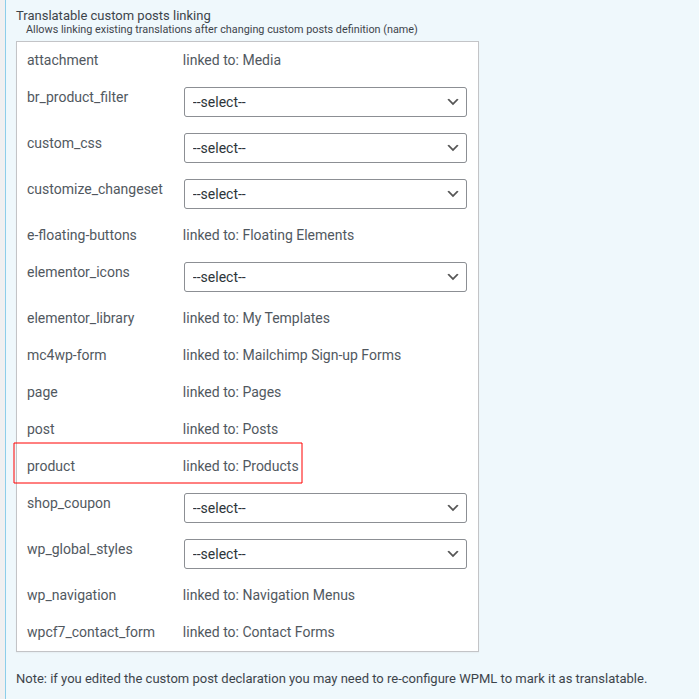

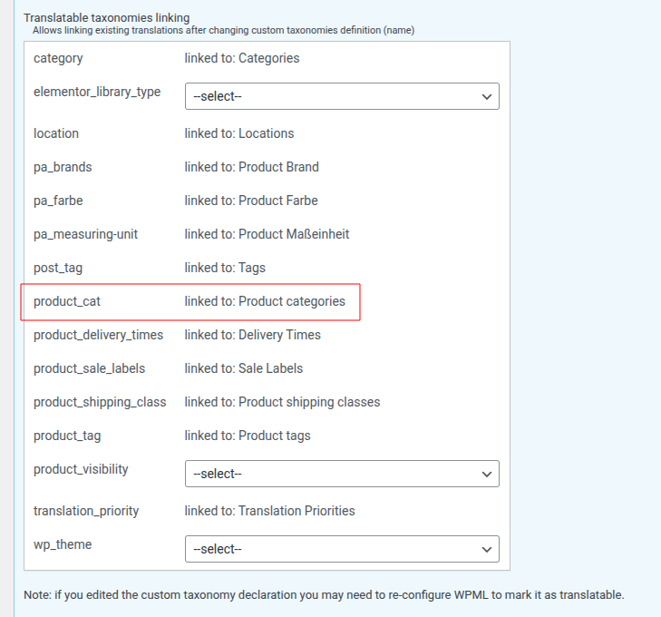

anna-mariaA-2
Already selected :
product linked to: Products
product_cat linked to: Product categories
Kindly guide if there are any additional settings I should review.
April 3, 2026 at 2:07 pm #17948057
Alejandro
WPML Supporter since 01/2018
What you're showing there has nothing to do with your workflow.
Unless you trigger the "save_post" hook from WordPress, the content you change in the original language will not be synced on the translations (that means you'd need to create a snippet for it, and custom coding is outside the scope of our support).
The problem here has to do with your workflow, would you care to explain how it works to see if there's something we can do to help here?

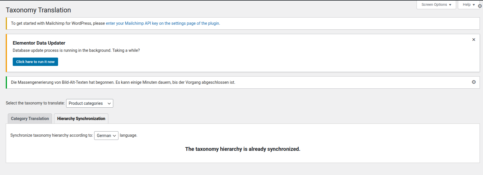

April 8, 2026 at 6:01 am #17955543
Dražen
Thank you for the detailed explanation.
To keep things clear and efficient, let’s first focus on the main issue you reported product categories not syncing correctly in English. Once we resolve that, we can continue with the other issues (menus, pages, etc.), as they may or may not be related.
As my colleague mentioned, since the categories are being imported via a 3rd-party plugin (Rentman), this behavior can be expected. WPML relies on standard WordPress hooks (like save_post) to sync translations, and if the import process bypasses those, synchronization won’t happen automatically.
To try to resolve the category issue, please follow these steps:
- Go to WPML → Taxonomy Translation
- Select Product categories (product_cat)
- Scroll to the bottom of the page
- Click “Synchronize product categories”
This will attempt to align the taxonomy terms across languages.
Let me know how it goes, and based on your results, we can guide you further or explore alternative approaches if needed.

April 13, 2026 at 11:37 am #17965657
anna-mariaA-2
It shows this:
"We detected that the product_type field was set incorrectly for some product translations. This happened because the product_type taxonomy was translated. You can fix this in the WPML Multilingual & Multicurrency for WooCommerce troubleshooting page."
Is it connected to 'WPML Multilingual & Multicurrency for WooCommerce' plugin? Need to configured?
