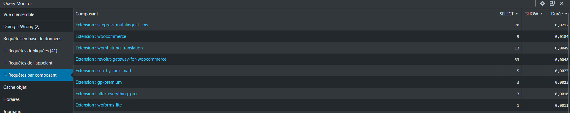

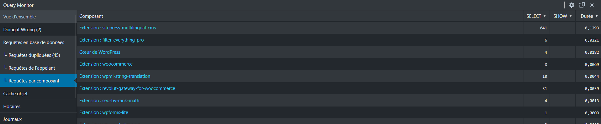

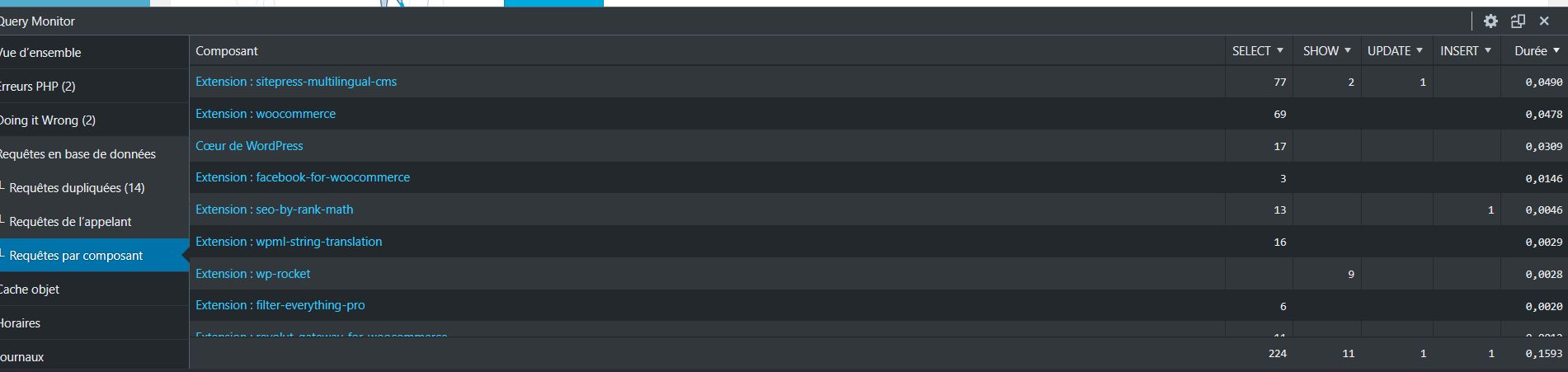

July 24, 2025 at 5:31 pm #17268857
kisa
Thank you for your reply.
We were able to make some adjustments and installed the Index WP MySQL For Speed plugin, as suggested in the link you provided.
Unfortunately, the issue remains the same — we are still experiencing a very high number of queries and server overload, especially on listing and product pages.
As requested, please find attached aQuery Monitor screenshots from the back-end for your review.
The attached screenshot is a capture from the backend using Query Monitor.
Please note that the screenshots we shared in our first message were from the frontend, and the number of queries there is actually even higher.
At this stage, we are planning to set up a staging site where we can safely test things further by disabling plugins one by one, as recommended.
Let us know if there’s anything else we can do to further optimize WPML’s performance or reduce unnecessary queries.
