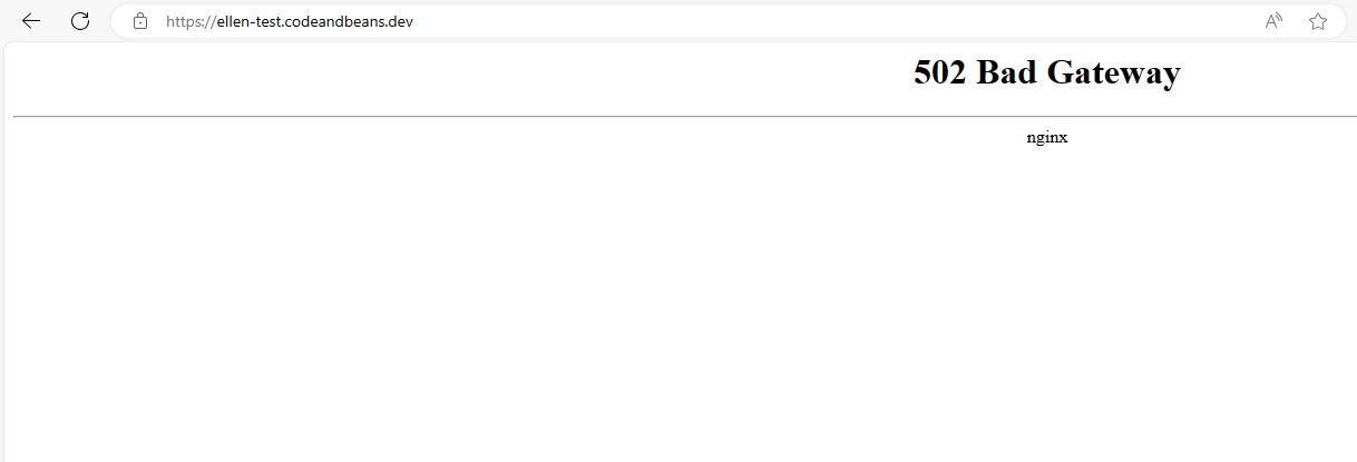

I have a few problems that hold me back from continuing to investigate this issue.
1. I can access your dev site, but I cannot access it with FTP. I get:
Error:	Could not connect to server
2. I'm getting a 502 Bad Gateway error on the front end of your site. Please see the attached screenshot.
3. Your site is not in a minimum environment. We need to check if this issue persists when only WPML and its add-ons and WooCommerce (without its add-ons) are active. All the rest of the plugins need to be deactivated.Can you please proceed with this?

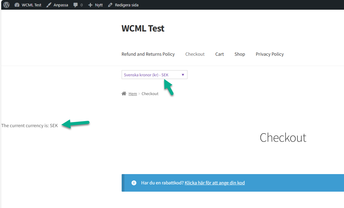

Hi, and thanks for the copy of your site and video. It really helped!
I'm unsure what went wrong in the communication between you and my colleague who first helped you. For some reason, the history of the chat is gone, and I can't see it. In the ticket summary, my colleague mentioned that he provided the workaround for you, but you said it did not work. But when I examined your code (header.php), you inserted it without the workaround. It is like this:
<?php $current_currency = apply_filters('wcml_price_currency', NULL ); ?>
<?php echo "The current currency is: " . $current_currency; ?>
Using NULL will not work. When I correct it as suggested, it works:
<?php $current_currency = apply_filters('wcml_price_currency', get_woocommerce_currency() ); ?>
I put your site on our Cloudways server. You can check that it works here.
Please also see the attached screenshot.
You should also apply the code on your live site.
Please let me know how it goes.
