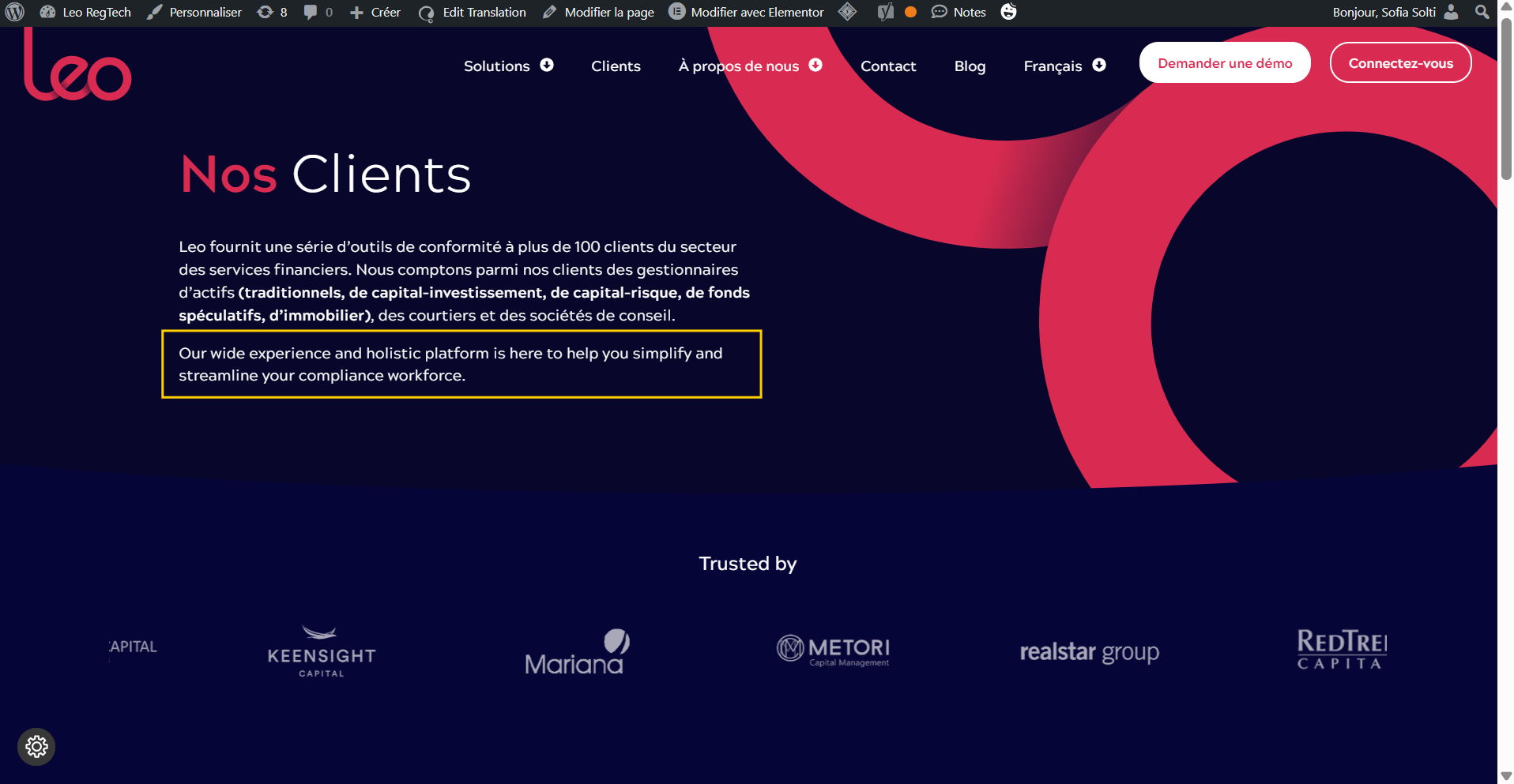

I only removed a sentence from the Clients page (hero section - top) in the FR version.
So I didn't changed anything in the EN version.
But this language change triggers even if we do not change anything in the website.
July 17, 2025 at 9:36 am #17244726
jeromeL-18
There's the photo.
the sentence in the yellow square is what I tried to removed, and now is back there
July 17, 2025 at 4:01 pm #17247107
WPML Supporter since 08/2022
Thanks for your reply. I've restored the English language homepage for you here: hidden link
The page is now correctly set as the primary language.

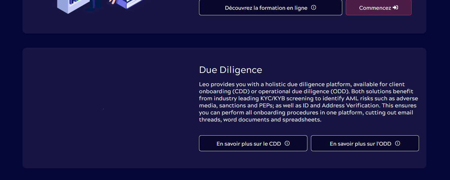

What I want to know is if the Advanced Translation Editor is doing automated translation or no? As well, what happens if we change it back to manual?
What's the difference between them?
We want to be able to translate what we need to but edit the pages as well, as not all the solutions we offer in the UK are the same ones in FR. You can see as an example, the FR home page has still a solution in EN but because we don't need it in France.

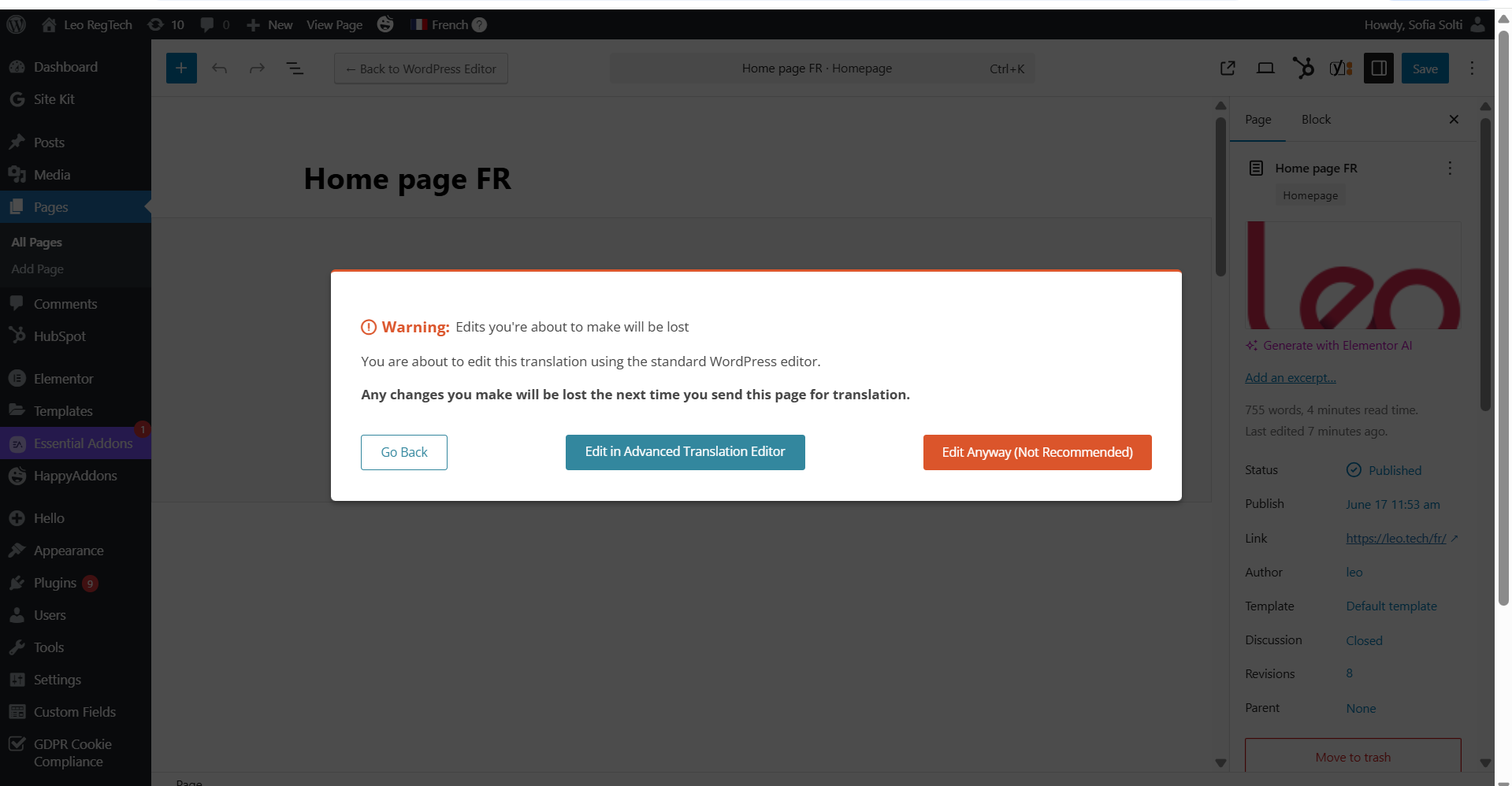

Yes this is a little bit complicated for me as we are using elementor, which means that what's described in the knowledge base article you sent me is not really that helpful.
And for what you say I think all page have been edited with the advance translator, and not all of them are the same.
So If I change all to manual that means that all the FR pages will turn to EN? but I can just edit edit the text in elementor and translate it myself?
See warning message when trying to edit a translated page.
July 23, 2025 at 4:18 pm #17264843
Thanks for your reply. Please refer to this screen recording that shows you how to manually edit the translated page hidden link . Keep in mind that I've switched it to manual translation for you and if you switch it back to Advanced Translation Editor, your manual changes will be overwritten.

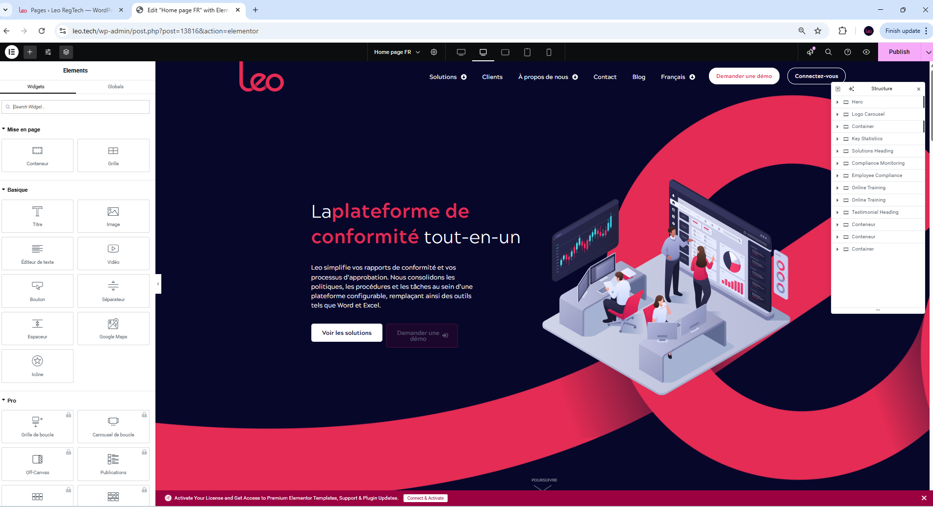

July 24, 2025 at 9:24 am #17266634
jeromeL-18
Hi Kor,
Hope you are well.

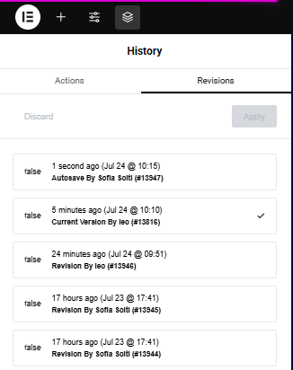

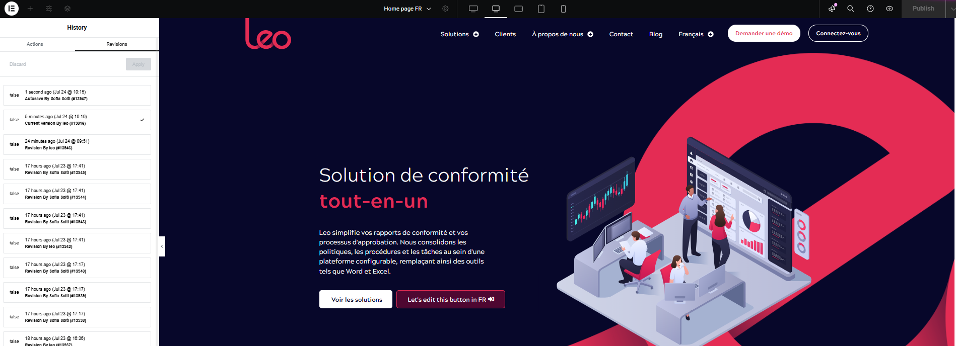

This morning the website was working but something happened with the FR home page. Is still in FR but all my changes from yesterday got overwritten.
As you can see on one of the images is says Le platform... which is how it was yesterday until I change it.
If you see the images with the revisions it says that 'leo' made changes or something today which it makes no sense as I am the only one logged in.
And if i click on my revision 17hs ago it goes back to how I left it yesterday with all the changes.
Can you have a look please?
July 24, 2025 at 9:35 am #17266756
Thanks for your reply. I've checked and this "leo" user last login is on February 6, 2025 10:19 as shown here hidden link . Based on the Elementor revision history, this user reverted the translation. I'm also confused here and this isn't a known issue.
Could you backup and remove this Leo user? Then, forward all "leo's" posts to your account at sofia.solti@lavenpartners.com
