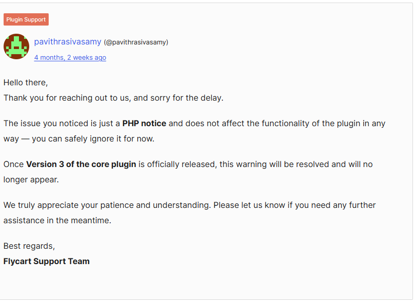

January 27, 2026 at 7:22 pm #17768799
aljazP-4
Regarding the first two, the answer from discount rules is in the attachment.
Maybe it's better to first see what I can do about WooCommerce error, tomorrow I'll let you know what I managed to fix. Regarding the WP_CACHE_KEY_SALT error, can you please fix it for me like you did in the test.

January 28, 2026 at 3:11 am #17769294
The issue with loading textdomains was reported by us in the following errata about it:
https://wpml.org/errata/php-error-wp-6-7-notice-function-_load_textdomain_just_in_time-was-called/
The author of the plugin should solve this issue. It might not break the site, but it definitely should get solved.
